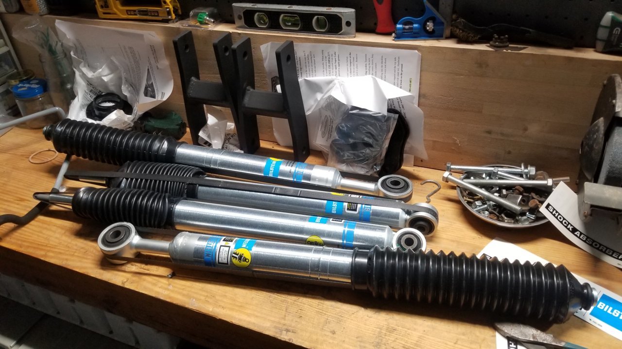

  16. Apr 29, 2020 at 3:25 PM
    42,473
    Fair warning.....I have the Pro Form Fab 1.5" shackles. Not installed yet. Was going to do my lift last month but the upper bolts for each shackle wouldn't line up!!! The jig must not have been aligned up properly when the shackles were welded up. Partly my fault. I've had these sitting around for months and it never occurred to me to check the fit. Bummer for me but a bigger bummer that Pro Form didn't verify bolt fitment either. I could get these shackles corrected but leery that integrity will be compromised. You get what you pay for. Going with Toytec shackles. Nuke proof. Can't go wrong.
    Lose the blocks. Eliminate potential axle wrap issues. Get AAL's and Toytec's nuke proof adjustable shackles. This combo was great on my 07 and should get you the look and ride you're going for. My 2 cents.

  22. May 1, 2020 at 4:59 AM
    42,473
    The shackles are way out of wack. The upper bolts can't be put in. The holes do not line up. If I would have checked them out when they arrived I could have returned them. The shackles are HD but do me no good as is. A coworker has a shop and is going to attempt to fix them this afternoon.

    That sucks maybe they sent you the wrong application I didn’t have any issues with mine hope you get them to work
  24. May 2, 2020 at 7:28 AM
    #24
    42,473
    They are the correct shackles, just slightly off enough so that the upper bolts can't be inserted without stripping the hell out of them. My friend is attempting to correct these this weekend. The alignment is isn't too far off.
