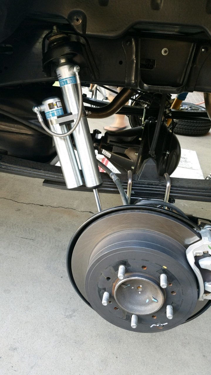

  2. Jul 29, 2019 at 7:03 PM

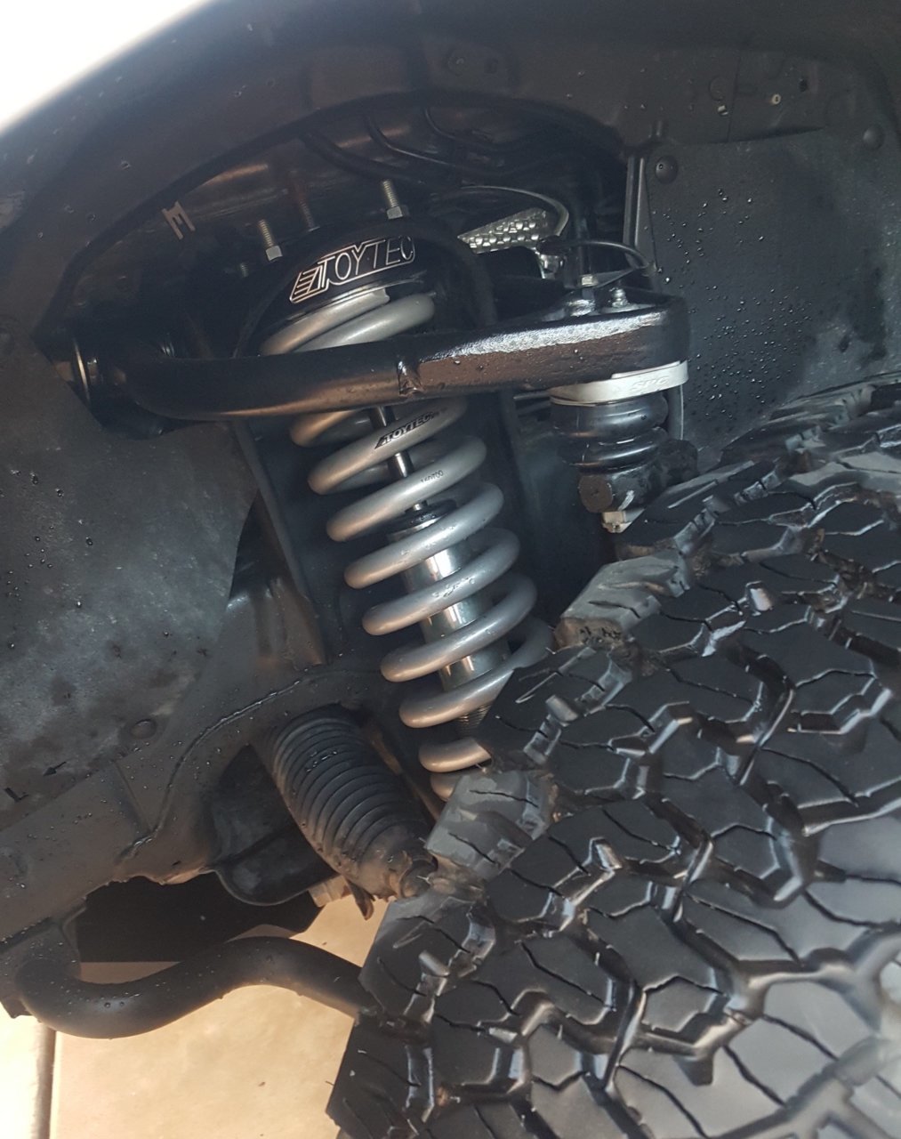

    toytec boss.jpg Here is a pic for ya.

  16. Jul 31, 2019 at 8:50 PM

  17. Jul 31, 2019 at 8:52 PM

    Oh. Hey. I stand corrected.
    UCAs are SPC.
    "D" setting, set all the way out. I haven't had an alignment yet, but my DIY camber is right where it needs to be, (according to my DIY measurements, which are usually within 0.1 degree from my shop measurements on my track car.). and the truck drives straight and true.

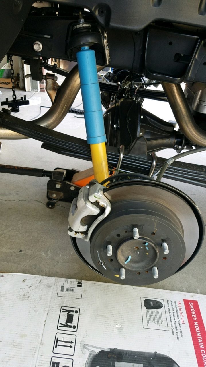

  25. Aug 20, 2019 at 4:05 PM
    #85
    Rica25
    Rica25 [OP] Got Bam? IG ......@TNDRA08
    Dec 6, 2017
    #11380
    5,554
    Ricardo
    Tulare
    So I ordered the 6112s and 5160 yesterday.....I just finished installing my uncles today in the morning same set up and also got him the +3 Coachbuilder.......when he picked up the truck today from my house he is going to go and pick up some 285 70 18 Nitto Terra grappler g2
