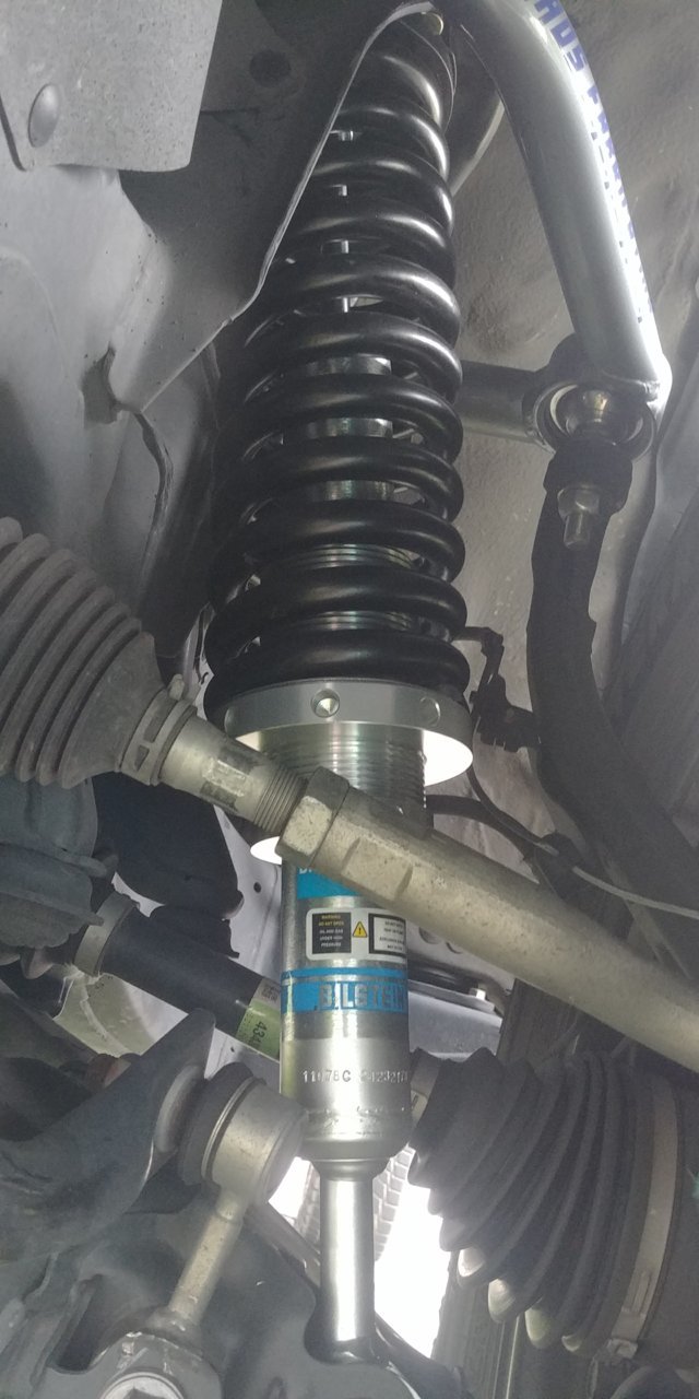

    6112/5160 is a terrific setup for the money. Had this installed on my ‘19 a few weeks ago. Set the shocks at the top clip and running Toytec shackles on the 1” setting which gave it a nice stance. I’m really loving the ride quality.

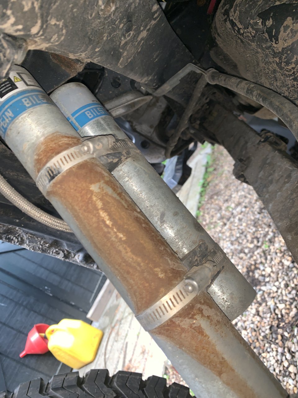

    I love the ride of the 6112 5160 pair, but I’ve had them on since November and the 5160s are rusting pretty badly around the clamp. Doesn’t effect the ride, just surprised this is happening. One Boston winter.

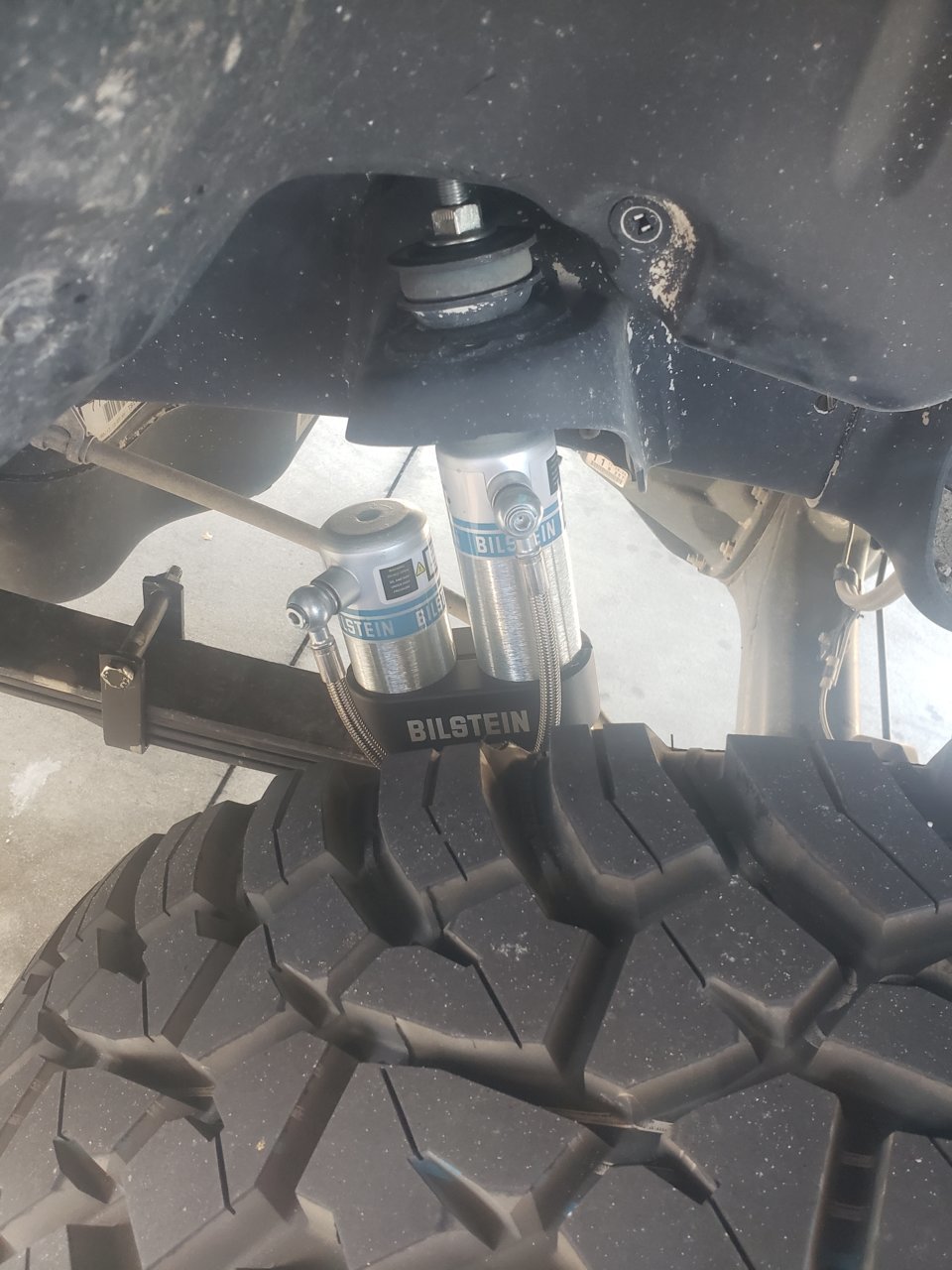

    20190726_174059.jpgDont forget about Fat Bobs coilover setup either. I wanted the 6112 setup aswell, but like others have said, they are often on backorder. That said, I chose Fat Bob's this time around but added the Bilsteins. Great ride & performance and not too expensive either. All comes down to what you wanna do.

    Did that clamp come with the shocks? It could be contributing to the rusting.

    The clamp did come with the shocks. And it seems to be the catalyst. Might need to take these apart, sand them, coat them and buy those ridiculously expensive aluminum holder things
