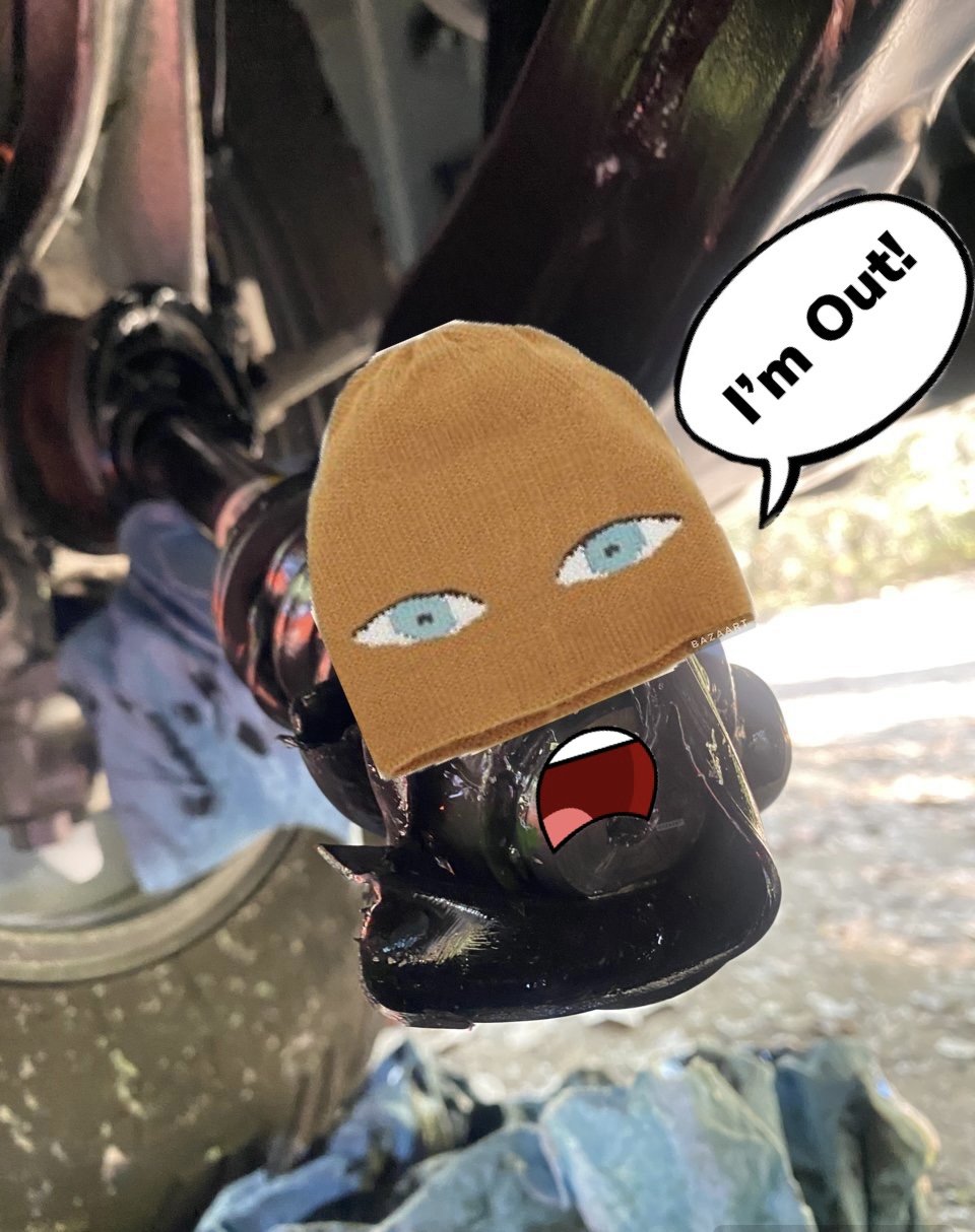

    Can't see it clearly, but is it just CV separated? If there's no damage done to CV, just clean, grease and reassemble it back using a new CV boot.

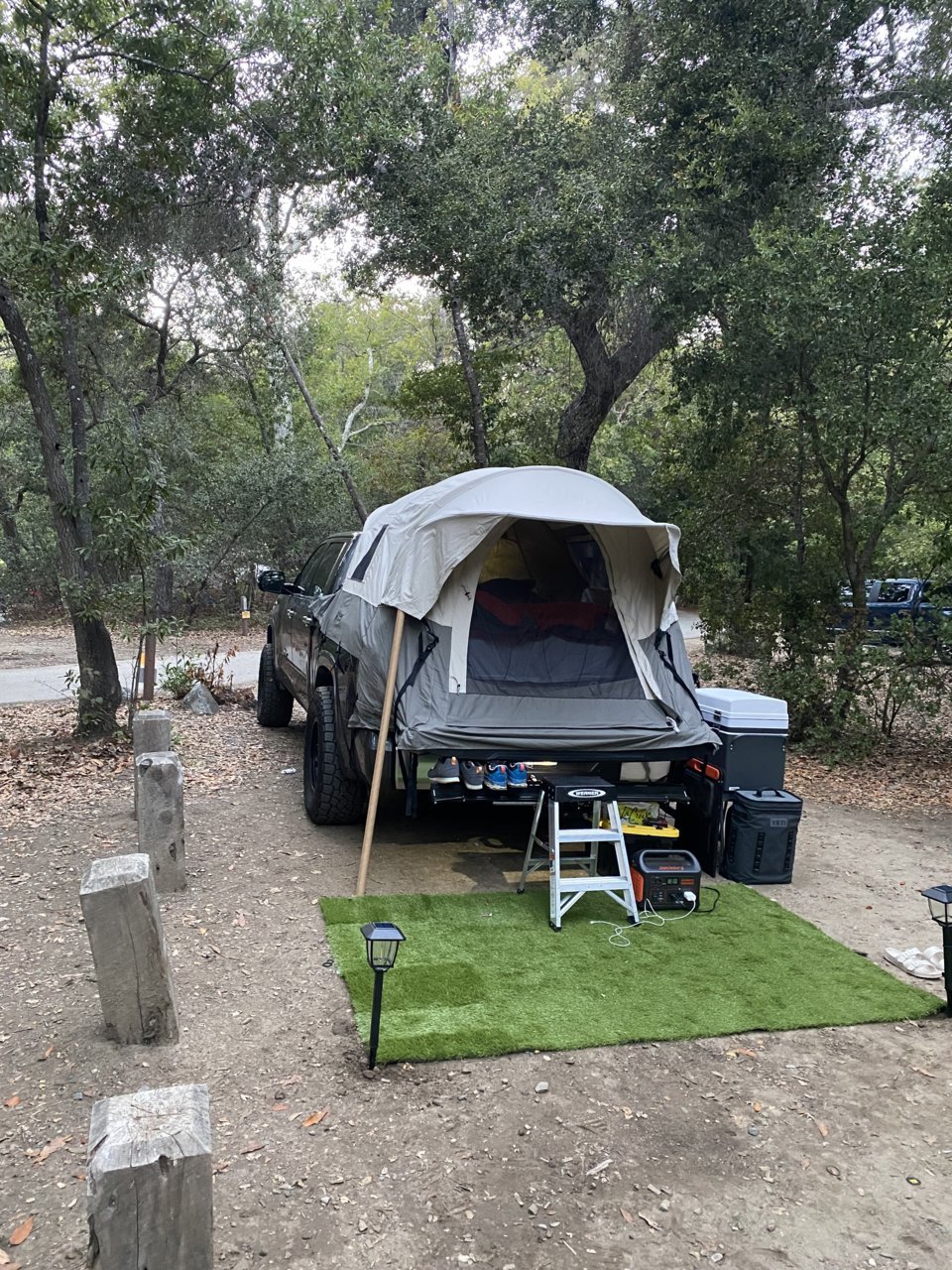

    so you were backing into this spot and it broke?
    if so, there is 100% no need to be in 4wd from what I see in the photo, a car wouldn't get stuck there.
    sorry if Im missing something.

    Is this where it happened? Wheels should skid on dirt

    Thats dry dirt right off the pavement. lol

    Torsional overload.
    Either stick slip or a hard turn ( wheel lock and ps pump begging for mercy with bypass hissing)... combined with added stress from lift...
    You need to check or replace the other axle while you are at it.
