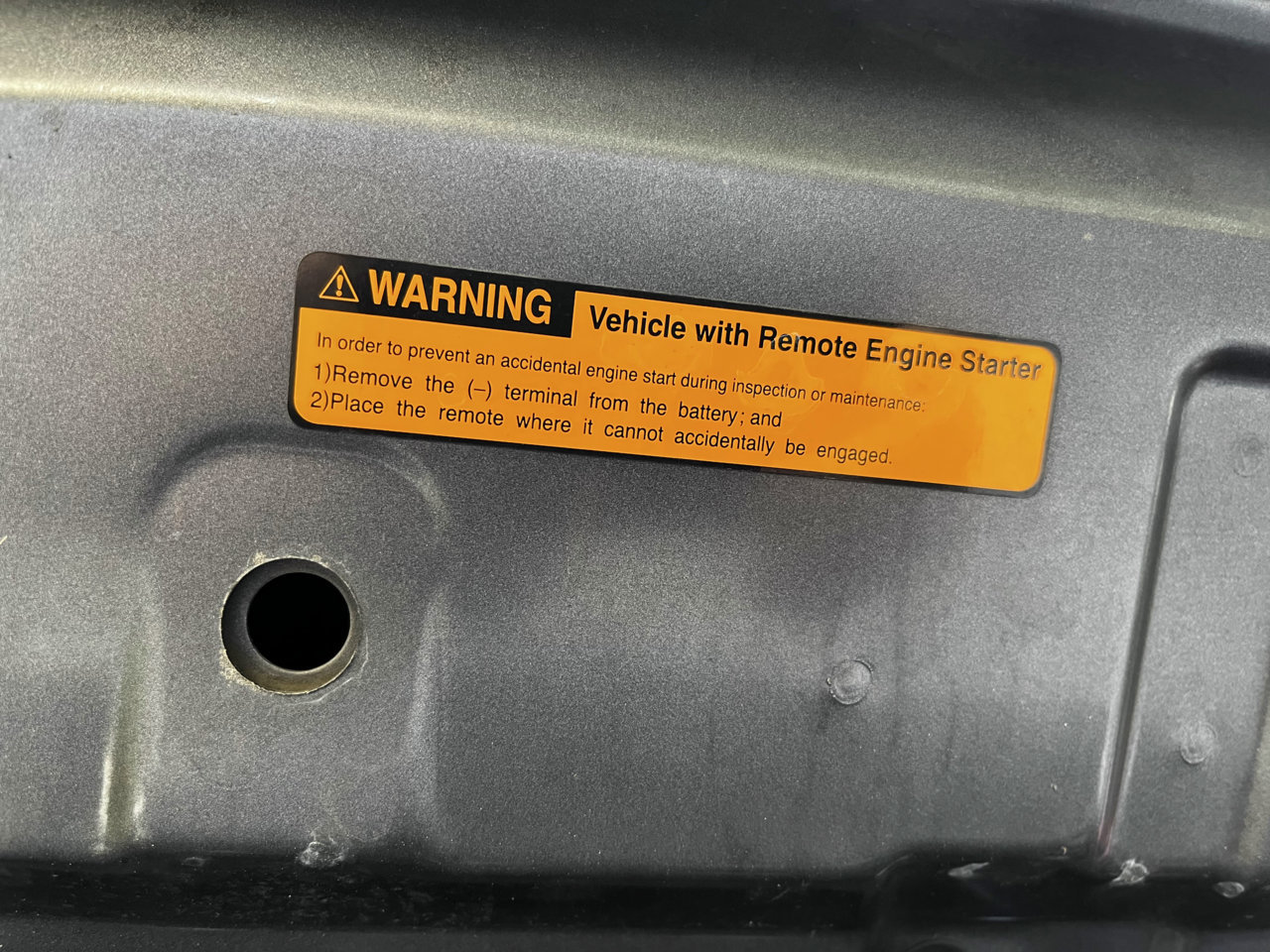

    New to me 2016 Platinum. Does this sticker under the hood mean I have remote start? Tried the FOB trick but no start. Could mine be after market? Also I did not get a Toyota FOB with the truck. Dealer sent me to a partner who handles all their fobs. Would this make a difference?

    Kept trying fob trick and gogt it to start one time butu cannot repeat. Any ideas? Thanks.

    my ‘20 sr5 has it. You have to be fairly close with the remote though.

    Thanks all... had a couple more successes yesterday... starrting to get the hang of fit. Cool feature...
