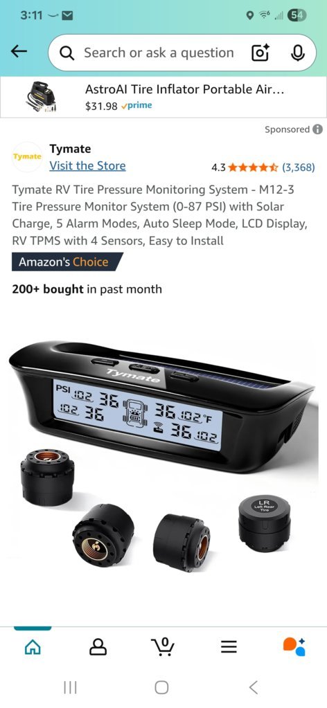

    I use this one and it seems to work really well. I normally take the monitor out of the truck and bring it with me when I check camper tire pressure. Within about 3 seconds after removing sensor from valve stem I get a zero pressure alert. Furthermore, after a long downhill decent to our normal campsite with numerous brake applications I will get a 100 degree over temperature warning about 15-30 minutes after we park wich is normal for brake heating after last brake application.Screenshot_20250517_151137_Amazon Shopping.jpg

    This is what I have but I bought the repeater. Having the temperature does little good since it's measuring more surrounding air temperature than actual tire temps.

    That’s the same manufacturer as the one I posted. If you look close you can see the sensors are the same. I didn’t want the solar power one but wanted 12V to the monitor constantly through the 12V socket.

    Do you have a link to the compatible repeater?

    Ya, that's why I got the heat gun now. When I repacked the wheel bearings and adjusted the brakes I got a little aggressive on the left side star clicks. Within a few minutes of parking the left side over temperature buzzer went off and was physically hotter than the right.

    Ours came with repeater but Amazon sells repeater separately.
    Another pro tip from an amateur ... if you store the unused sensors in camper, remove the batteries. Kind of disconcerting when a zero pressure alarm goes off while driving then figuring out that it's a sensor not in use.Screenshot_20250517_171108_Amazon Shopping.jpg
