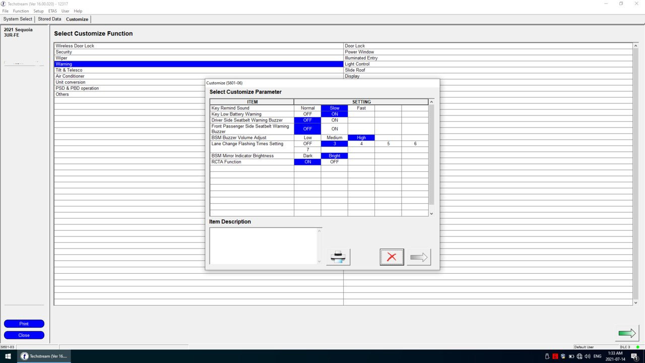

    I was so excited today to plug in my new MiniVCI dongle and connect it to TechStream. I needed to configure a few things, but this one was at the top of my list. I absolutely hate the car beeping for no reason. Decades of experience with crappy cars cause me extreme stress whenever I hear that beep.
    But even though it looks like I found the right two options and turned them both to OFF, it steel beeps. The other (unrelated) options I changed were changed successfully.
    Am I missing something? Is it even worth trying a different piece of software or should I assume that on my 2021 Sequoia these options just don't work?
