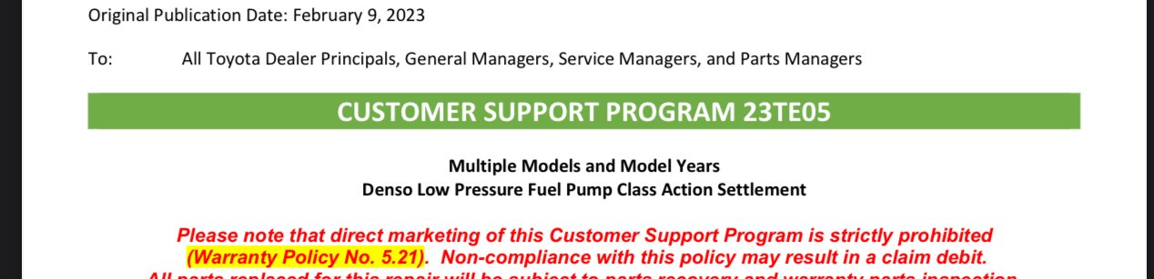

    Y’all have any recommendations on who to call at Toyota to see if I can fight to at least get this covered under the TSB?

    nhw544[OP] likes this.

    I’m with you, I’m going to look into a scan tool that can reset the ethanol percentages for if this happens again.
    By that link, Toyota should then cover this, right?

    That’s the way I read it. 15 years unlimited mileage and your vehicle is in the covered vehicles.

    You’ll probably need to cite the specific program…

    It’s nice how Toyota puts in red and bold that service providers are prohibited from letting customers know their fuel pump is subject to fail and covered under an extended warranty program. :rolleyes:

    Spoke with Sparks and Toyota Corporate and got nowhere. Apparently my vin isn’t listed in the specific Customer Support Program and they will not cover it. I asked to speak to someone higher and they would not, they just connected me with Sparks again. Extremely frustrating that a known issue that should be a recall isn’t being covered. They told me the best they could do is have me save my receipt so if Toyota adds my truck to the program they can reimburse me then. I’ve been a loyal Toyota owner for 2 decades and this is really leaving a bad taste in my mouth with them.
