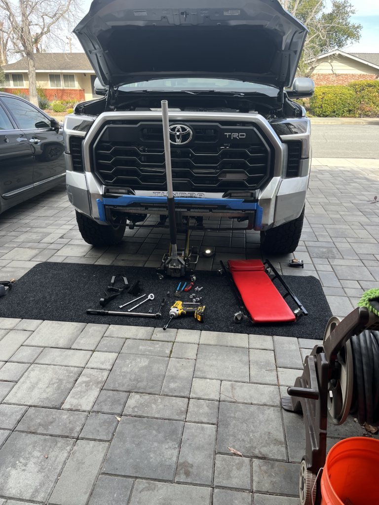

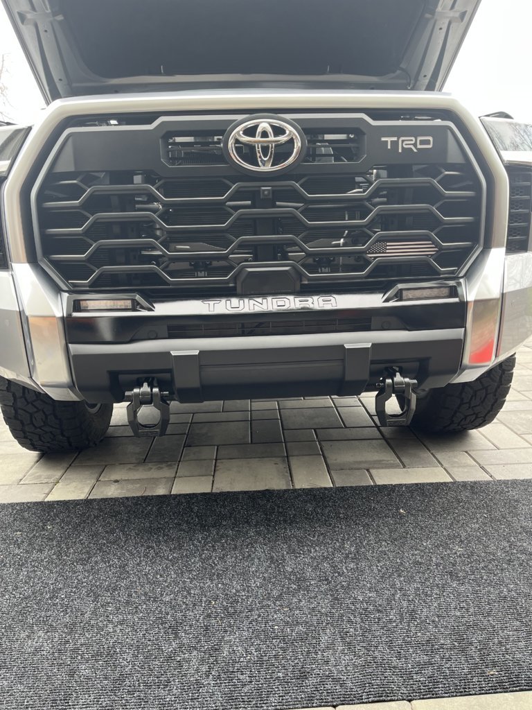

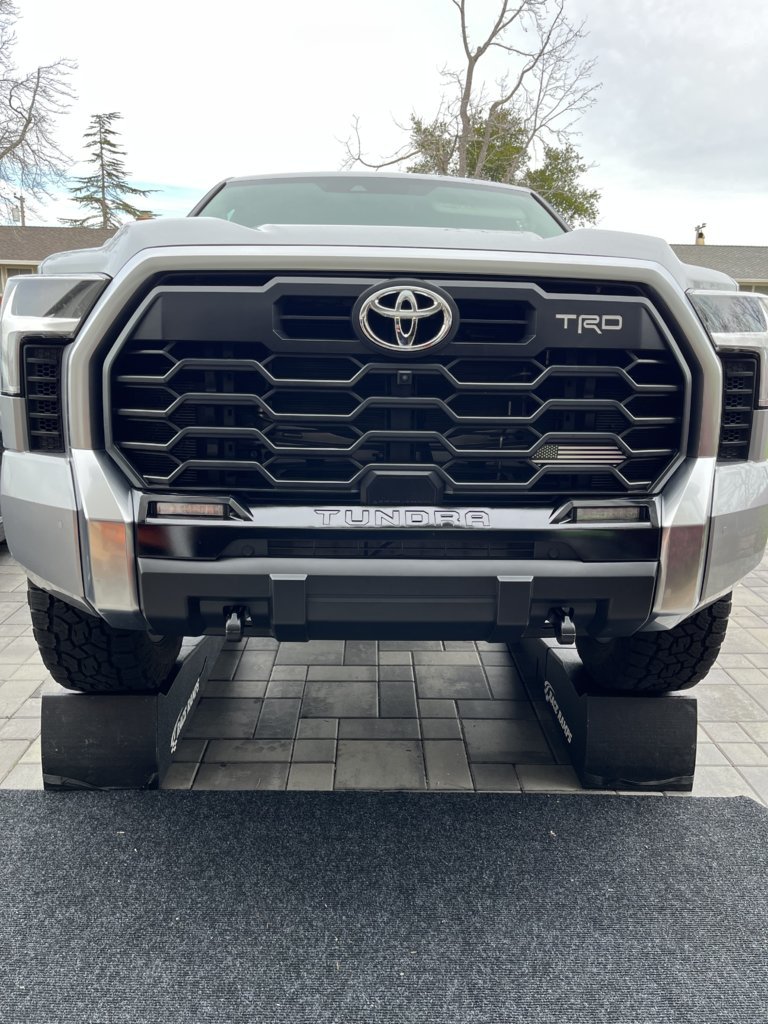

    I decided to give the Toyota OEM Tow Hooks a go today. I read through this thread and it looked totally doable which it was. We did NOT remove the entire front end which led to having to trim off the 2 side tabs of the bumper cover that go under the mustache trim, but with 19 other clips it’s not going to miss 2 of them.
    Took about an hour total with the help of my Race Ramps.
    I need to find some smaller shackles, as these TRD ones are WAY too big. I bought the “Reno” ones another member here had posted but could not get the silver clevis pin through on the driver’s side hook. The pin hit the protrusion on the new bumper cover and would not go through unless flip 180 which would look ridiculous compared to the other side. https://www.amazon.com/dp/B0C6QB8P3V?ref=ppx_yo2ov_dt_b_fed_asin_title&th=1

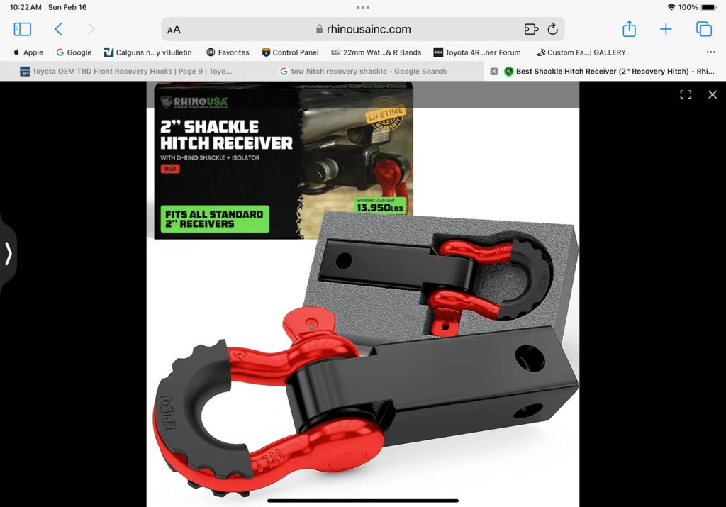

    For the rear I have a tow hitch pull like this.
    https://www.rhinousainc.com/products/shackle-hitch-receiver?variant=41958504562879&nbt=nb:adwords:x:17354061039::&nb_adtype=pla_with_promotion&nb_kwd=&nb_ti=&nb_mi=324626948&nb_pc=online&nb_pi=41958504562879&nb_ppi=&nb_placement=&nb_li_ms=&nb_lp_ms=&nb_fii=&nb_ap=&nb_mt=&adgroupid=&gad_source=1&gbraid=0AAAAADSNCr2Oc38SLZSxQthD71az44C_W&gclid=CjwKCAiAtsa9BhAKEiwAUZAszdbjID4fwuQDlk3hjticAPqsox2zdis4ayGK_cwRCZQwHjda-y0WARoCU0cQAvD_BwE

    PSA if it makes any difference to people: Don't be fooled by the USA in the name. Made in China.
    I own several bits by Rhino USA. Nothing wrong with their stuff. Just don't pay extra for the name thinking you're getting a made in USA product.
    EXACT duplicates on AMZ under multiple different brand names, all about $15 less.
