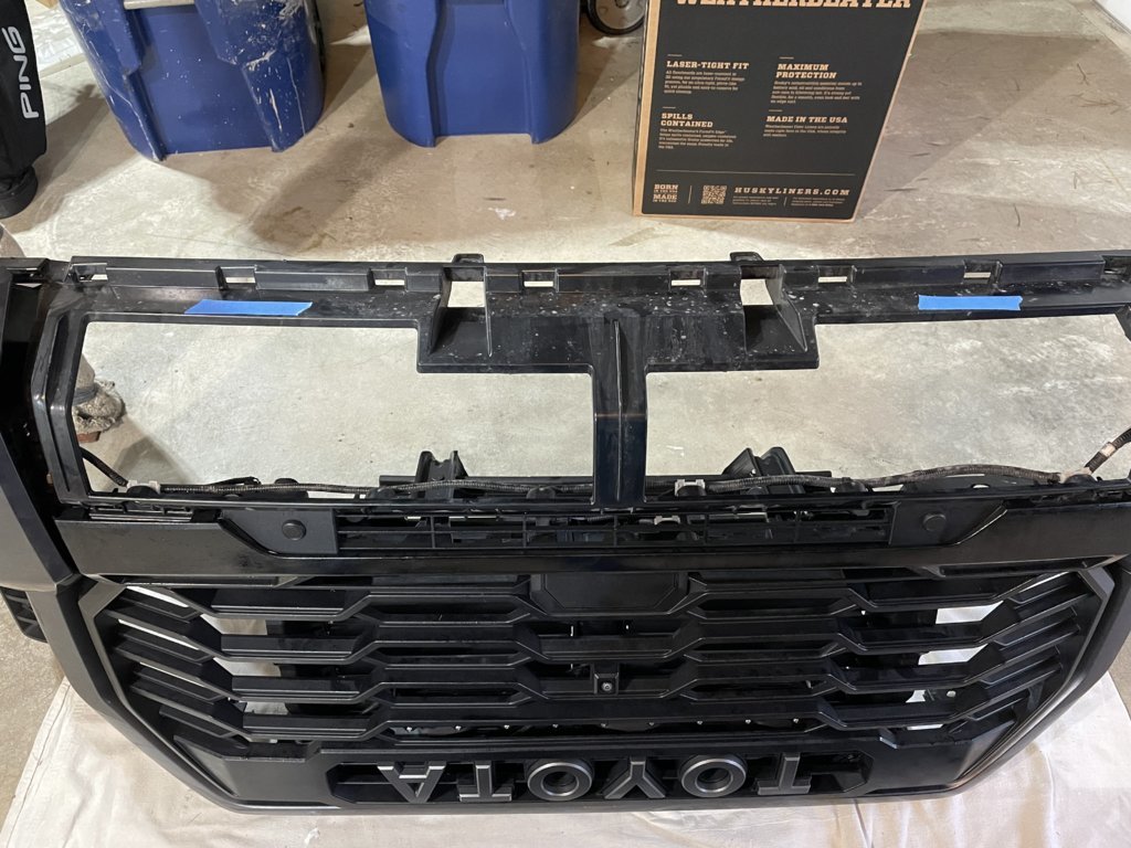

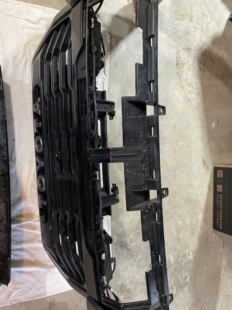

  4. Dec 14, 2024 at 3:05 PM
    #184
    KClav
    KClav MGM Limited
    Dec 28, 2021
    #72331
    116
    2022 Tundra Limited CM MGM TRD OR
    I cut where the blue tape is and it was more than enough. See before and after pics
