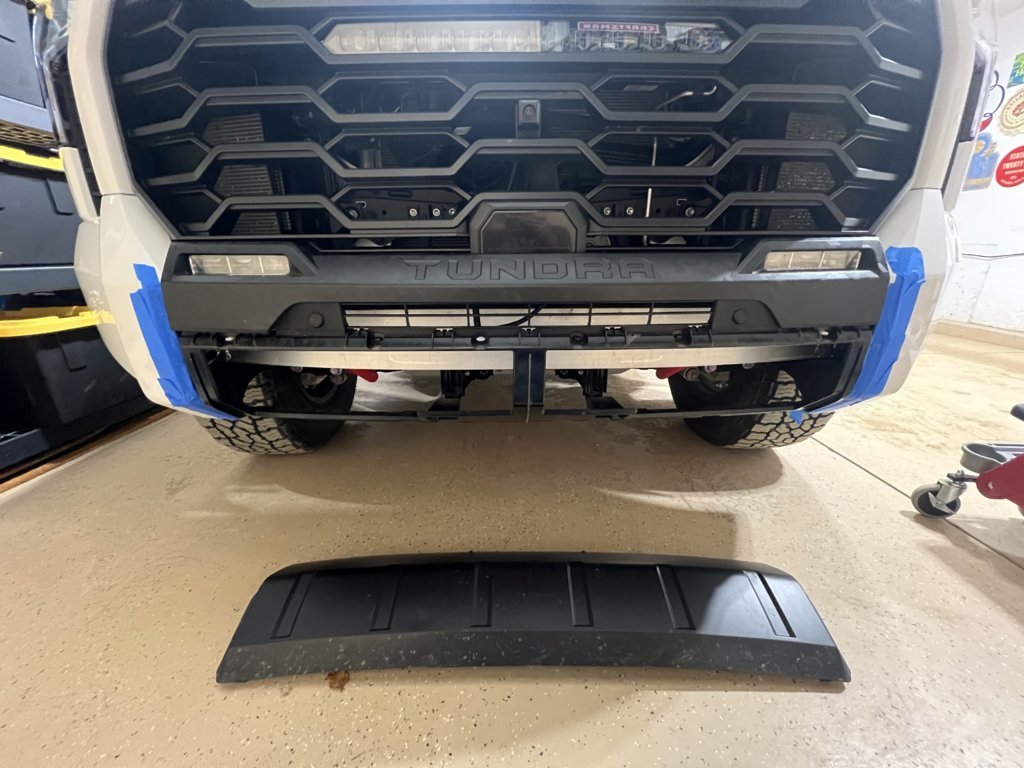

    Update 1. No need to remove the whole grill assembly to get the lower valance off.

    So, how did you do it?
    I can see the upper and lower clips holes, how did you access the side ones?

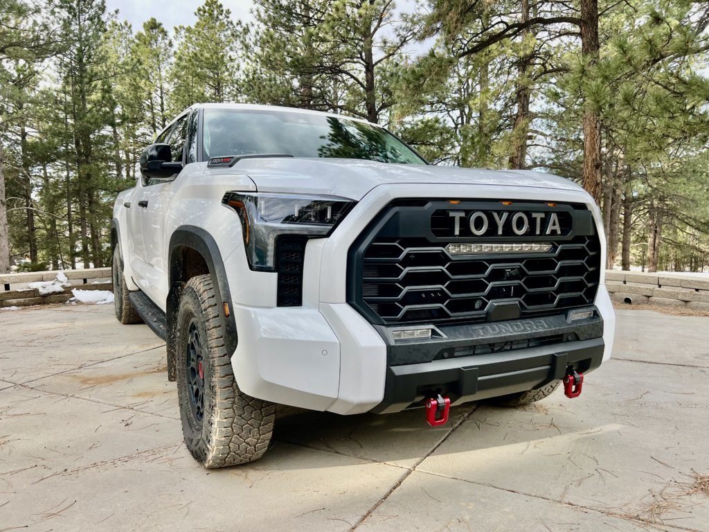

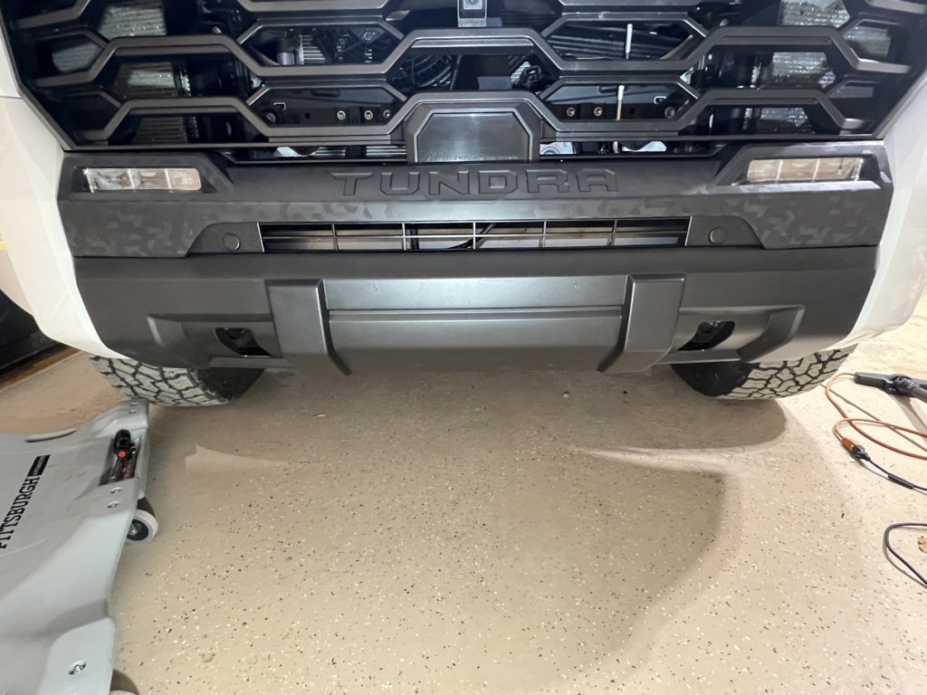

    Goobax likes this.
  9. Nov 21, 2024 at 11:29 AM
    #129
    H-10BTR
    H-10BTR New Member
    Jan 21, 2023
    #90703
    18
    2023 Tundra TRD Pro
    I don’t have an air dam so maybe that makes a difference but I just disconnected all the clips holding the valance on from underneath and behind the bumper. It wasn’t difficult to get to them. Install of the new valance was just as simple. It did help to loosen the plastic parts above and to the sides a bit to have more room to work with.

    I have no air dam so that wouldn’t be a factor. Are the cuts you made on both sides? Cannot visualize location(s) due to zoom.
    Edit:
    Never mind, template photo 2.3 shows where they go. :)

    Done! I love the look so much better in person than in pictures. Looks better without the TRD shackles on imo. Gonna buy some normal sized shackles in red soon. If I did this project again I would 100% leave the grill attached and remove the valance like I described above, that was pretty easy. The only thing I would do differently would be to install the bracket to the bumper prior to installing the new valance. That way will give you a bit more room for a torque wrench. IMG_2741.jpg IMG_2738.jpg

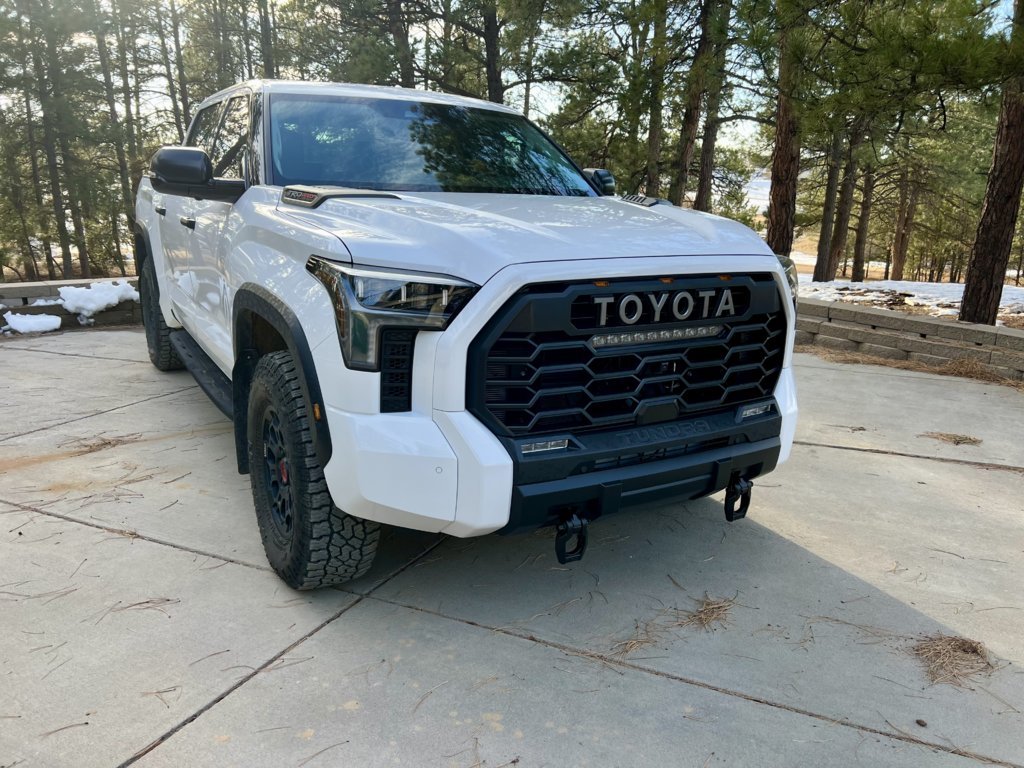

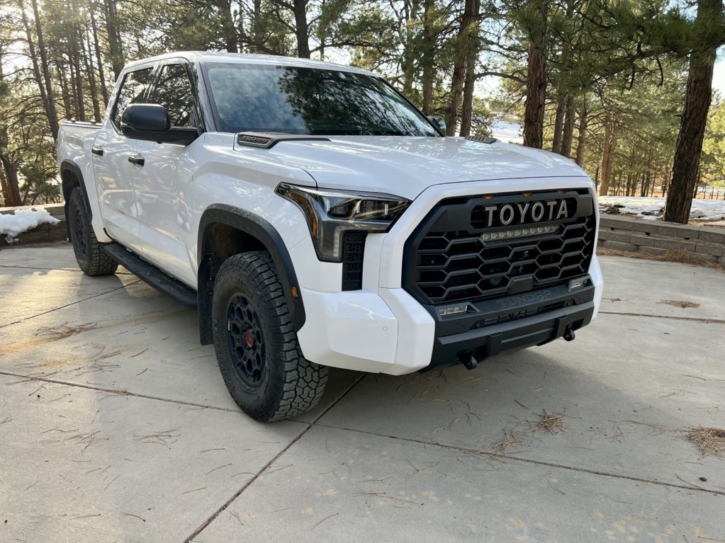

    The SoAz….. big surprise
    Bone stock
    I like the red tassels much better

    Looking good. Which ones did you get?
