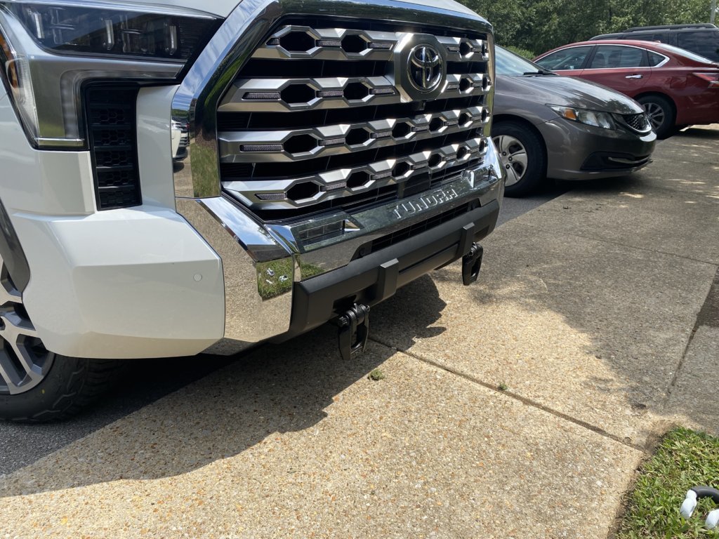

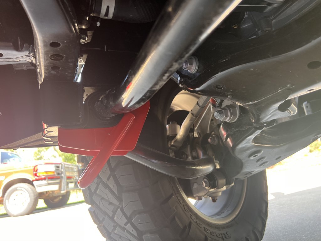

    25 Tundra SR5, 4x4, PremCnv, Perf. Pkg., Blackout, TRD 3”Lift, 20”TRD rims
    Heritage grille, fog lights, 35x12.5x20” Nitto, low profile toolbox, F/R tow hooks

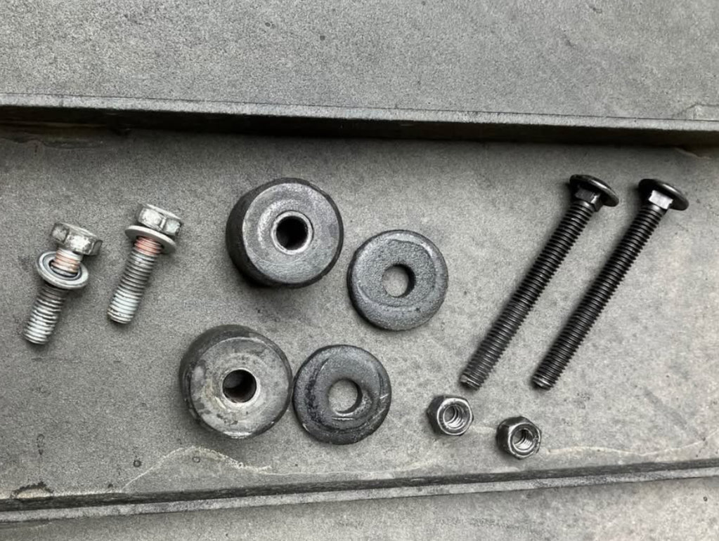

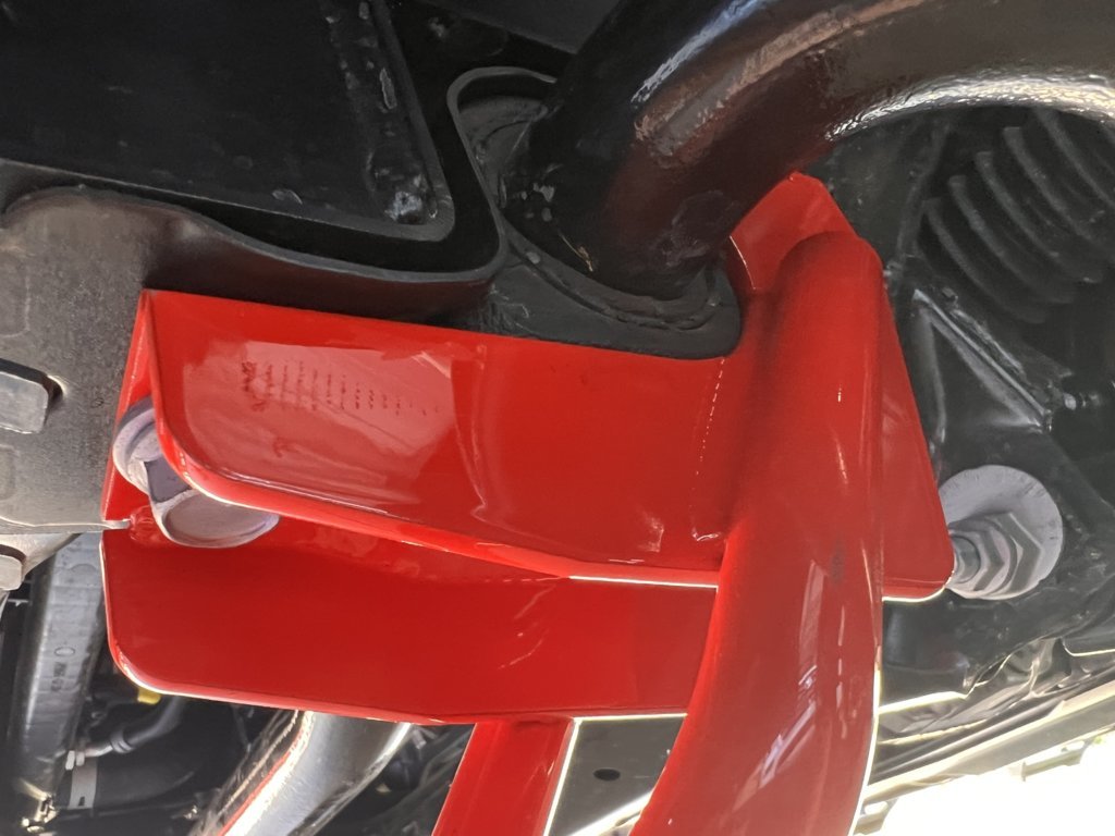

    Possibly you’re correct. My perspective is the bolt itself will be the weak link if tow hook was overstressed. My Toyota bolts were marked as a Metric Class 10.9 (around same as SAE Grade 8) hardened bolt, and they’re mounting into the crossmember with a bunch of thread.
    When I look at how I expect the torque of a straight forward pull will be, most stress would be on the rear bolt. It appears as a strong mount as the TRD sway bar spacer is substantial and a welded box, and the bushing and sway bar are ‘in between’ & are going to prevent the crush. Have know idea how these AFE might work with another brand suspension lift. I will add that purposefully used a floor jack right after I installed on each hook to test, and saw zero issues. They’re on solid.
    I don’t see using these but for pulling a rolling vehicle out of a pickle, or occasionally dragging downed tree off our road. IMG_7389.jpg IMG_7387.jpg

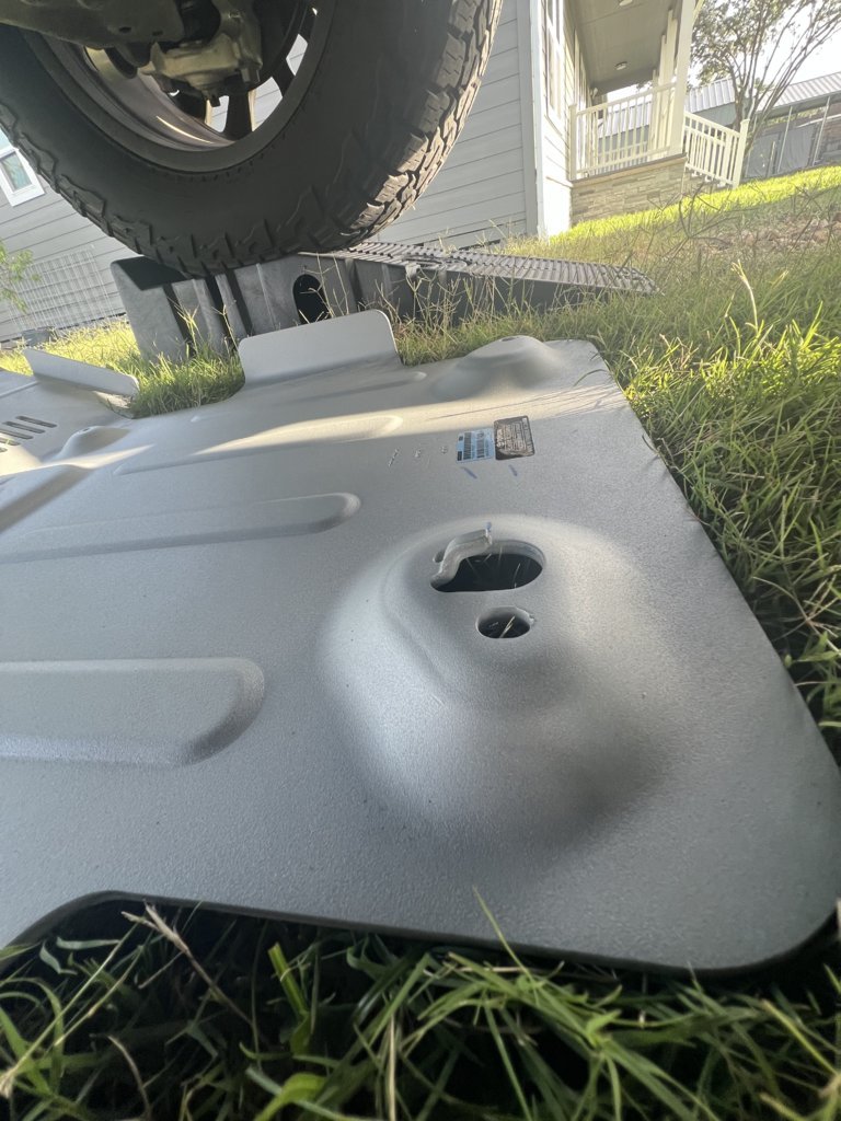

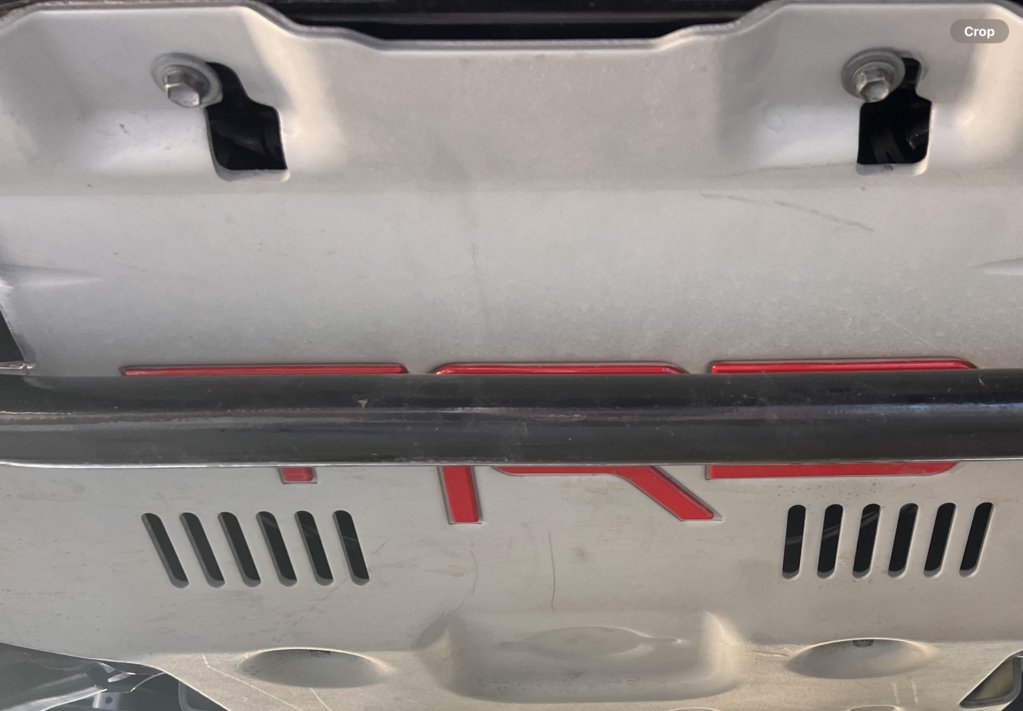

    The skid plate has a small tab on the driver side at the rear mounting position (where the cat shield is). Assuming this was bent flush for yours? Reason I ask is I have the same cat shield and noticed it would be a slight problem when I got under there but glad to see the bolts were at least long enough on the cat shield to use at the rear of the skid plate

    No spacers on TRD skid plates I’ve installed. Those long black bolts with smooth head look like cat shield security bolts. TRD skid.plates I’ve done used normal head bolts on rear location - like the 2 bolts to the left in your pic.

    So is that tab I pictured flattened down or did you remove it?

    The tabs are used to ‘hang/hold’ the skid plate while you’re positioning it to install. The front holes on the skid plate have elongated slots so you can loosen the front bolts, leave them in, and shift the panel to unsecure it. So those rear hooks hold up the rear of the skid plate once the rear bolts are removed. IMG_0582.png You’re probably removing it every time you do an oil change

    I’m aware of what the tabs are for but there’s no way to have the rear tab (pictured in my photo) lock in if you have the OEM GC cat shield. Hence the question, what did you do to the rear mounting tab on the skid plate?

    I didn’t do anything to the tab. Left it intact. Sounds like you may need to knock yours flat w/hammer.

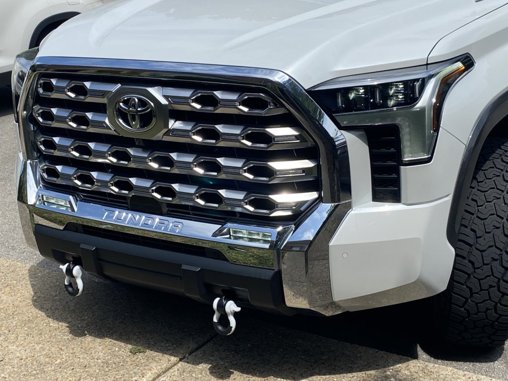

    Can anyone comment on the cost to have the OEM recovery kit installed by toyota

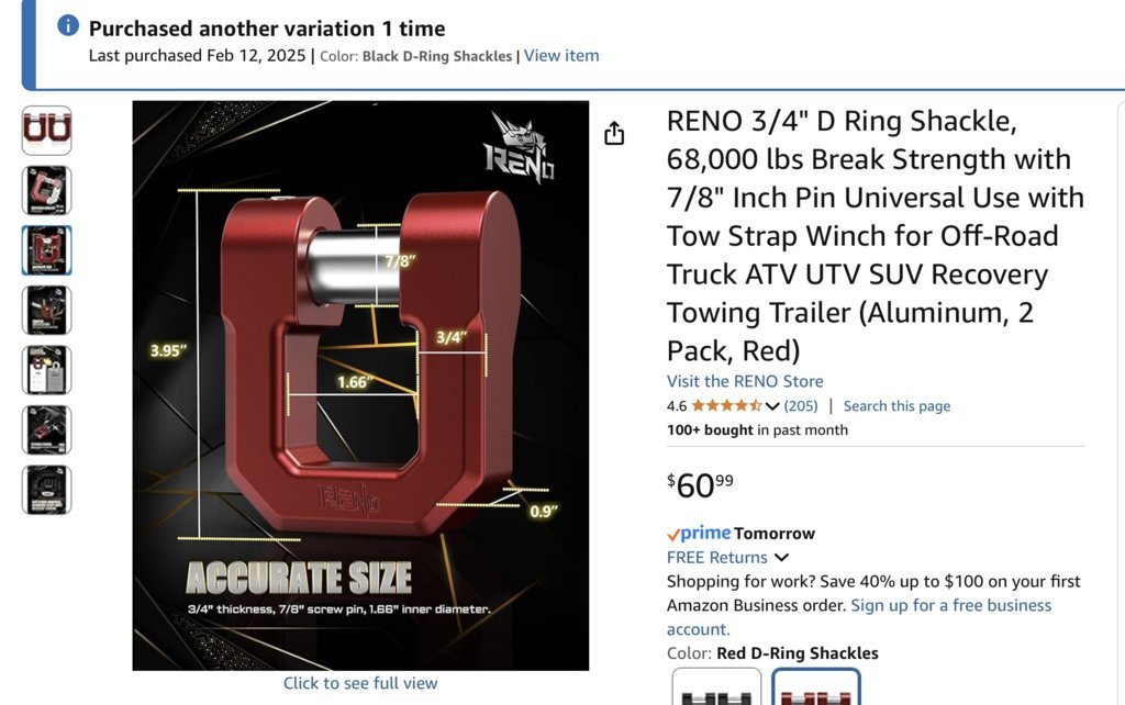

    Can someone who has the OEM recovery kit installed tell me if a 3/4 D-Ring shackle go through the recovery opening. The screw pin is 7/8th. Just seems way too thick. I purchased it from Amazon and I think it is too thick. Thanks
  21. Jul 19, 2025 at 10:48 AM
    #441
    TheDo114
    TheDo114 New Member
    Mar 25, 2025
    #132458
    50
    2022 Black Tundra SR5 TRD Offroad
    If you go to page 3-5 of this thread, you can see that people have installed a 3/4 inch shackle and clevis on the kit. Hopefully it answers your question.

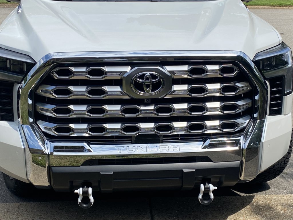

    #129464
    180
    Bob
    2023 Tundra Limited TRD
    The 7/8 pin will fit no problem. You do need to make sure the d-rings don’t have dead end openings like this one. These did not work for me unless you reversed one of them as the pin would not clear when inserting.
    https://www.amazon.com/RENO-Ring-St...8-1-spons&sp_csd=d2lkZ2V0TmFtZT1zcF9hdGY&th=1

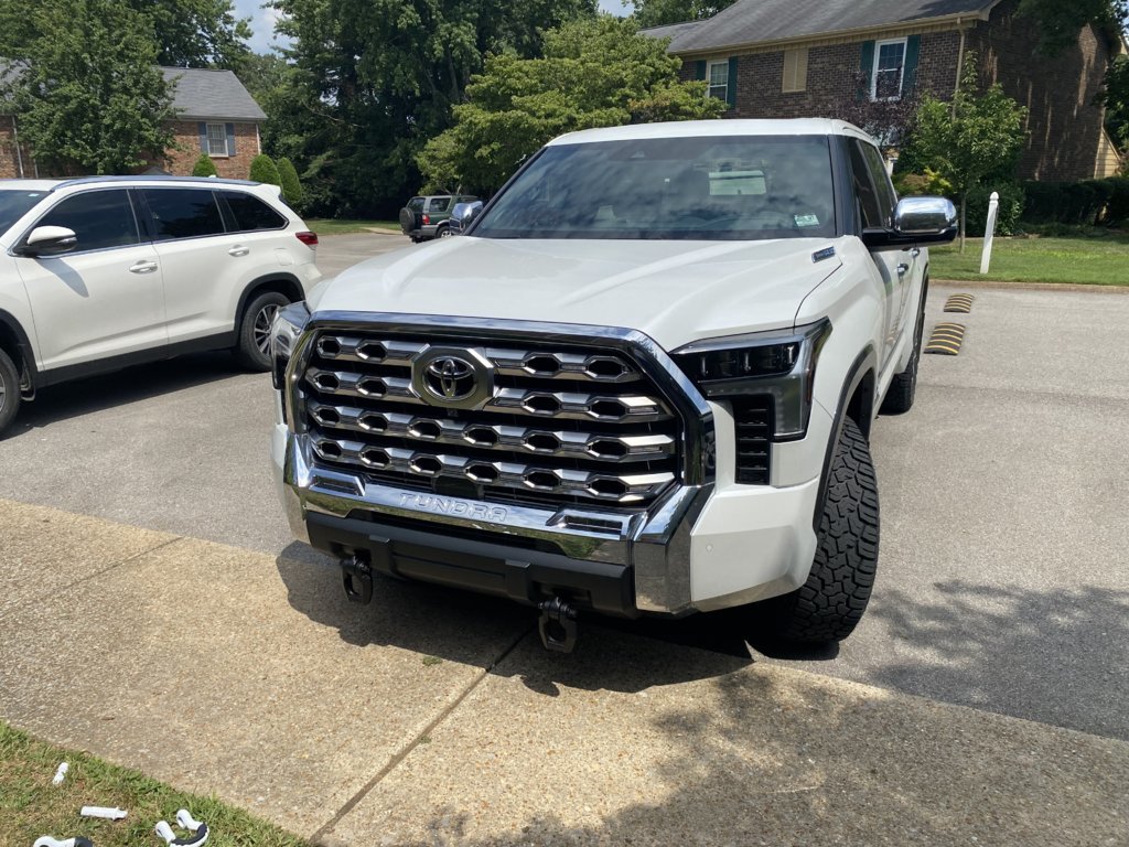

    For reference - i was able to purchase the recovery kit for 495.00. They are going ro charge me 1 hour of labor. They also gave me. $40 coupon off of labor charges. Total with taxes came out to 703.00. I think that is pretty good. It is worth to me to have them install.

    Ok. Here is the rest of the story. They installed and told “lesson leanrned”. It is a 3-hour job. They only charged me the quoted 1-hour labor. I got lucky. I was their first install. Please take a look of the pictures. I honestly cant decide which way to go.
