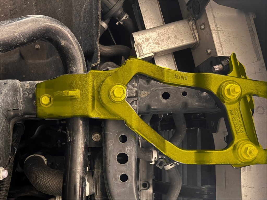

    Unfortunately that won't work as the tow hooks mount to the sway bar mount and then the hooks would be way to low for the opening in the new valance that comes with the kit.

    Dumb question…but whats the purpose of the sheet metal bracket that comes with this kit, and why is it replaced?

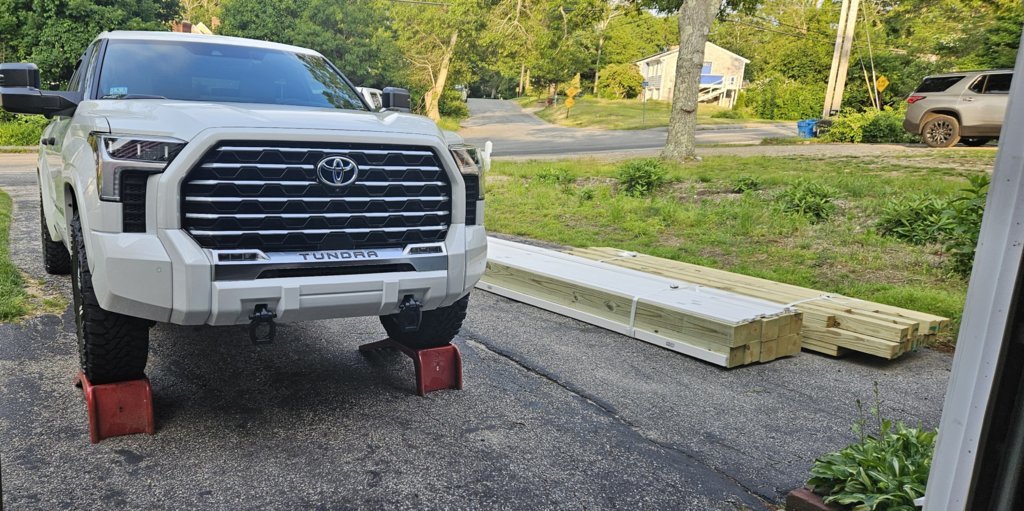

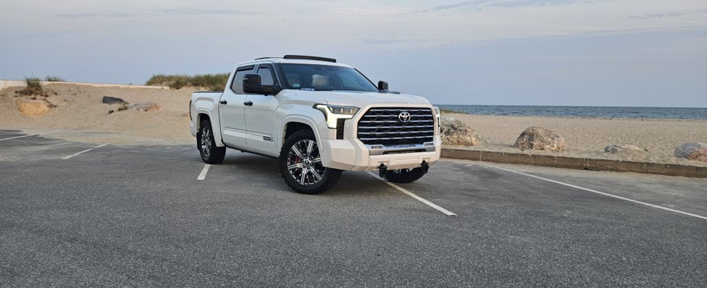

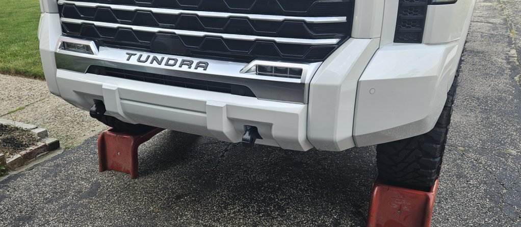

    The process wasn't painful at all and really straight forward and to the point, the only suck was to deploy the air dam to slide extensions through and to retract it to tighten but otherwise cool project.
    Why the Fuck didn't Toyota have these from the start or at least charge us for the add on?!

    it’s a thick steel bracket that helps holds the front of the cast tow hook to the bumper. The kit is really nice I have it on my 2023 Limited, it’s jus unfortunate it won’t work with the sway bar drops on the 3” lift kit

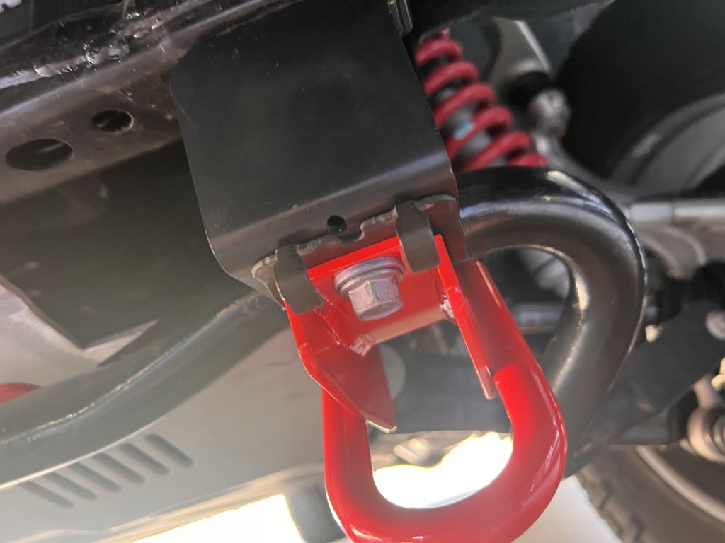

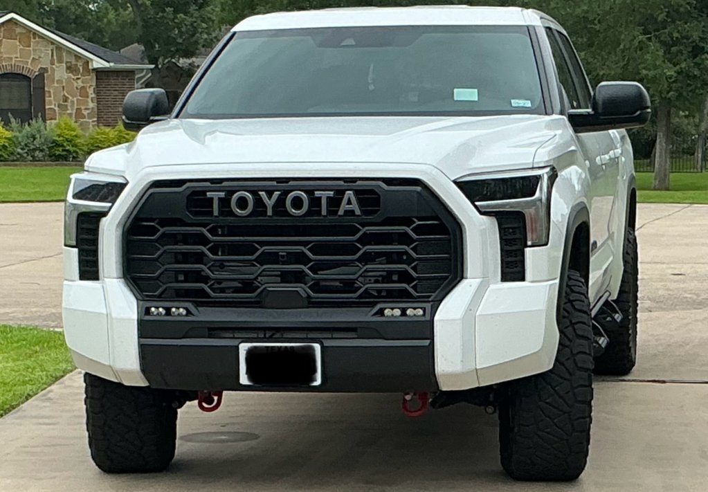

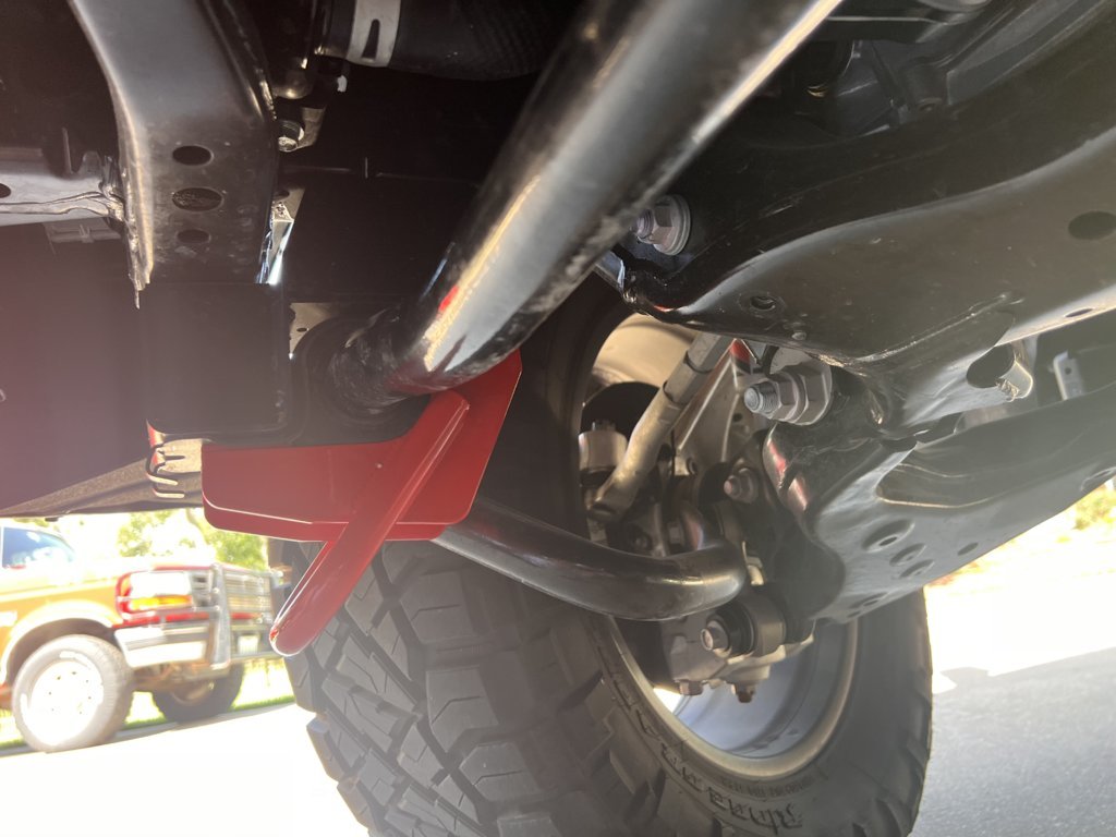

    I have the AFE tow hooks with a factory 3” TRD lift. Easy to install. Saw the warning on AFE that it doesn’t fit, but I took a chance figuring there was a decent chance I could modify. Turns out it’s very easy.

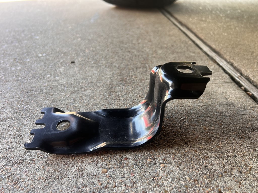

    Just remove the bolts, remove the lower 1/2 sway bar bracket (there is an upper that stays put, and a lower that is removed), add the AFE hook, and carefully start the bolts.
    The bolts are fine thread so be careful to get them aligned straight so not to strip. With the 3” lift & 35” tires the hooks are a good attachment height for pulling another vehicle straight out, as a tow strap will remain below the front facia. Took a few times on first one to figure out the combination of what parts stayed of the original and what you don’t use, but 2nd hook was less than 5 minute install.

    @G8Santini this is very cool. I’m going to have to this a go, since no other options seem to work without change the sway bar to TRD Pro or removing the spacer. Thanks!

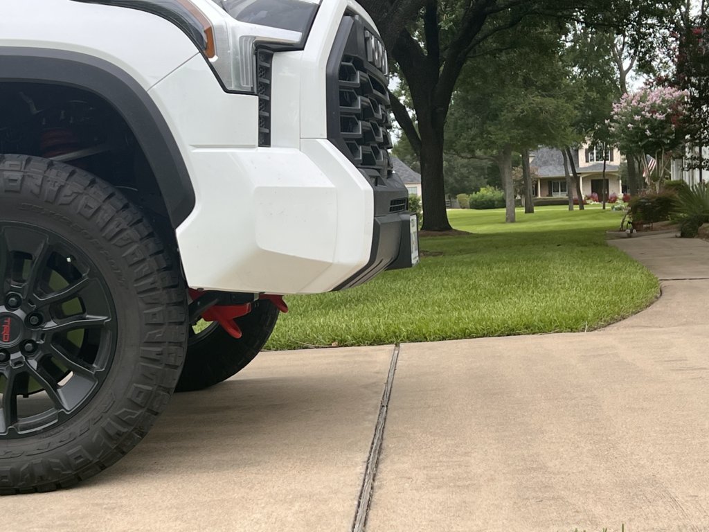

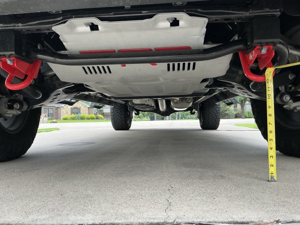

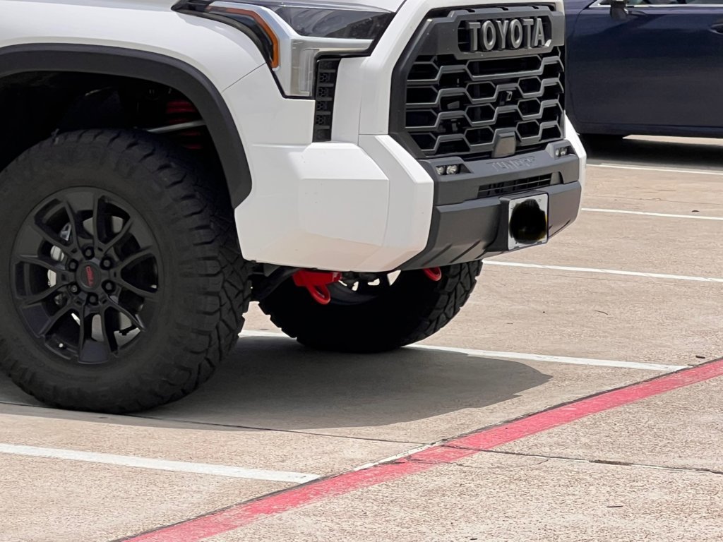

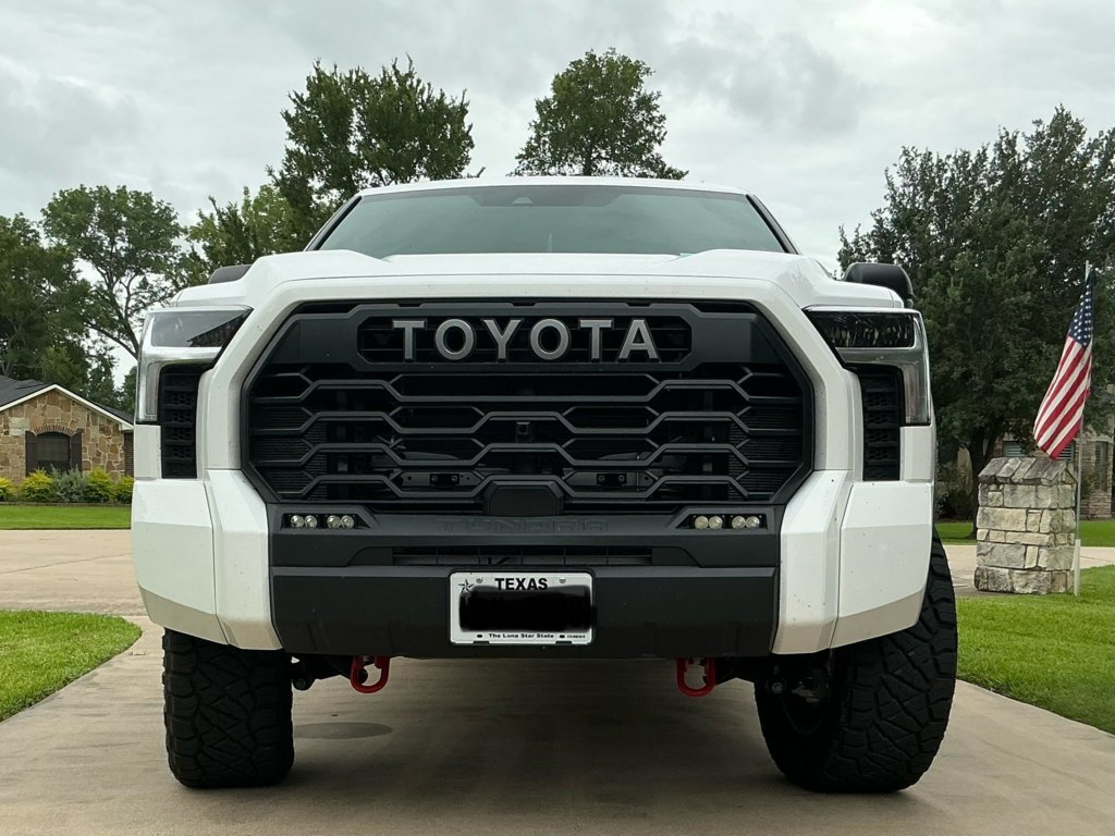

    Got a couple requests for after-install pics, specifically on how these AFE tow hook locations are with a 3” lift. Ended up just over 12” ground clearance, but notice that the sway bar turn is actually about 1” lower. Works fine for my use.IMG_7488.jpg IMG_0555.jpg IMG_0577.jpg IMG_0554.jpg

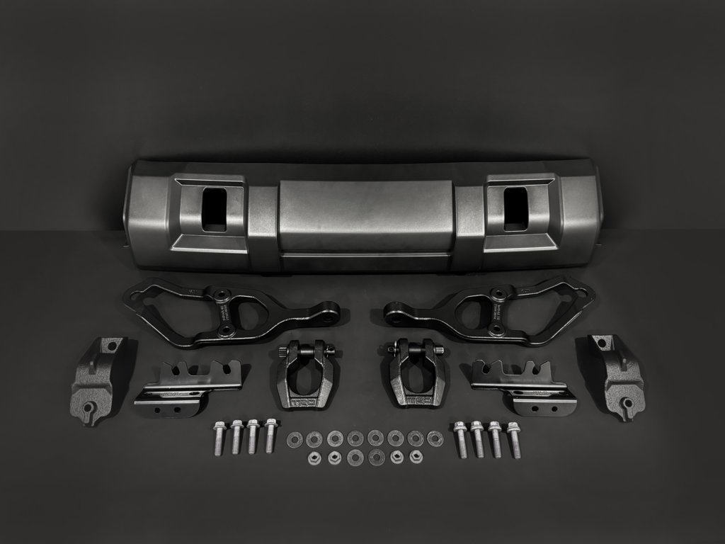

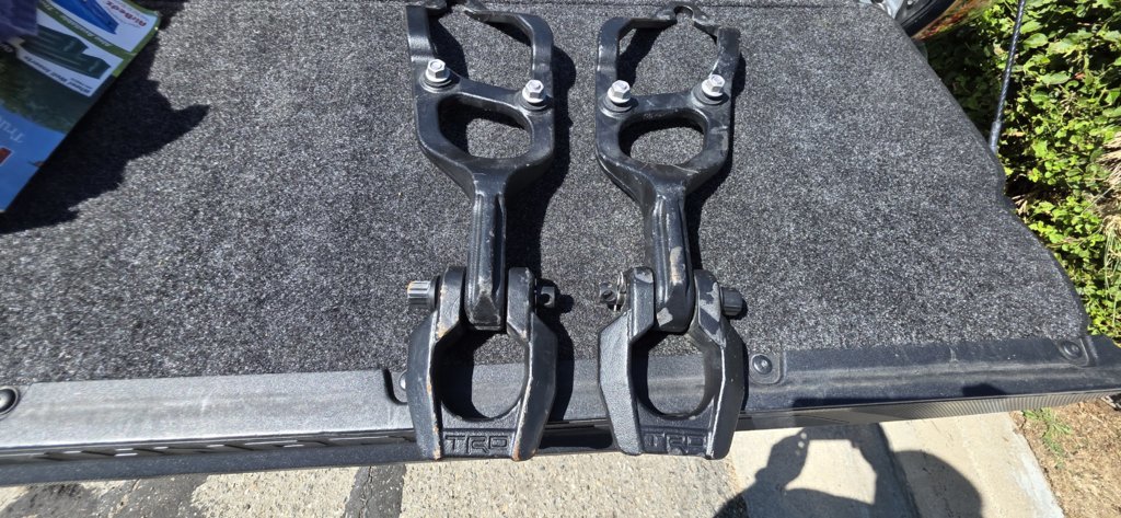

    So after the accident and getting a entirely new trd tow hook kit, I have these spare parts...sell them or pc them red?

    Powdercoat them TRD red then sell them to me lol
    JK. But I do think a red set would look cool though.

    TRD red

    are you running the dealer installed cat shield as well? Did you have to mod anything to get that skid plate installed (aside from the cuts due to your lift/sway bar)

    The Cat-shield I have is the one Gulf States Toyota (distributor) port installs and delivered on the truck. It did not interfere with the TRD skid plate install at all. If I remember correctly, the front (closest to engine) cat shield mount has 2 bolts attaching it to the cross member, and those 2 are not security bolts like the remainder of the cat shield bolts.
    So removed those 2 bolts, the skid plate went on top, and replace bolts.
