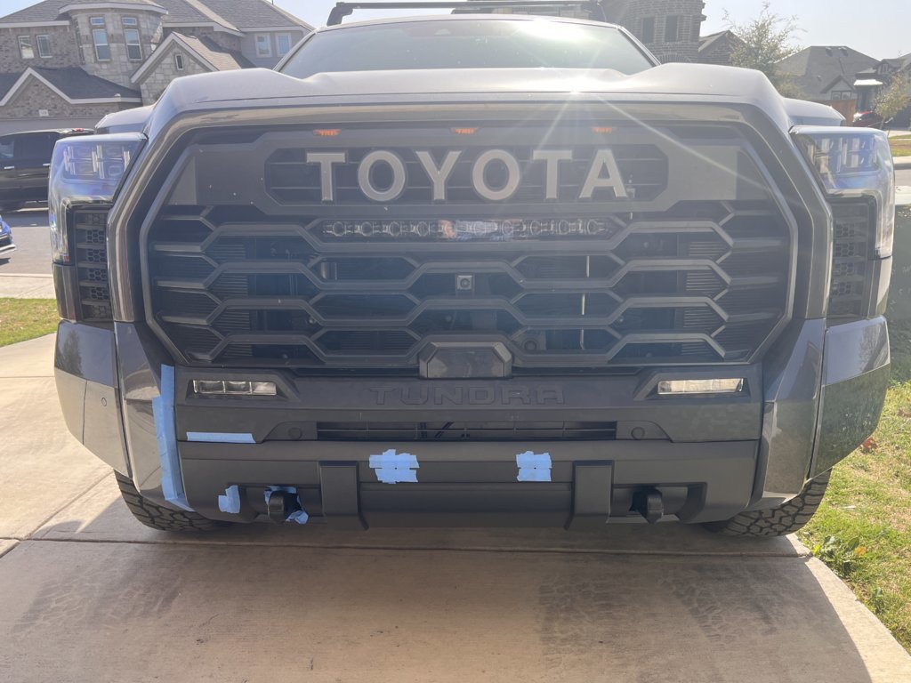

    No cutting at all but make sure you place alot of painter's tape around the inner edges of that new front bumper valance replacement as seen in the picture i previously posted.

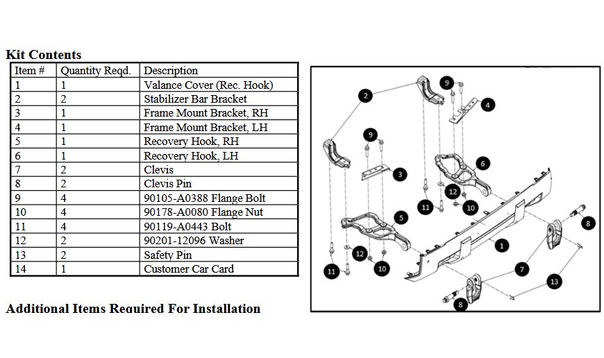

    Steps I did with installation.
    1. Remove old valance cover.
    2. Remove old front mount brackets and old stabilizer bar brackets.
    3. Install new front mount brackets.(#3 and #4 in the installation picture using #9 flange bolt) Make sure it is torqued to specs.
    4. Partially place the new stabilizer brackets with one loose #11 bolt at the posterior end of it with no washer)
    5. Replace new valance cover and make sure to place painter's tape at the edges and where you deemed it's needed.
    6. Align and pass through the recovery hooks through new valance cover holes. It is a very tight fit, that the plastic may stretch while pushing through it. Be careful!
    7. Place the new #11 bolts with #12 washers now on your #5 and #6 recovery hooks and torque to specs.

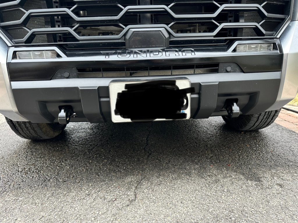

    Wondering is it up to you where to put the license plate or are there markings on the bumper?
  15. Apr 5, 2025 at 8:16 AM
    #315
    Siblue
    Siblue Old member
    May 10, 2017
    #7665
    756
    Ryan
    25 Tundra TRD pro
    New panel has dimples for license plate hardware.

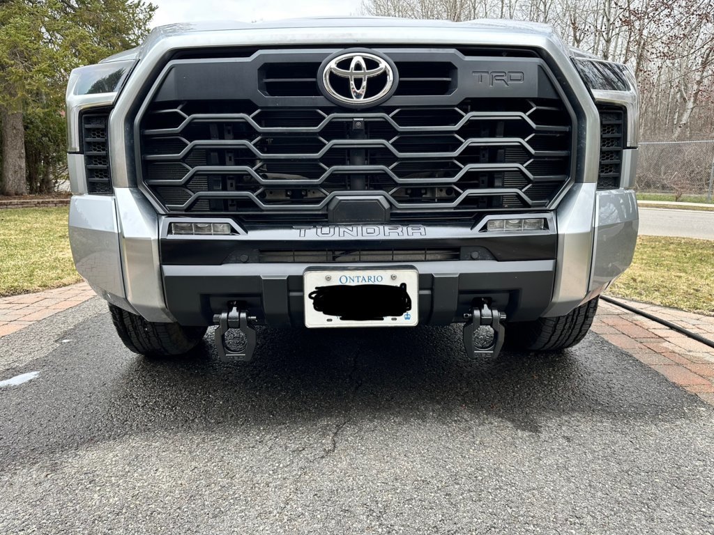

    I installed mine over the weekend. The passenger side seems to be a little lower than the drivers side. I used the same number of washers on both side. Has anyone else run into having to use more washers on one side to even them out? I know the instructions say they give you several to account for variances in individual vehicles, but I figured it would still be same on either side. It's not off by a lot, just enough to bother me.

    Just got mine from my Dealership here in Ottawa Canada they are available now
