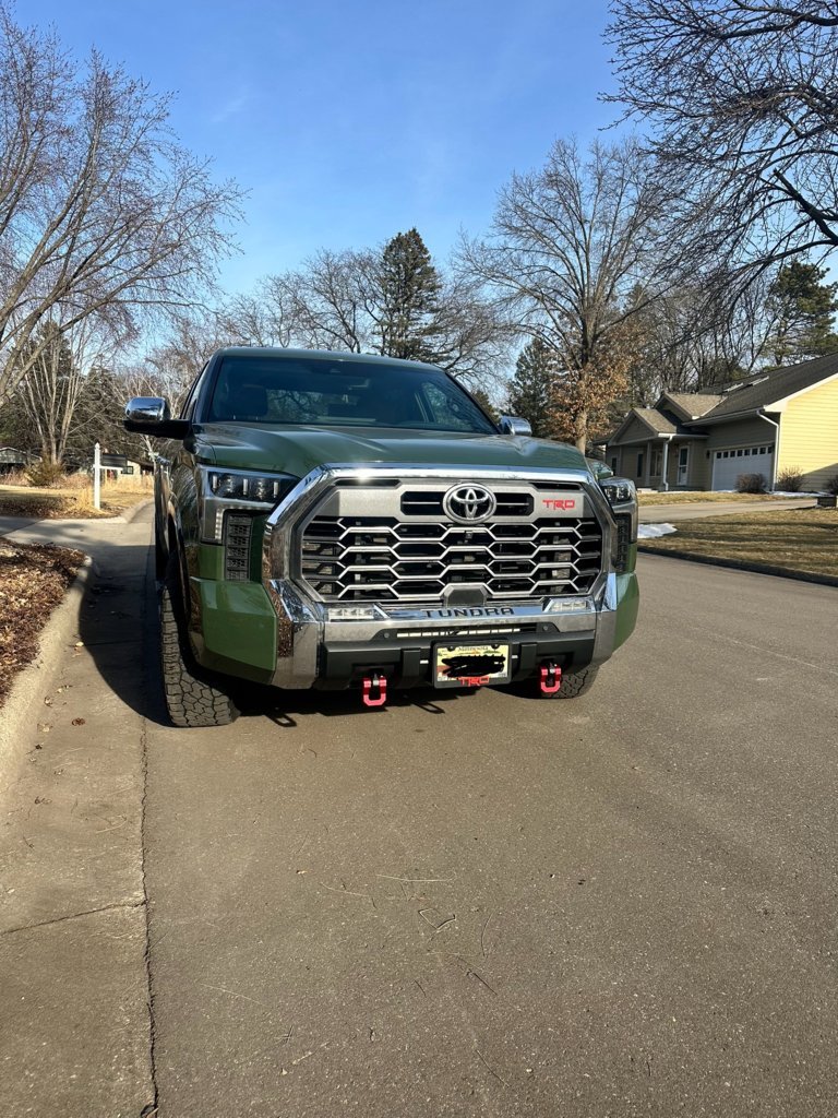

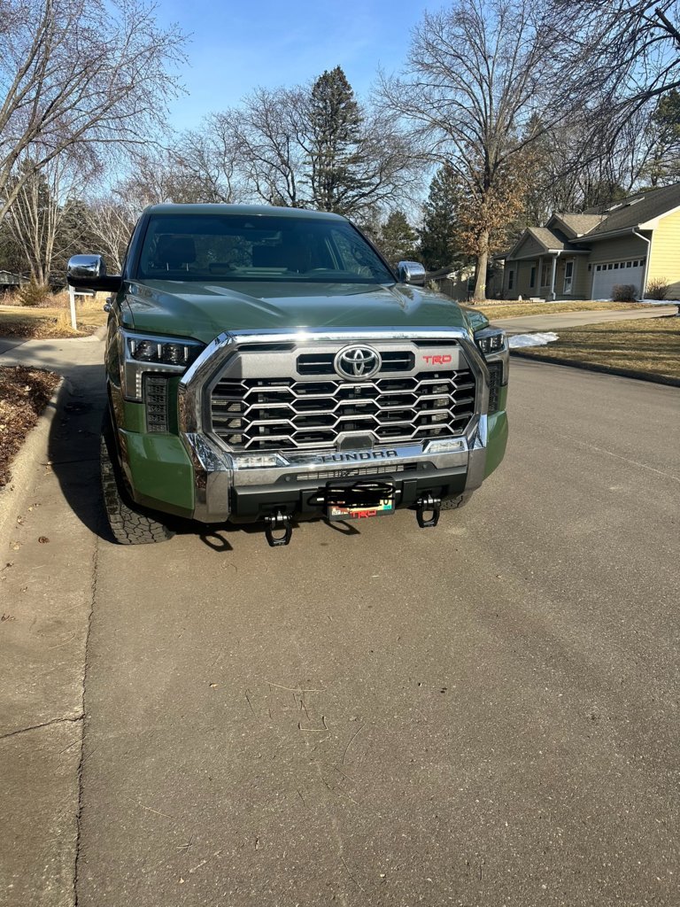

    Completed my install today, now just need to decide if I stick with OEM shackles or the Reno red billet aluminum versions…

    I vote for Red!!

    I’m definitely leaning Red too…I like that it takes an Allen wrench to remove them which helps deter theft as well. The OEM shackle you can just unscrew and it comes right off.

    Definitely red. Looks good!

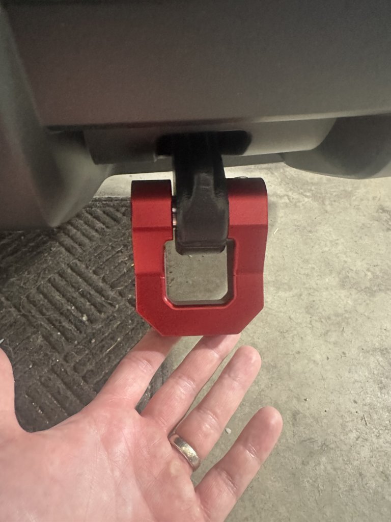

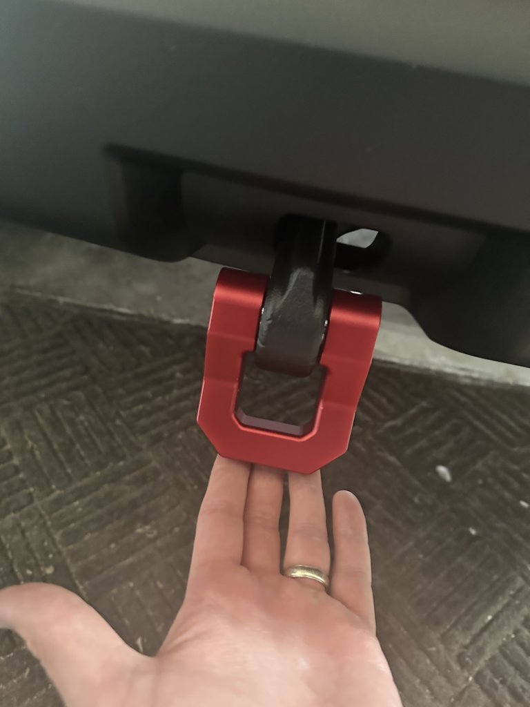

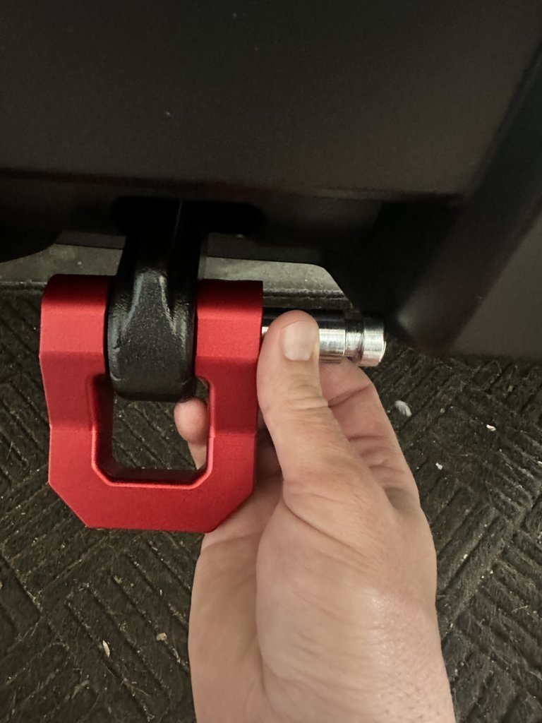

    @wallygator12000 How did you get the Reno shackles on? I bought them and the passenger side went on easy but on the driver's side the shackle pin hits the the part of the plastic bumper that sticks out. I could not get the drivers on one. I see you mounted your reverse so on your's how did you get the shackle pin through on the passenger side?

    @Calif-Tundra - that’s interesting because I didn’t have any issue at all with the pin contacting the plastic bumper? You’re correct that I mounted both reverse (so the Reno logo is facing backwards). I took a picture of both to show how much clearance I have to the bumper (left/passenger is first pic, right/driver’s is second pic).
    The third pic is the left/passenger with the pin out - mine has enough clearance that the bumper doesn’t prevent the pin from inserting with the shackle inline with the mounted receiver? When the pin is as far out as I show in the picture the shackle is free and slides off the receiver.

    thanks @wallygator12000 I will try to mount reversed.

    Yep, I had the same problem. Unscrew some of the bolts that hold plastic bumper on. There is a total of 8 of them along the bottom of the bumper. You'll then have enough play to pull the bumper out of the way.
