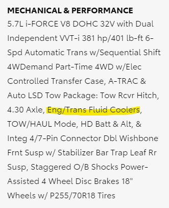

    I have a '21 Pro, and it does not annotate a trans cooler on the window sticker....

    This is what mine says

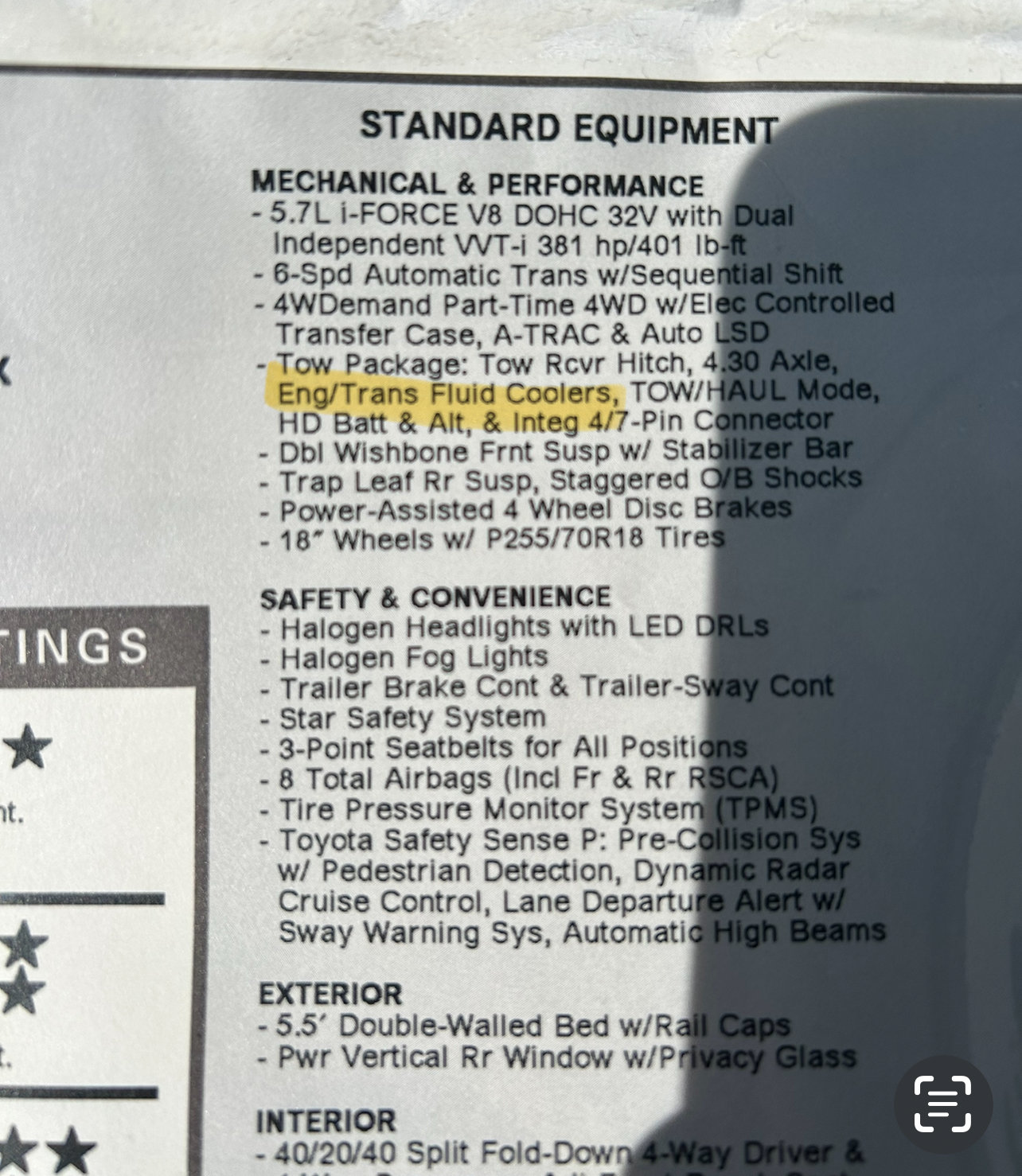

    Just checked my 21 sticker also, no mention of cooler. I really wish they picked something else to cut corners on rather than something that could reduce the life of the transmission. It is the only thing I don’t like about the truck. I have had my 2021 so far 2 years and it is an outstanding vehicle other than transmission temp getting to 250 deg F pulling a stupid 2000# pop up camper.

    Mine still shows a trans cooler online when I put in the VIN

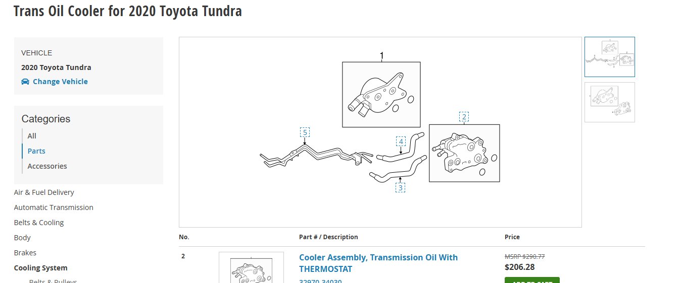

    this is the part- among others - that I had to buy to install aftermarket cooler. to mimic the original cooler.
    I'll add some color to this...
    my '20 did not come with the external cooler. it only had the puck.
    I was seeing 205-220 unladen on cruise control @ 62mph in Houston summer weather.
    I don't tow. folks that do see 230-250. in the pan!
    I installed the external cooler - genuine systems- and that brought the temp down to 195-ish.
    then.....wait for it....I pinned the thermostat.
    now I run 175-ish.
    the trans heats up the same way it always did...via the puck -- which somehow gets its heat from the radiator.
    so - removing the ext cooler was not good.
    no matter what all you culty Toyota folks think.
    all it accomplished was to make the trans run much hotter.
    will anyone win this one. no.
    the puck still qualifies as a cooler.
    because it limits the trans temp via the radiator.
