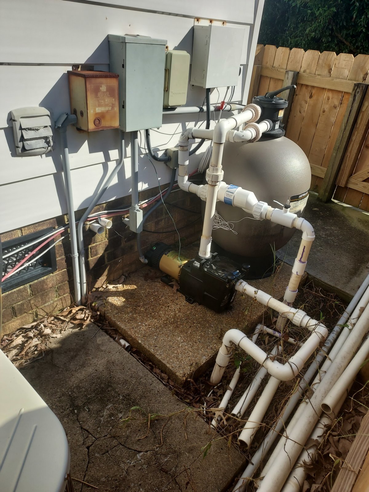

    I'm having a hard time picturing why your ground point is so far from the pump.
    Is your power distribution panel that far away? Mines just a little over a foot. 20240819_165832.jpg

    Jeezus clean out that dryer vent...:eek2::oops:o_O:cool:

    Replace it is on the list. The hose is only six inches long.

    How did that happen? I would consider relocating the panel. But you're probably on a slab. You're in a pickle for sure. If you got shocked by the motor housing, I would seriously consider not using the pool until the wiring is fixed.
