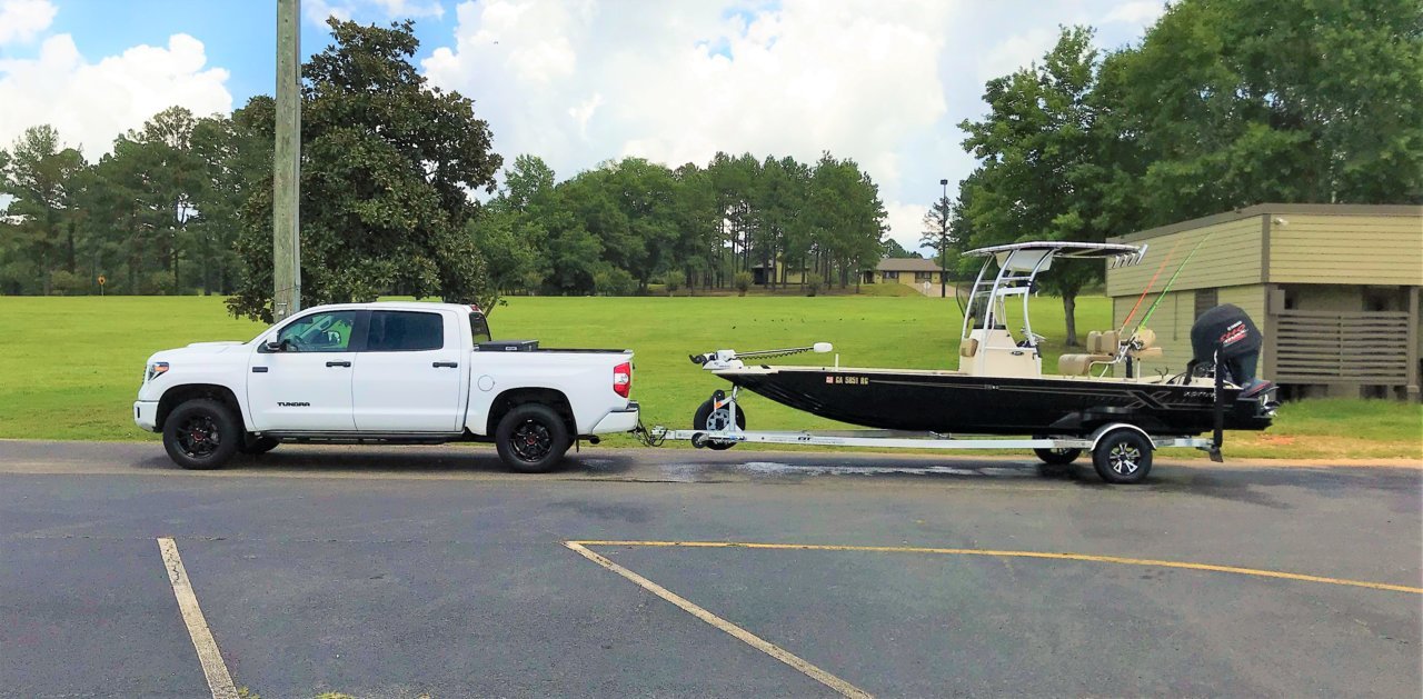

    I was having a hard time looking at how low the rear of my truck sagged while towing my boat. Then I broke down and purchased +1.5" shackles, and wow what a difference that made. Now my PRO sits with a nice rake while not towing, and while towing it's perfect. This truck runs down the road pulling this 20 FT Bay Boat like it's not even back there. Very pleased.

    I tow my 20' River boat that weighs 6500 lbs with trailer, fully loaded with gear and 74 gals of fuel on board with no problem...in tow haul you barely notice it's back there unless you look at your fuel economy screen lol.
    I have a 4" Readylift and +2" coachbuilder shackles also added on the rear to maintain stock +1" rake, I also added Firestone airbags and run 35 lbs in them when towing to keep it at my normal ride height. IMG_4745.jpg

    I'm the kind of guy that rarely ever performs Mods on my truck, I like them bone stock for the most part. But my PRO sagged so much when towing the boat that something had to be done. Finally, after looking at so many other options out there, I went with + 1.5" shackles and man it was the perfect solution. When not towing, can't tell any difference in ride quality. But how sweet it is not to have the ass dragging when I hook up my boat or utility trailer.
    Here are the before and after pics of the stance. Not a big deal, but makes a huge difference. Personally I much prefer the back end to be UP more than the front. It's a pickup truck, it needs that rake for towing and payload.
    BEFORE SHACKLES:
    AFTER SHACKLES:
    BIGGER, HEAVIER BOAT, NO SAG:
