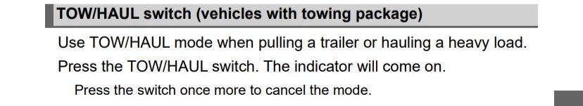

    FWIW, I emailed Toyota with the following question:
    Please help me to better understand towing with my new Tundra. I am not finding a clear answer in the owner's manual.
    I am towing a roughly 4,000lb travel trailer. Does Tow/Haul mode work when the transmission is in "S4" or only "D"? And is it okay to tow in D or do I need to be in S4 to avoid overheating my transmission?
    This was their written response (which wasn't as thorough as I wanted, as it didn't really answer all of my question):
    Response By Email (Roy G.) (06/28/2021 09:42 AM)
    Dear Mr. *******,
    Thank you for contacting Toyota Motor Sales, U.S.A., Inc.
    We are very sorry for any delay in responding to your email.
    We are sorry to learn of your concerns with locating towing information in your 2021 Toyota Tundra owners manual.
    In the interest of guest satisfaction, we researched your inquiry. From our available resources, the tow/haul mode should be used with transmission in D while towing.
    The TOW/HAUL pattern select switch is a momentary-type switch.
    • If the shift lever is in the D position when the switch is pushed once, tow/haul control will be performed. If the TOW/HAUL pattern select switch is operated again, or the ignition switch is turned off, tow haul control will be cancelled
    We appreciate your feedback about the Tundra owns manual, as it is through communications such as yours that we become aware of our customers' expectations and reactions. It also provides us with valuable insight when planning and developing future products and services to increase our customers' satisfaction.
    Thank you for taking the time to email us, and giving us the opportunity to assist you.
    Your email has been documented at our National Headquarters under file #210623002296. If we can be of further assistance, please feel free to contact us .
    Sincerely,
    Roy G.
    Toyota Brand Engagement Center

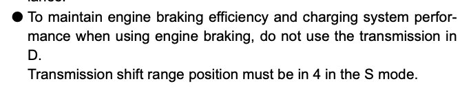

    In theory, I agree with the folks who say that if Toyota says to tow in D, that's what we should be doing. However, there are a lot of folks here with 2019-2021 trucks who have reported lower transmission temperatures when towing in S4 than when towing in D. So that's what I would lean towards unless I decide to add an auxiliary cooler.
