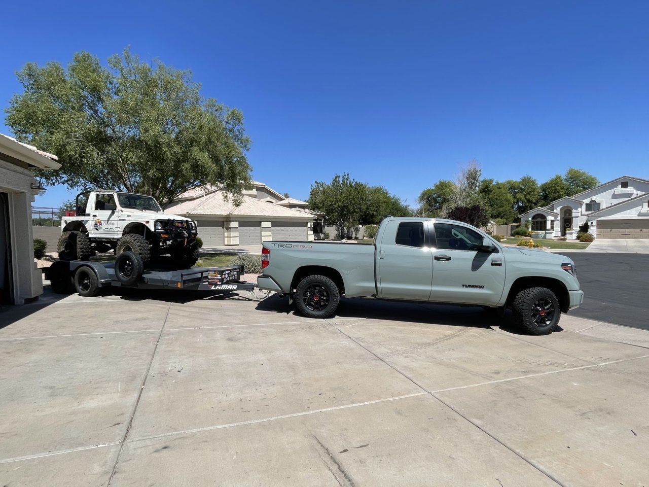

    Around 4k lbs (including trailer). Lets call it 4500. Steel deck dual axle car hauler.
    75mph, very hilly roads.

    That is one nice setup you have. Crawler is bad ass too.

    Thanks! Crawler will be frame stretched 20" here shortly and the front will be linked before it cools down enough here in AZ to actually go wheeling again. That and all of our national forests are 100% closed until September anyway due to fires.

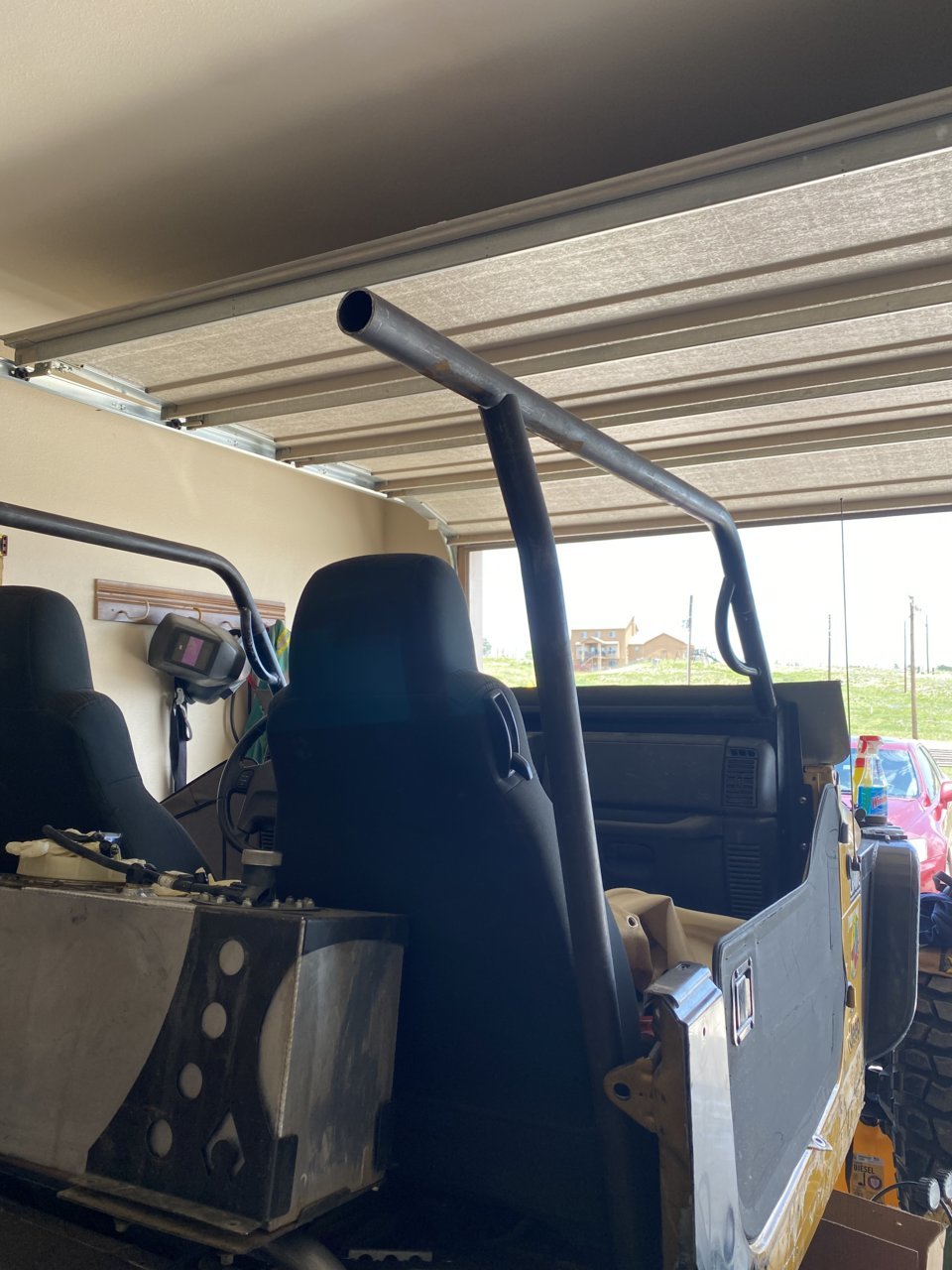

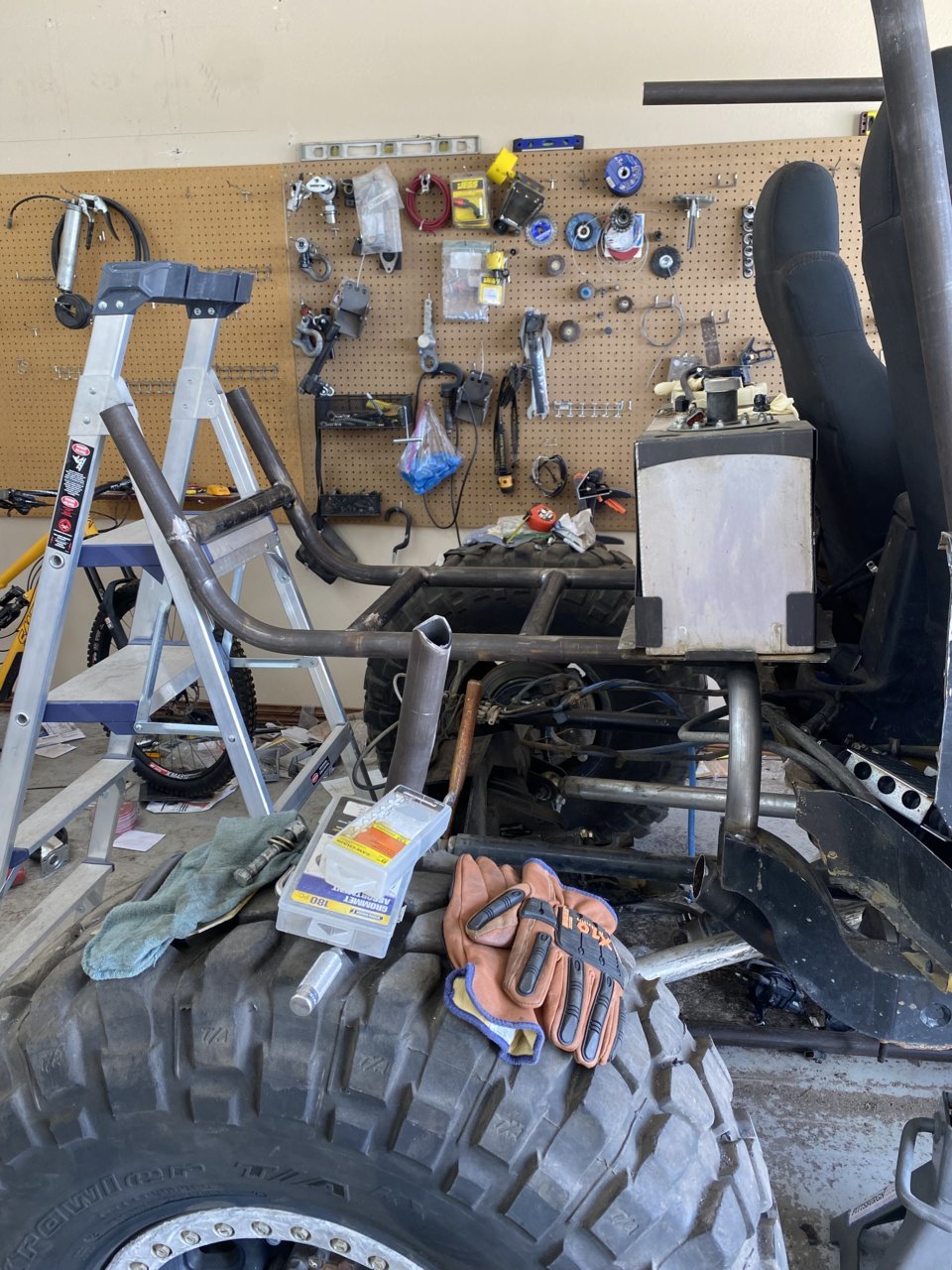

    Kinda doing the same right now. Roll cage and back half.
    7A2ADE36-9DF8-4E78-94EF-B8C1A982F88F.jpg 87A8A83E-B619-4632-89F8-6560144E6BE1.jpg

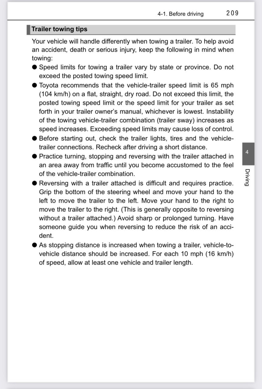

    Here is what it says in my 2020 manual

    Thank you.
    Oey12 and Clemsonman14[QUOTED] like this.

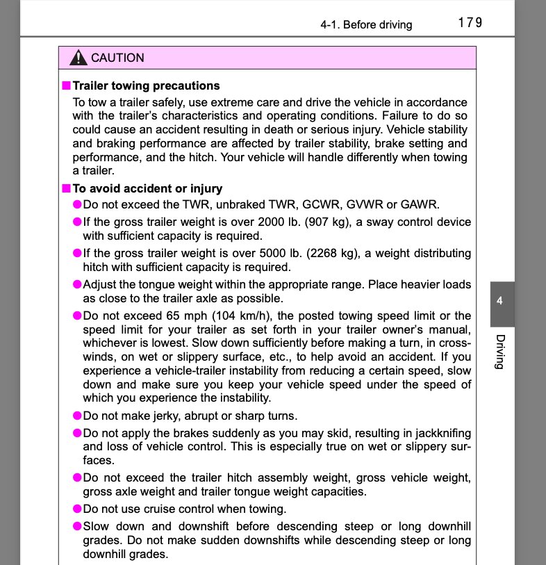

    To be fair, that warning / tip was in the manual before they pulled the ATF cooler. From my 2017 manual -
    GODZILLA, Oey12 and Cpl_Punishment like this.

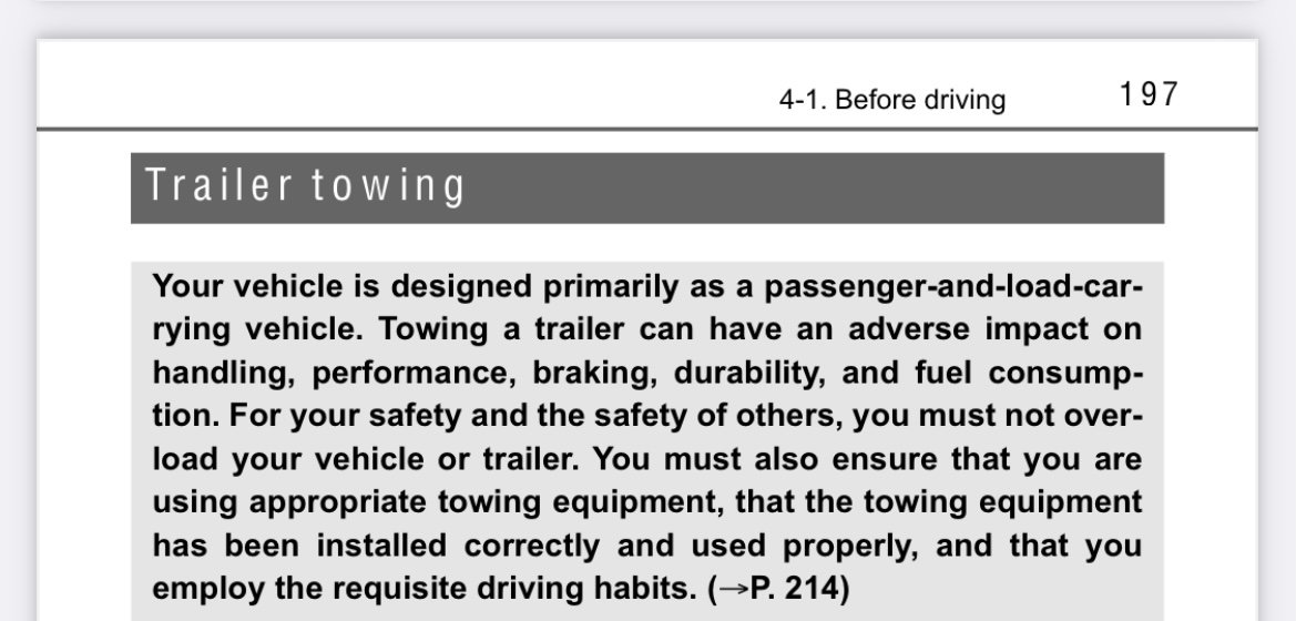

    Speaking of what does the OM say, the Tundra is designed primarily as a passenger and load-carrying vehicle. This is from the 2021 OM.
    GODZILLA and Cpl_Punishment like this.
