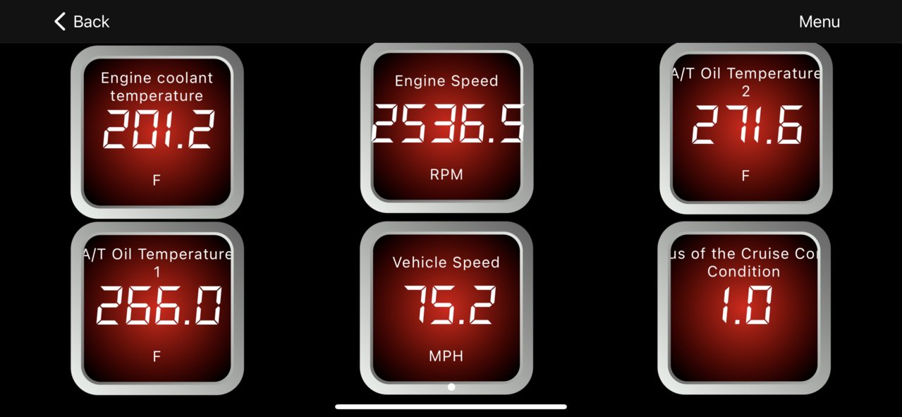

  23. Jun 22, 2021 at 5:01 PM
    #203
    realprotundra
    realprotundra Always Skeptical
    Dec 3, 2020
    #55643
    173
    Gilbert, AZ
    2021 Lunar Rock TRD Pro DC
    I believe I did see that at some point here on the 3rd Gen section of the forum. That being said, I'll try to remember to call Toyota in the next week or so and ask. I'm stretching and doing a tube clip on the Samurai for the next month or 2 so no towing during that time.
    I mean, my <5k load got me up to 266* trans temps at the pan.
