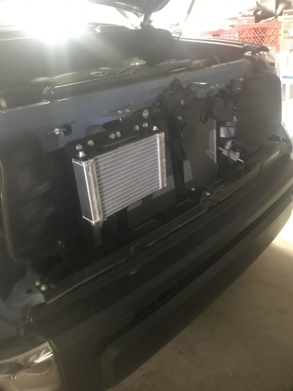

  17. Jul 10, 2021 at 12:10 PM
    #317
    Dirtytruck
    Dirtytruck Overkill it
    May 24, 2021
    #63485
    144
    Steve
    2021 SR5
    Took me 9 hours to install. Never installed one before. I could do it again in 4. Not shown is the thermostat, hard lines, soft lines, holes drilled through the wind deflector, etc. Just need to get a temp gauge to finish the job. Kit is from GenuineCoolingSystems.com. Very satisfied customer. Toyota dealership did a complete fluid flush using my AMSOIL ATF.
  18. Jul 10, 2021 at 4:56 PM

    Welcome to the dark side. Sounds like your Tundra will still run hotter than the 4Runner, but the aux cooler helps keep pan temps around 200F. I’ve put over 2500 miles on my Tundra in the last 8 days, and my TC got up to 235F a couple times very briefly on very long mountain grades where I was taking advantage of the passing lane, but once it finds lockup, it drops like a rock to match the pan.

  21. Jul 10, 2021 at 6:32 PM
    #321
    blanchard7684
    blanchard7684 New Member
    Nov 18, 2018
    #21856
    906
    Any issues with ac performance with cooler?
  22. Jul 10, 2021 at 6:35 PM
    #322
    Dirtytruck
    May 24, 2021
    #63485
    144
    Steve
    2021 SR5
    None that I’ve noticed

    None. I’m running the Hayden, and it covers up such a tiny part of the AC radiator, I think any difference in the AC performance is negligible. Looks like the Setrab overlaps even less, assuming overlap/airflow restriction is what you’re getting at.

    #63485
    144
    Steve
    2021 SR5
    The kit I used has the cooler mounted about 2-3” in front of the A/C condenser. I realize my cooler is a big fatty and the waste heat goes right into the condenser then the radiator. I can live with that.
    By the way, if you choose to install a cooler you cannot go wrong with a Hayden cooler. Mr. Hayden invented the transmission cooler after all.
