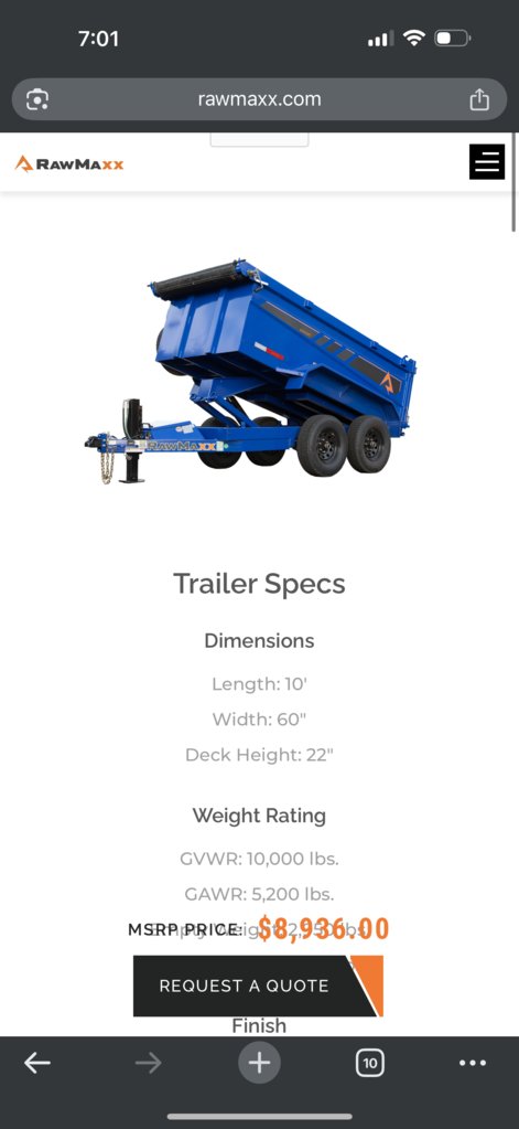

    Good evening! I have a 2006 Tundra (4.7 V8 4x4 access cab) and I’m now towing a small 7k 5x10 dump trailer.
    While I do not intend on hauling more than 5k total ever, including trailer, I do want some guidance on how I can tow this trailer without concern. It will be hauled almost daily, so I want to do what is best and safest for the truck.

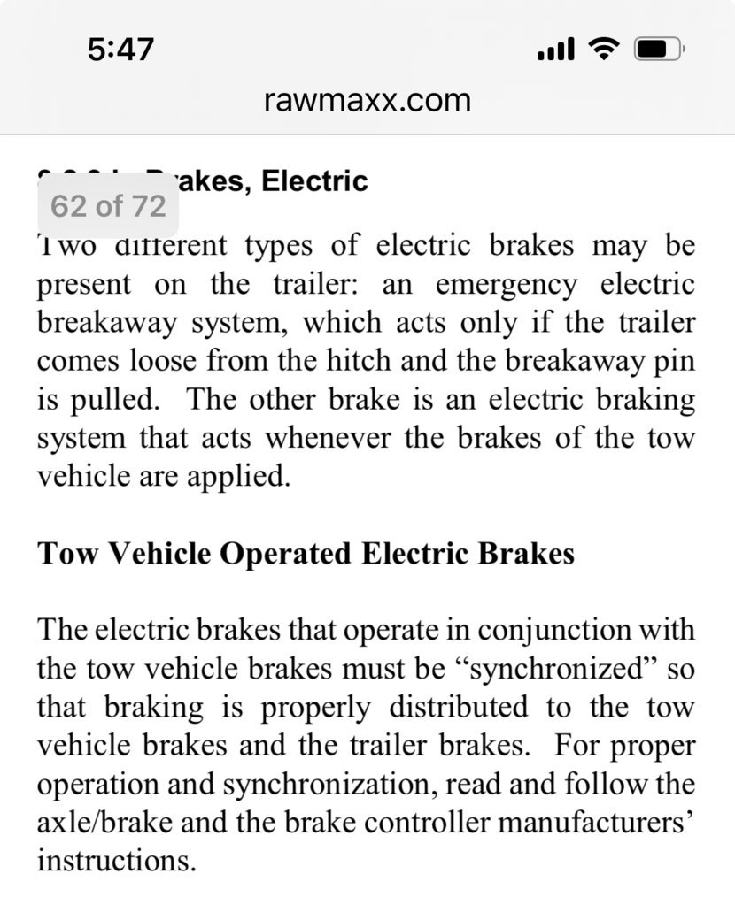

    I am concerned about the brakes, and want to be able to co trip them in the cab. I’m assuming this is something I can have installed?

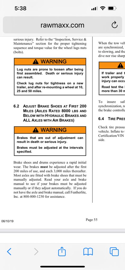

    More on the brakes, I’m supposed to synchronize the brakes with the truck, but have yet to be told exactly how. I’m concerned the trailer brakes are not working properly, or at all without proper wiring. I have not towed anything heavy yet, but the brakes have not been an issue as far as I can tell.

    Just found this in the manual too…

    Most trucks that don't come with the trailer brake have a wiring harness that is "plug n play", usually its off to the right of the steering column under or a bit behind the dash. I added one to another truck I have and it had the harness ready to go. Maybe ask on the forum if anyone has added a trailer brake and if its plug n play on your year Tundra.

    Trailer weight - 2500lbs

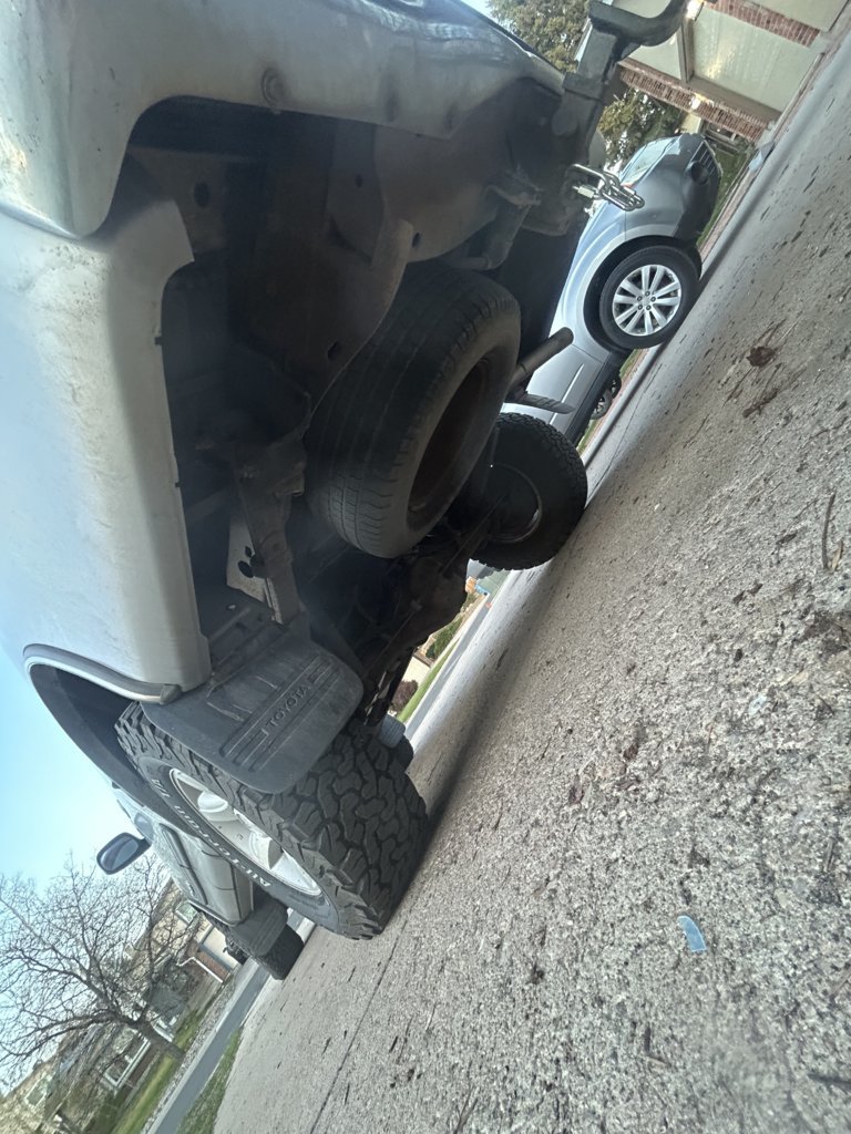

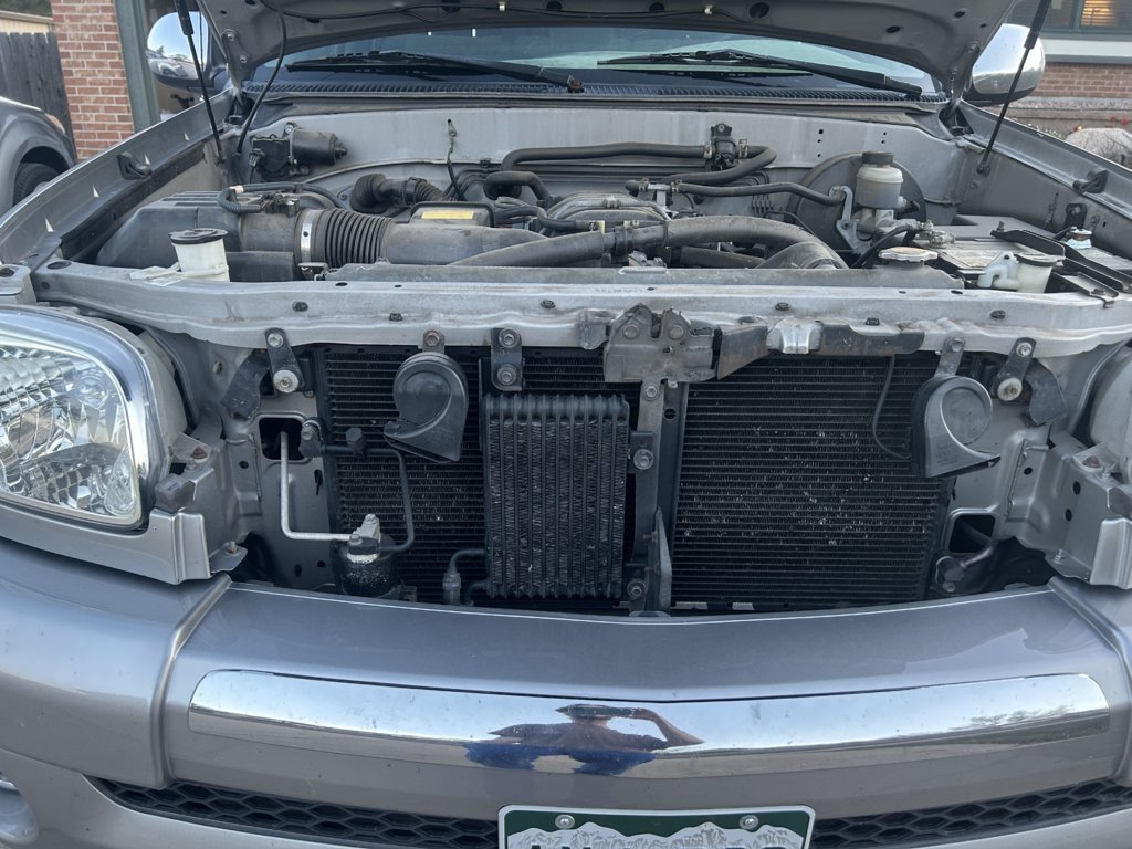

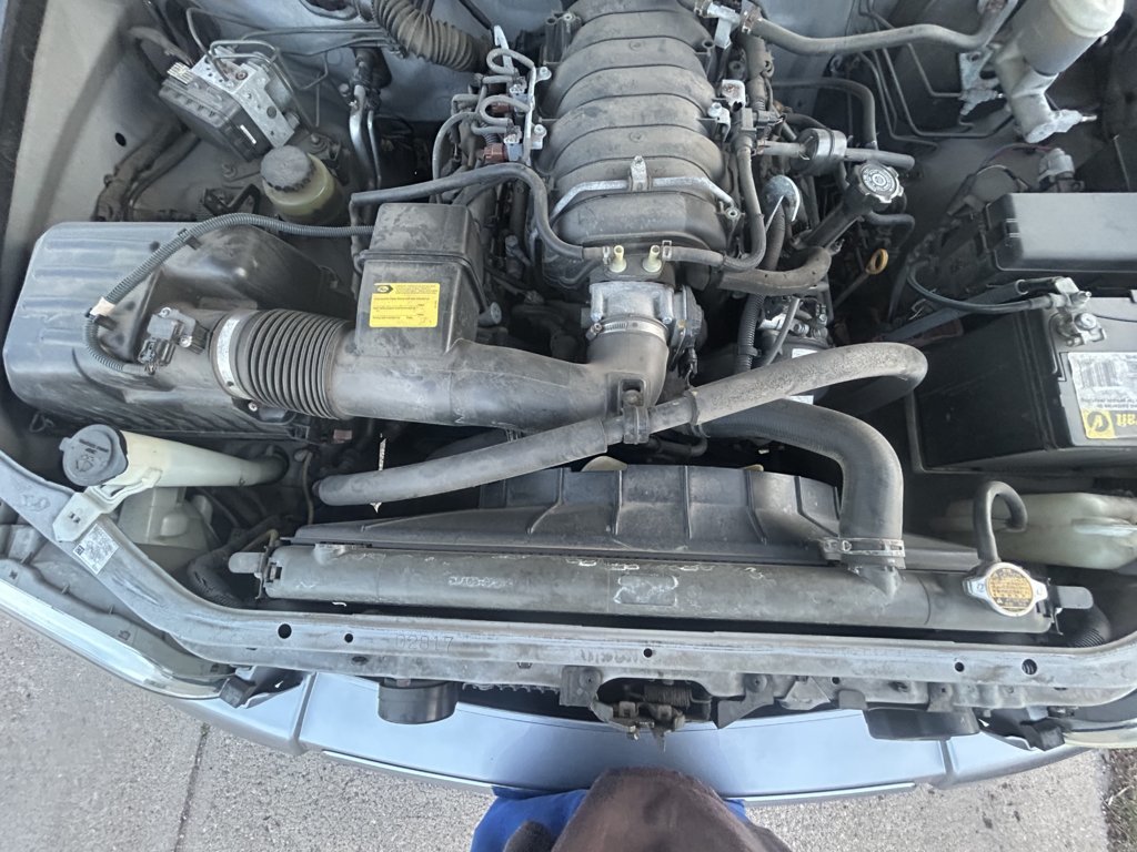

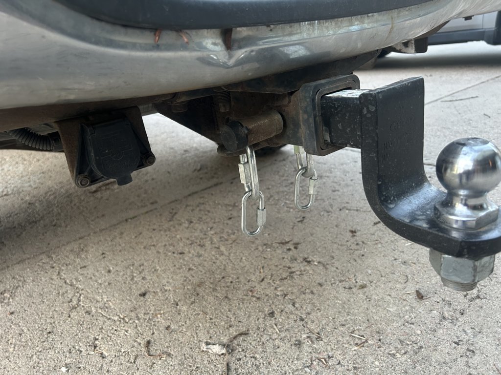

    Thank you for the info. Here are some pics:
  21. May 8, 2025 at 7:04 PM

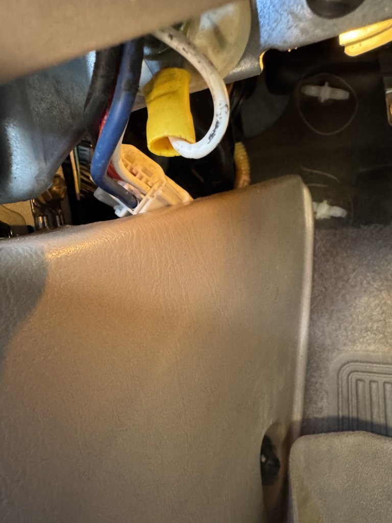

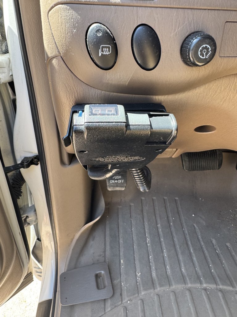

    Ok. It appears you have the towing package. I'll get under my dash today and show you some pics of where the brake controller plugs in, and how I've mounted mine.

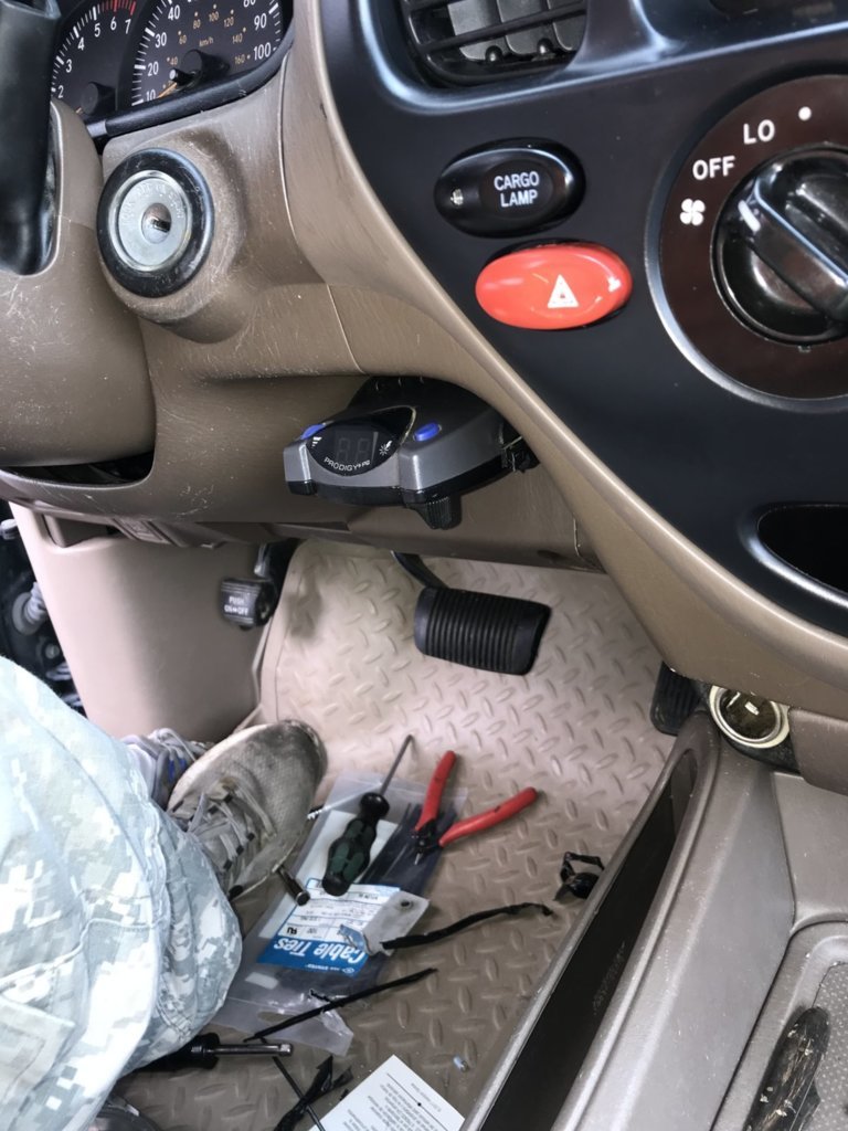

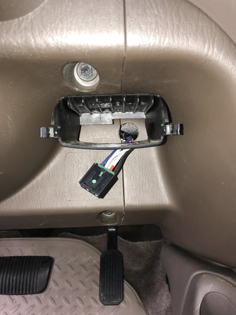

    Here's how my brake controller is hooked up. No cutting of wires, it's plug and play. I can't imagine it being any different on your '06.

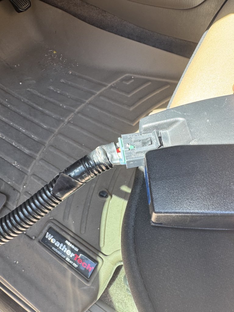

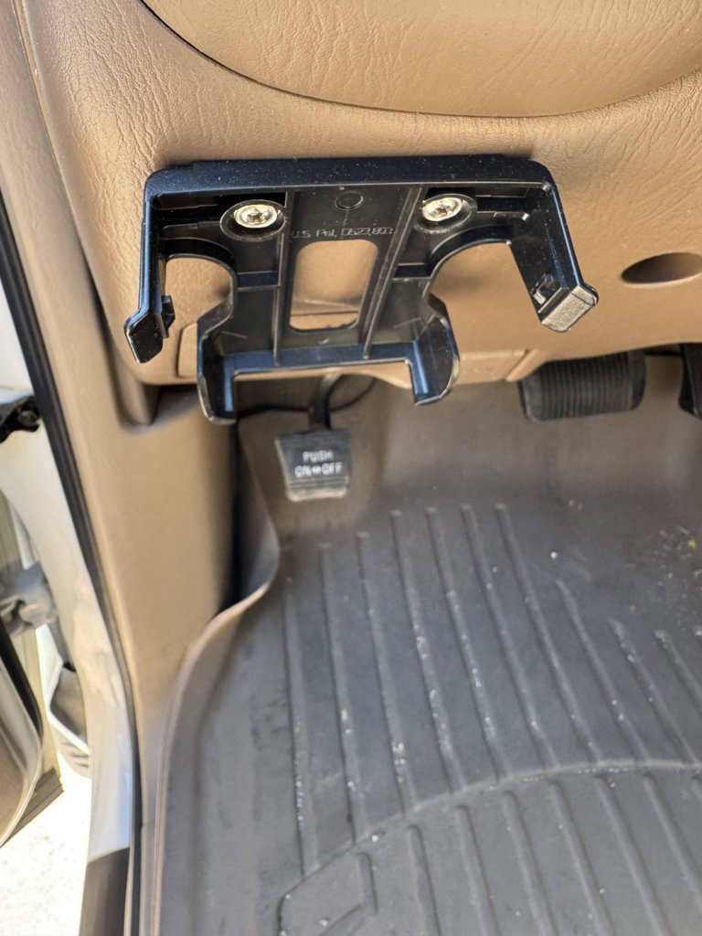

    4.56 gears depending upon the tire size. If you have the little 245/70-16 tires, then 4.30 gears should suffice. If you have larger tires, then yeah, probably 4.56 or possibly even 4.88. I’d recommend a pair of firestone airbags in the back as well.
    This is where i tucked my brake controller-

    As others mentioned, it looks like you have the factory tow package, look for the brake controller pigtail somewhere in the truck (glovebox maybe), with any luck it’s still kicking around. With that it’s easy to add a proper brake controller and you’ll be good to go, I’ve got that and have towed trailers with ebrakes and stopping was like they weren’t even there.
