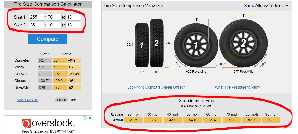

    Question, did you recalibrate your speedometer for the bigger tires? If not you are going much faster than your gauge shows. I plugged the stock size tire for most tundra in and then a 35" on a tire size calculator. If you are on 35s and haven't recalibrated then when your speedo says 70 you are actually going 76.3 MPH. Your Odometer is also going to be off. You are going further than it says.
    Here's a link so you can plug and play on your own. upload_2021-6-21_8-26-0.jpg
    In conclusion:
    • Gassers rev when they tow. This is normal.
    • Tow/Haul will make the truck run in lower gears for longer. This is intentional to keep the truck in a good power band for towing.
    • Recalibrate your speedo
    • Slow down. Owner manual says not to tow much over 65 MPH (that means your uncalibrated speed should read 60 MPH)

    good info, I have not re-caled, would probably be beneficial! I'm not trying to win any races trust me lol, just wanna be able to hang around 65 and feel like the truck is struggling, but I guess that's just normal. I don't know how other gassers are yanking 30 footers behind them, I thought for sure a 3600 pound 21 footer would be easy money behind the truck..

    With no recal if you want to hang around 65 MPH you should have your speedo at 60. That said, your truck isn't struggling just because it's running the RPMs in the 3-4k range. That's normal towing RPM on gas.
    You could also regear to 4.88s for your 35 inch tires. That will put you closer to stock ratios and get back some of that power you lost upsizing.
