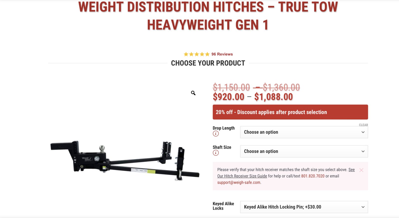

    Actually the WDH that I got is a Weighsafe Unit. It has stiff bars, It was the only one they offered many years ago. Now is it called their HD model.
    It has a rating up to 15,000 lbs. I probably would have gotten their Mid range hitch (8,500 lbs) if I was buying today. I just don't see any need to change it since the Tundra seems happy towing my trailer in this configuration. There is some discussion on the effects of a hitch that is too stiff causing damage to the trailer but my trailer is doing just fine after 4 1/2 years and 2 different trucks.
    The hitch capacity is one part of the equation. Is the trailer 10,000 lbs that this Ridgeline owner got or are we talking about the hitch?

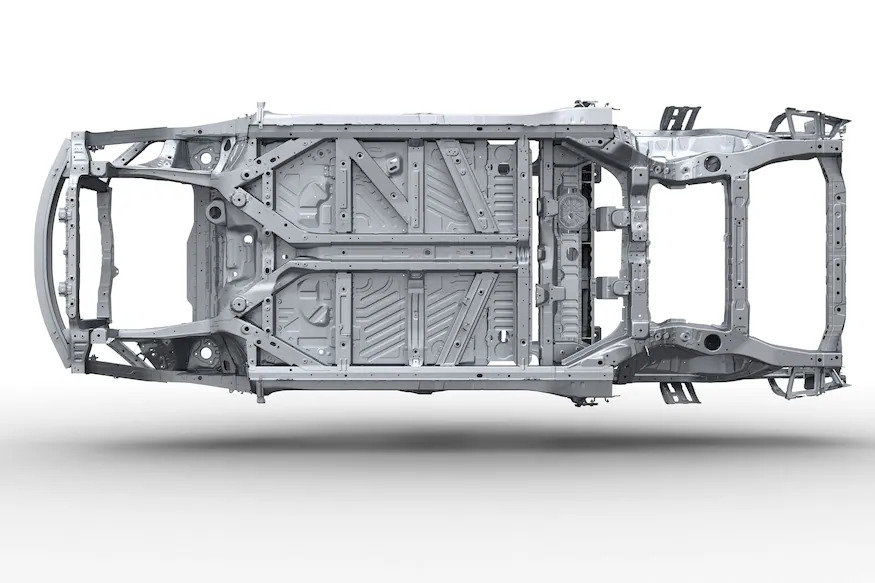

    Oooooold point of discussion... But you can only put 1000 lbs in the bed or it will die an ignominious death, according to the manual. I've had [censored] more pounds than that in the bed of the tundra and it just don't care. Heck, my daily load out is more than that. I've driven down the road in a Honda minivan loaded to the max; I've driven down the road in a tundra loaded to the max. 11 times out of 10 I'll take the tundra.
    Also, that picture is the definition of a unibody... Unibodies doesn't overload gracefully like body on frame do, so they have to keep the tow cap where it's at to keep FOS reasonable.
