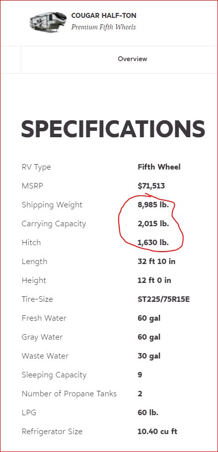

    upload_2022-4-12_20-51-53.jpgI appreciated all comments to my post. I didn't know I'd be opening a can of worms but here is what I've found so far. A Cougar fifth wheel model 29MBS(Specs below). In a 5.5 size bed will work very well with a pullrite super Glide 3100 hitch it should be able to handle pretty fair considering the Platinum i-force can two a combine gross weight of 17250lbs.

    You need to look at the payload, not the tow capacity. That hitch weight listed is likely lower than reality, because that's a base camper with no options and no propane, batteries, fluids, etc. Even if it's dead on for the pin weight, that comes directly out of the payload rating of the truck, and so does the hitch and any options added to the truck plus the passengers. If your truck has a payload of 2000 pounds (as a platinum it won't have anywhere near that) that would leave you with less than 400 pounds for passengers, hitch, camping gear, floor mats, etc.
    You will run out of payload before you ever get to the tow rating or the GCVWR. If you want a 5th wheel that size you need a bigger truck to stay in limits. If you don't care about the limits, then asking on here wasn't necessary.

    Read through my post on the first page of this thread. The 5th wheel you're asking about has 309 more hitch weight than the one I used as an example.
    Plus, you have at best a payload rating of 1,720, so just dry weight (not including putting anything at all into your camper or even including options or packages you might get with that camper) leaves you an available payload of 90 pounds. So unless it's just you in the truck and you have absolutely nothing in the truck with you, not even a Big Gulp, you can't weigh a pound over 90 pounds in order to not exceed your payload capacity. Every pound you're over payload, you're a danger to yourself, everyone on the road, and your truck itself.

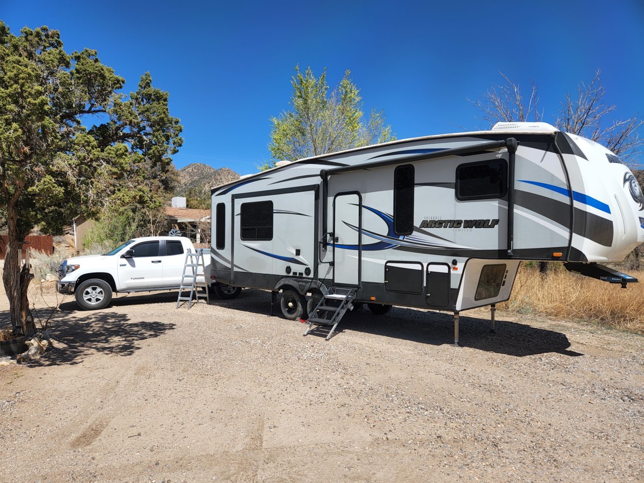

    I tow a 5thwheel with a tundra, 8.3k with 1400 hitch. A superglide hitch or a sidewinder-reese revolution set up would work great on a shortbed. If you have any leads on a frame mount kit for the 22' please let me know. The fiver you posted is a bit big for the truck imho, maybe look at some 28' units and watch that hitch weight.
