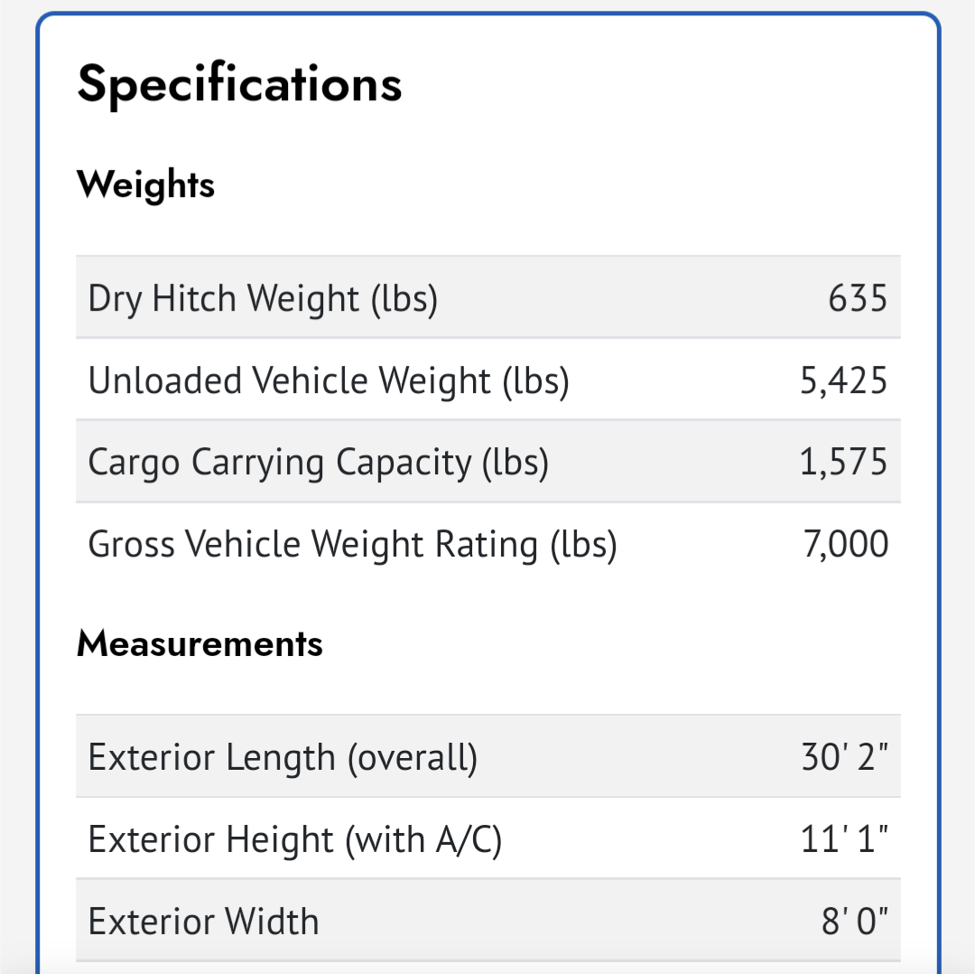

    This thread does have a me a little nervous based on how strong some of these responses are about 1/2 ton towing. I'm also not feeling warm fuzzies about these bent hitches.
    We bought a Jayco 267bhsw (30ft overall) early this year. I have had it out on 4 trips, 3 of which were about 2 hr drives. The only time I feel nervous at all is descending windy canyons. I've learned to manually drag the trailer brakes on the really tight corners. I think the issue is the trailer is succumbing to gravity and wanting to track straight so it tends to push laterally against the back of the truck. I have not experienced a loss of control even for a moment. I was running an Equalizer, but I had some concerns about it's age and condition, so I bought a similar design Huskey brand that also has frictional antisway.
    I usually tow 65 on the interstate. Wind drag is definitely the culprit for reduced mpg. 8-10mpg. I've see it as high as 12mpg when we had cooperative winds and clear roads.
    I learned quick that my truck will not hold 6th on the highway due to wind drag. I switch between s4 and s5 to keep the torque converter locked, shifting to a minimum, third priority is RPM/mpg. The highest trans pan temps I've seen are around 220 after a long, 3rd gear effort up a well known climb. I do run a secondary trans cooler plumbed in after the factory cooler.
    Trailer specs:
    Edit: my truck has sumo springs (black) and a TRD rear sway bar. I was running load range D tires, but I've gone to P rated tires to combat a vibration issue (still unsolved). Haven't towed on them yet.

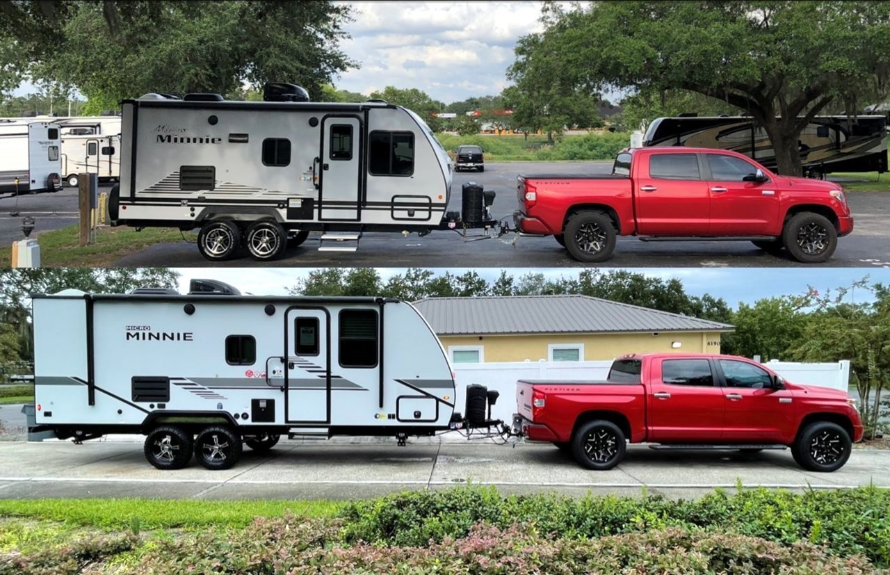

    2021 TRD Pro Lunar Rock CM
    Sorry to hear the Apex didn’t work out (I had a feeling it may be a little lower on the quality food chain) and I agree that 26ft overall is a good place to be with our Tundras. Looks great - enjoy!!

    Very interesting how the WDH correct height affects how the Tundra drives, it definitively feels more planted and stable
