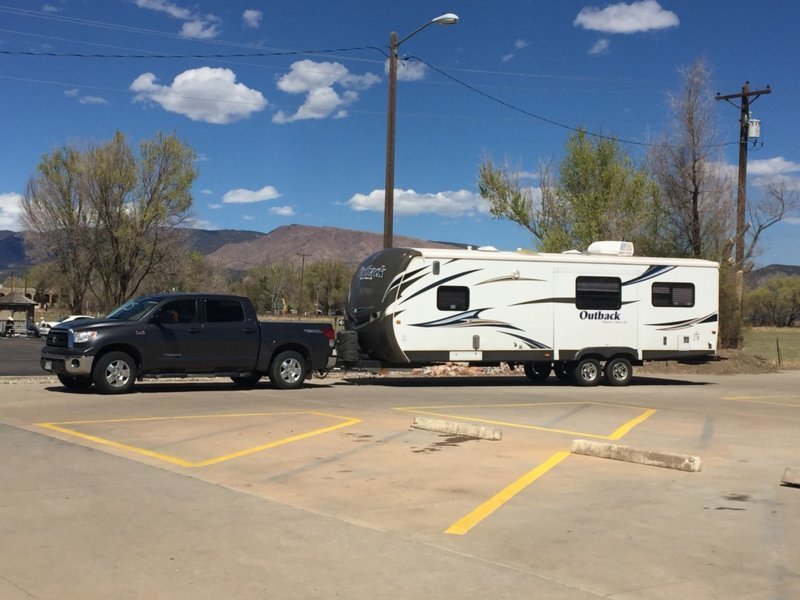

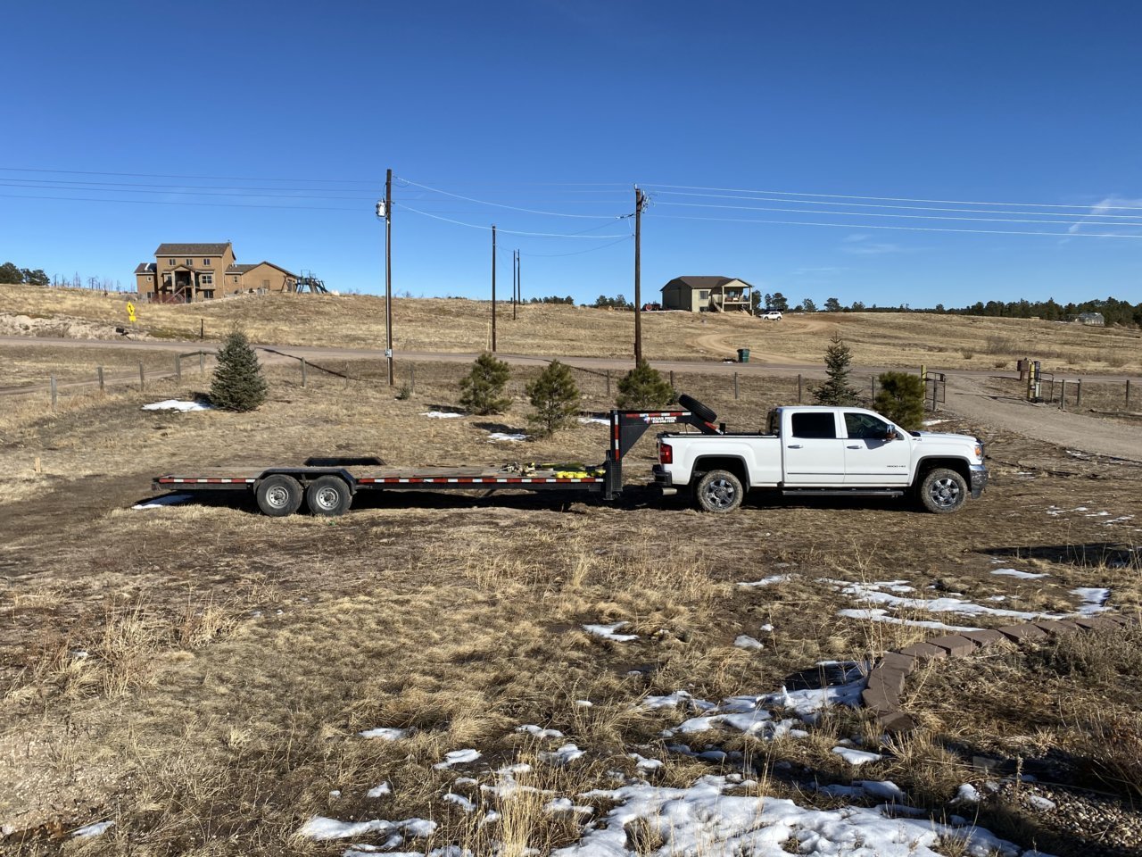

    That's a lot of ass behind you. Sounds like you plan on something a little smaller which is probably a good choice.
    This is 28' (32' overall) behind my Tundra. It was a lot for it in my area.
    Another view of what 28' looks like...

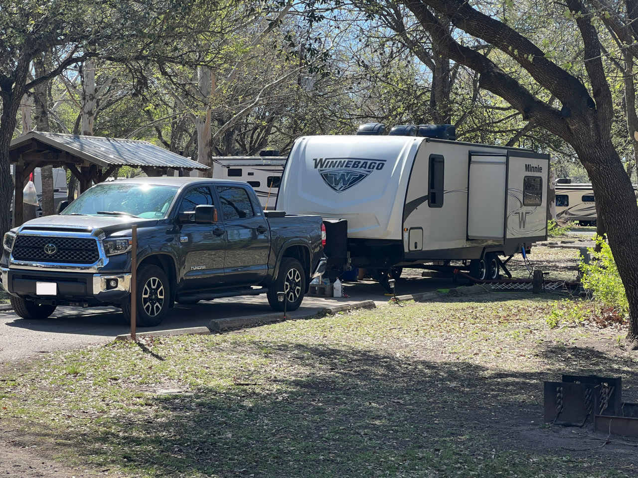

    With judicious loading and balancing, it's doable. We have a 2019 Tundra Off-Road 4x4 and we pull a Winnebago 2401RG (Dry Weight 5,220 lbs./GVWR 7,000 lbs./Hitch Weight 650 lbs.). You do have to be VERY careful on the payload as it is easy to blow past the pitifully low one the Tundra has. Recently took a trip to the Hill Country in Texas (Blanco to be exact). Other than an issue with the IBC overheating the trailer brake hubs if the gain was turned up over 3.5 we didn't really have a major problem, even with the 30-40 mile an hour winds going down and coming back (other than the normal you get even with a 3/4-1 ton truck). There is NO way I'd go any bigger than this as it's really easy to blow past payload.
    Averaged about 8mpg going down (dragging brakes culprit) and about 9.7 coming back (IBC adjusted so minimal drag/heat on brake hubs).

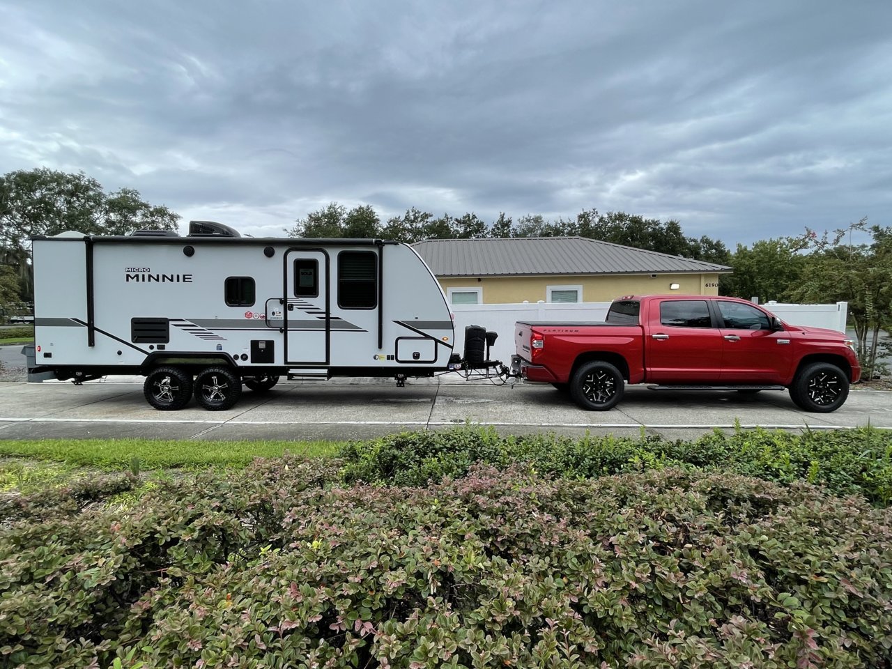

  11. Jul 26, 2022 at 2:55 AM
    #41
    Retired...finally
    Retired...finally Utilizing that doctorate of procrastinatory arts
    Aug 6, 2021
    #66426
    3,466
    Dan
    2021 Barcelona Red SR5 Crewmax
    Custom bug spat pattern hood, grill & bumper. Dead Live Oak leaf collection under hood, cowl and lower fenders. Beach sand custom floor covering.

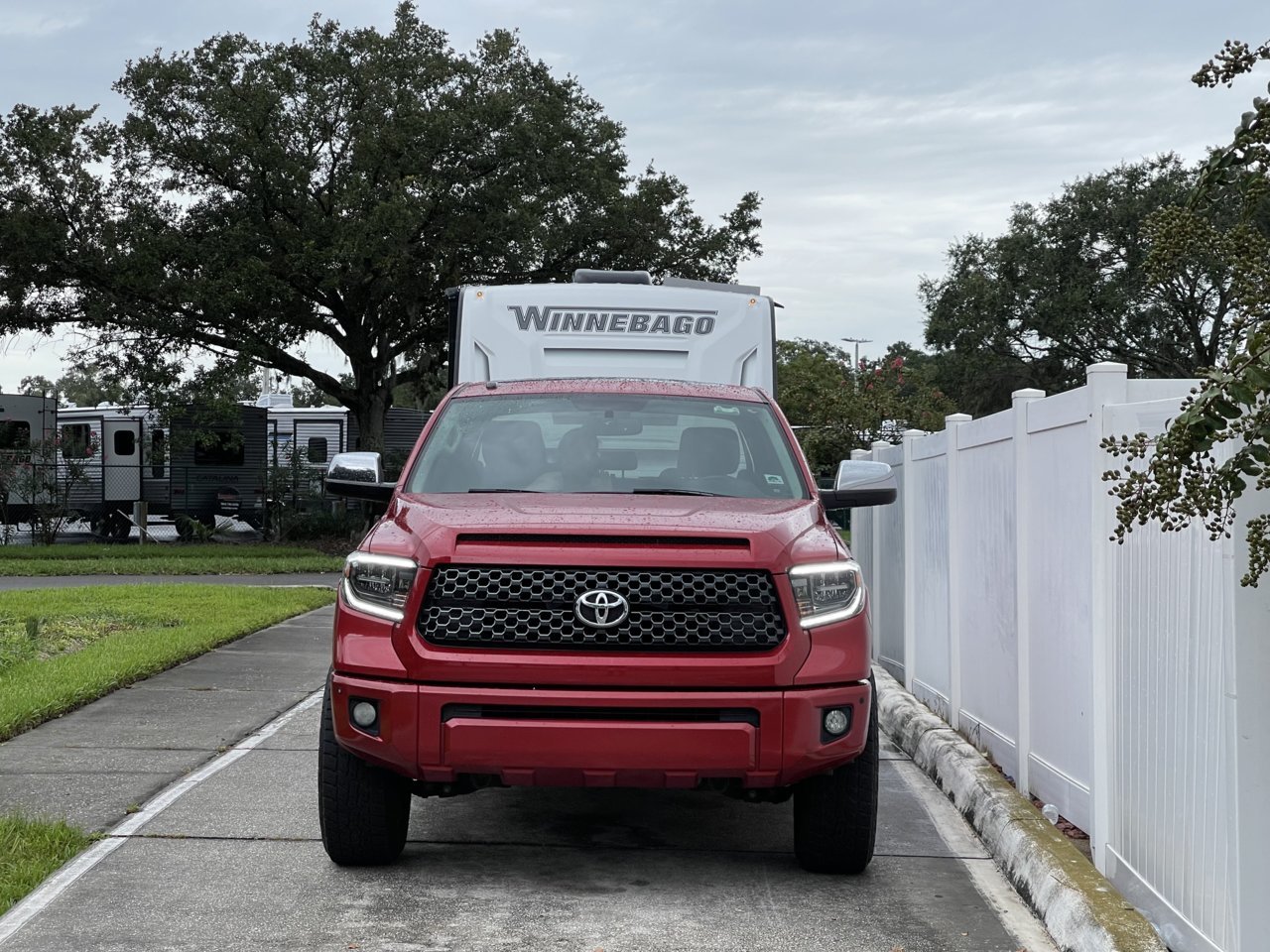

    Who set up your WDH? Seeing a set up like that on the highway is no fun when we are towing. We can't point and say, "What idiot set that one up?".
    Regardless, it looks to be about as close as you can get.

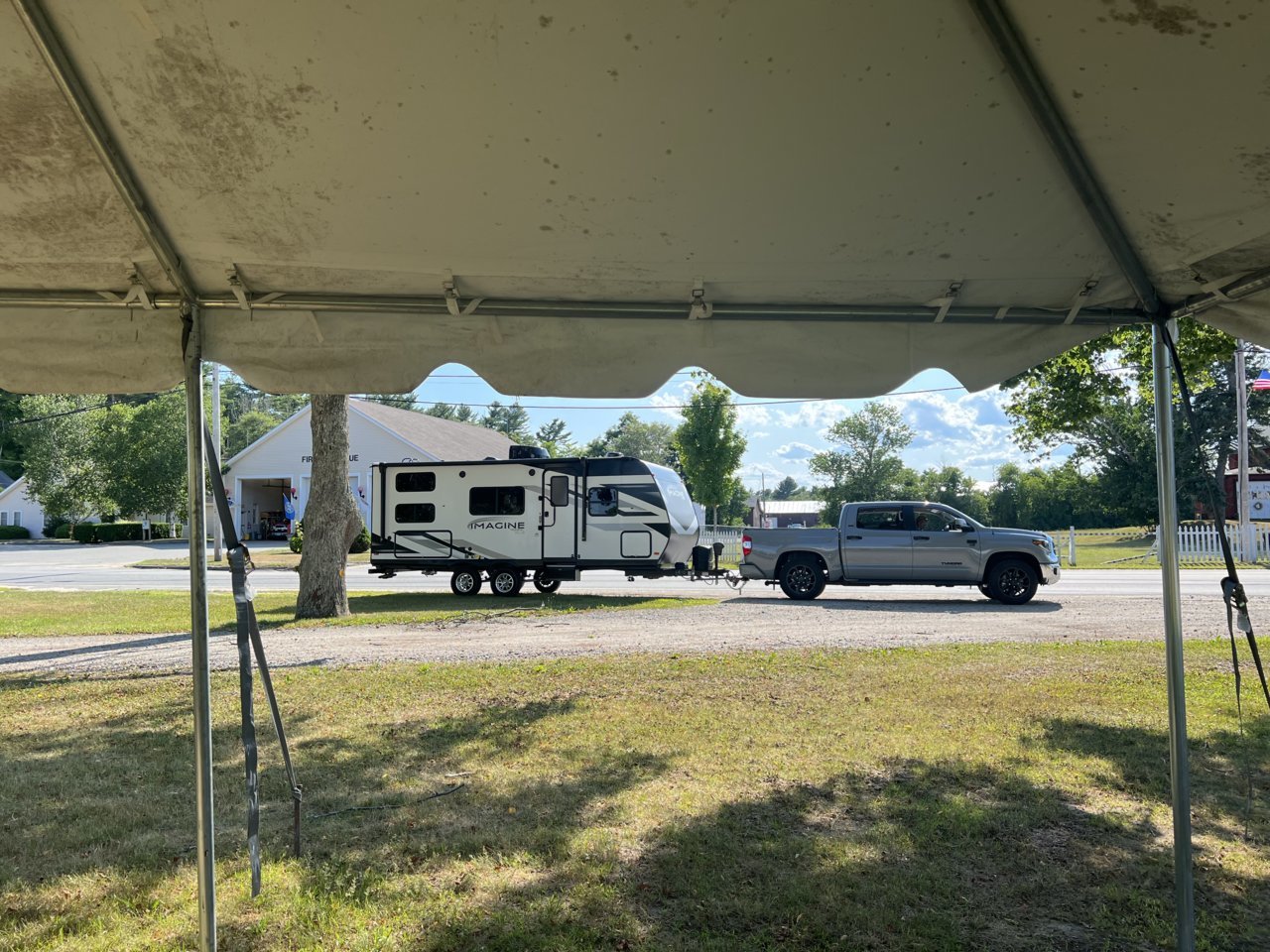

    Towing a 29' Forest River cruise lite. 5900 Dry, figure 6900 loaded. Through NY, VT, NH and Maine some hills and mountains. Stay at or below 65 mph. Rig handles well. I do have the TRD rear sway bar and upgraded the tires to Yokohama Geolander G015 AT in the XL load range, gives 300 lb more per tire. Run 50 PSI in rear 40 in front. Also have ScanGauge 2 to monitor trans temp on my 2021 Platinum. Have towed multiple travel trailers and had a cattle farm with Gooseneck Stock trailer and 25 ft dove tail flatbed for hay. Had Ram Diesels in 2500 and 3500 variants. Net Net - I would not go larger in terms of Travel trailer than what I am towing now, just personally speaking. If we want a larger rig than a 2500/3500 would be in my future. My loaded weight is close to the max with my wife and 2 60 lb dogs plus the bed loaded and trailer loaded. Good luck on your decision.

    Jun 22, 2021
    #64642
    557
    WA
    2021 1794 TRD OFF ROAD
    I think his point was that it was set up so perfectly that we can't point and laugh at a poor WDH installation job. He can confirm. :D
    It looks to me to be one of the few that are properly set up. Both truck and trailer appear to be level.
    Malinois38[QUOTED] and GODZILLA like this.

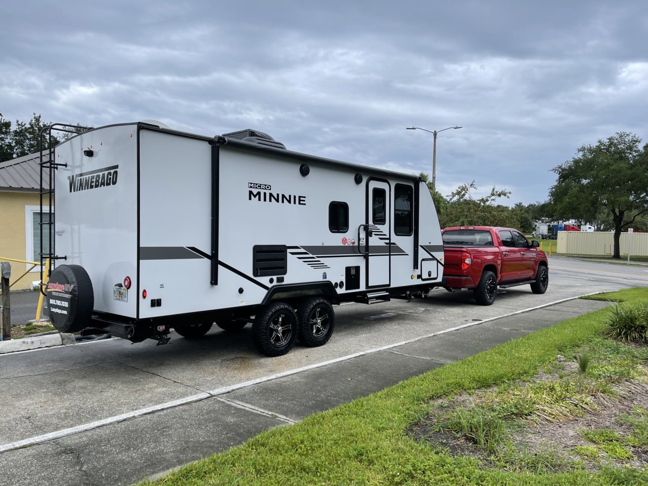

    Well dudes and dudettes, based on the feedback here, and also my *super objective* gut feeling, we went with the 26ft total lenght Winnebago Micro Minnie 2306bhs.
    We took the time to visit dealers and see the Apex Ultra-lite 276bhs (a 30ft long but low 10.5ft tall) and the bigger and taller Winnebago Minnie 2301bh (30ft long and 11.5ft tall). Bottomline, super dissapointed with the Coachmen unit, laminates were already coming off, everything felt flimsy and even though layout was amazing for a 30ft, we are used to a different quality level and we know things will break so seeing that low quality from the new lot was a debbie downer. The bigger Winnebago was just too tall too big it felt. So we went smaller, narrower, lower and still get a couch plus dinette, bunks and a full bathroom.
    It tows amazingly, I think even better than my old 22’. Its a big longer so it feels less nervous? And set the WDH properly so now everything sitts super leveled and its hard to explain but I feel like both truck axles are planted to the ground. Before I felt more weight on my back axle. So all and all great sweet spot the 26’.
