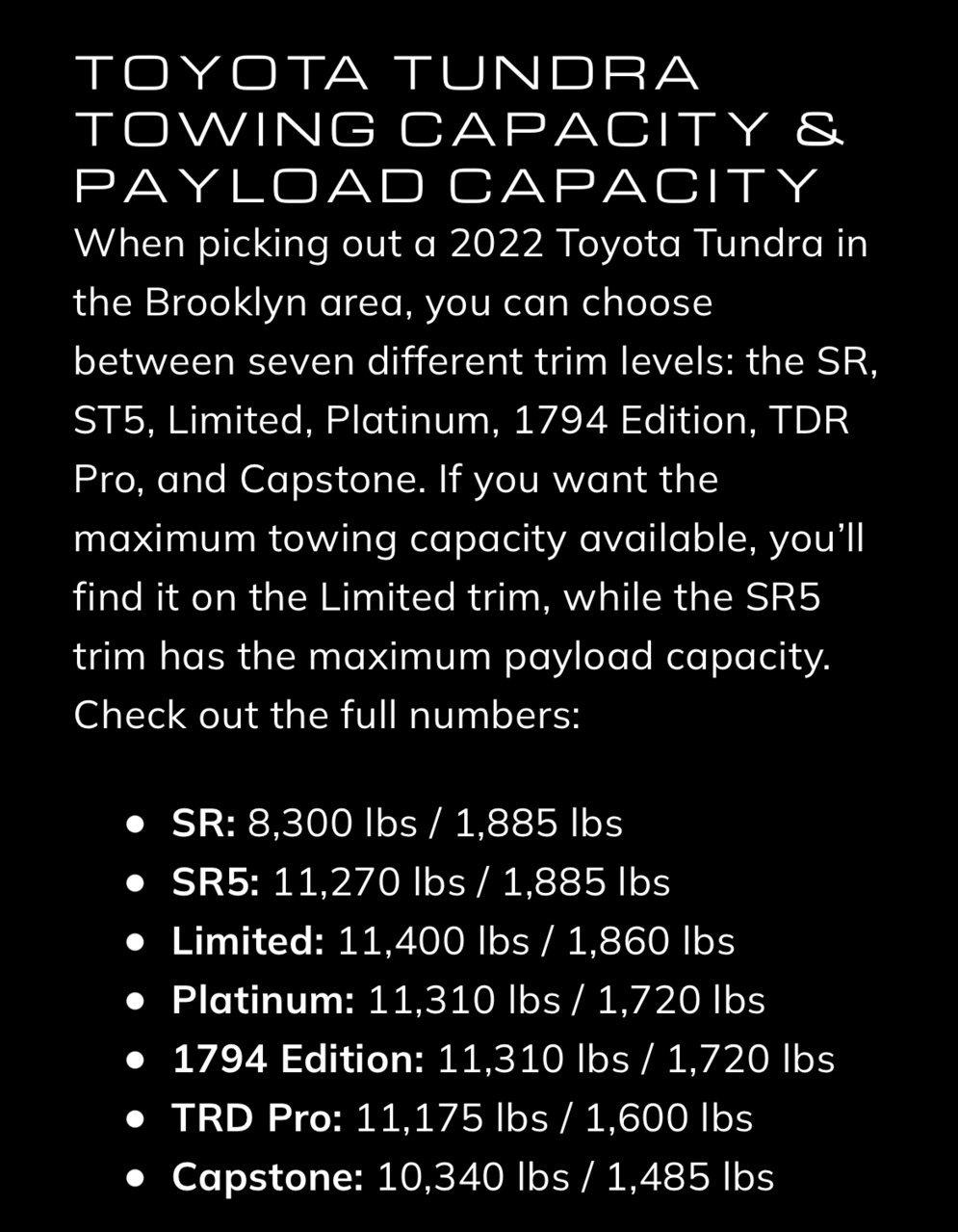

    The payload rate ratings make no sense on These Tundras. The SR “should” have the highest payload based on the brochure but most of the door stickers are the same or much lower. Sorta a mystery

    You can compare the two models side by side. not much payload difference from an SR to an SR5. No brake controller available on the SR. Same brakes. Same trans. Same ratios. Same rear axle. Depending on which cab config you bought, your payload will be lower than the max 1940, which is a mythical beast.

    I have the double cab SR so it should be closer to the max payload but it says 1500 on the inside door sticker. That 1940 must be a myth or the sticker is wrong
  8. Mar 27, 2023 at 7:03 PM
    #38
    KNABORES
    KNABORES Sarcasm incoming
    Jan 1, 2020
    #40572
    14,300
    Arkansas
    Even the published numbers for each trim from multiple sources fail to show what trim and config gets 1940#.

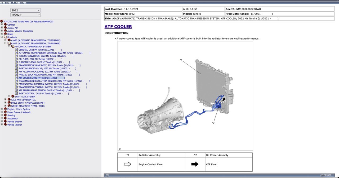

    so it does have the transmission cooler??
  10. Mar 27, 2023 at 7:34 PM
    #40
    KNABORES
    Jan 1, 2020
    #40572
    14,300
    Arkansas
    All of the diagrams I’ve seen show an in radiator cooler for all models.
    Markysharky likes this.

    KNABORES
    Jan 1, 2020
    #40572
    14,300
    Arkansas
  12. Mar 27, 2023 at 7:45 PM
    #42
    SR4x4DC
    SR4x4DC New Member
    Mar 6, 2023
    #93328
    51
    Toyota engineer said SR doesn’t have the trans cooler. I didn’t see it. If you find it please let me know
  13. Mar 27, 2023 at 7:48 PM
    #43
    Themechguy1
    Themechguy1 [OP] New Member
    Mar 26, 2023
    #94481
    11
    You got me worried now. :(

    Wow! Speechless! Looks like the SR has a trans cooler.

    The SR is only rated for 8300? They def de-tuned the heck out of it, toyota shouldn't do that, they didn't in prev gen. The SR still came with same v8 5.7 as all other trims.
