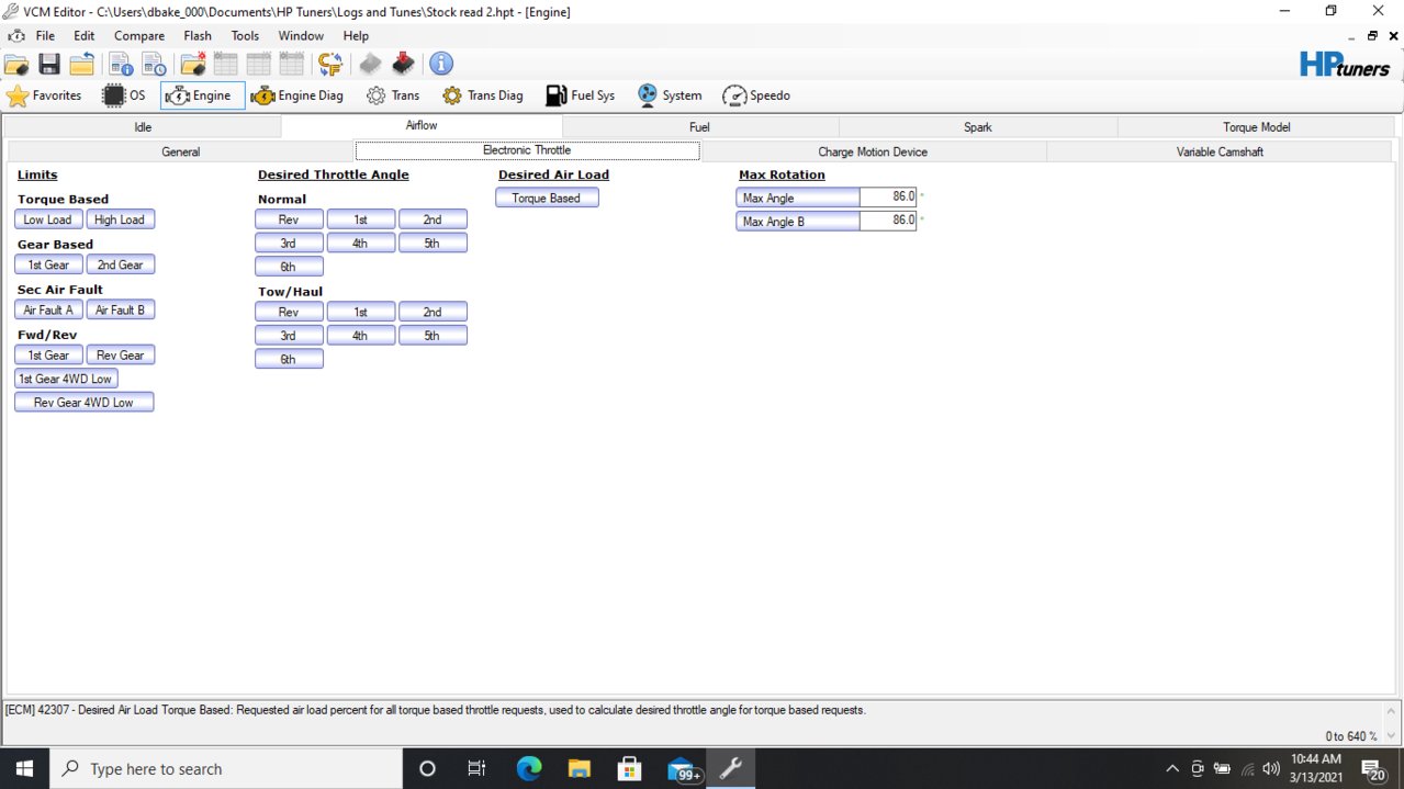

    Working on some tuning tweaks, figured I’d share for those curious about how it works.
    Throttle for normal and tow/haul

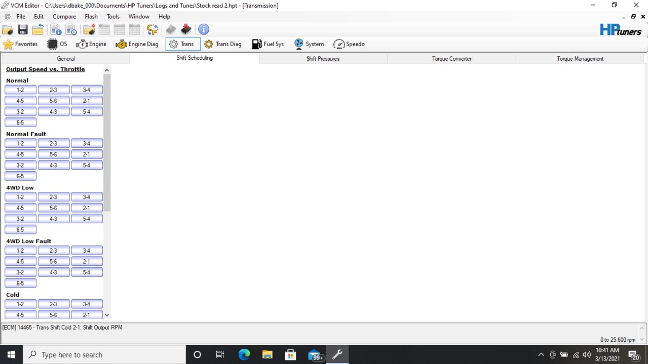

    Shift scheduling
    99673C96-EA65-49F4-A3FF-BEF687789E97.jpg DDE15141-1217-4F74-A143-84D7D5C9AB56.jpg

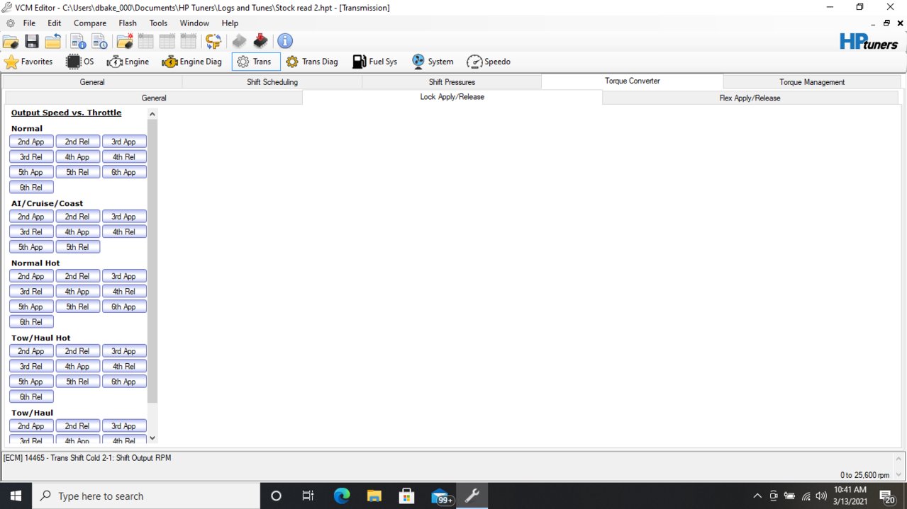

    Torque converter lock and release
    399F9477-BD1B-4A72-96BC-4119893D6FBB.jpg 7A307BFF-807B-48D3-88E8-A63211001C45.jpg

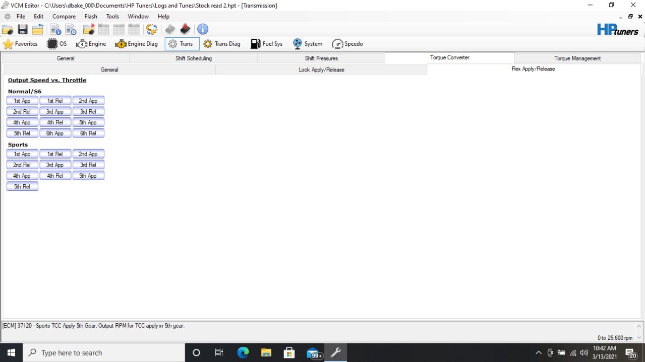

    Flex apply and release for normal/s6, the other is s1-5.

    I went and did a test drive and the it still seems to be in tow/haul mode even when I would switch to S4. I guess that’s good news!

    It’s not. I don’t want to touch the towing in S mode topic, but my owners manual says use S4 for engine braking, to provide engine braking and charging system performance. So slowing down, and S4 uses flex-lock to almost idle speed, so maximum engine braking. The biggest difference between tow/haul and normal or S mode is no flex-lock in tow/haul, it’s not good for towing and hauling. Lots of other changes also.
