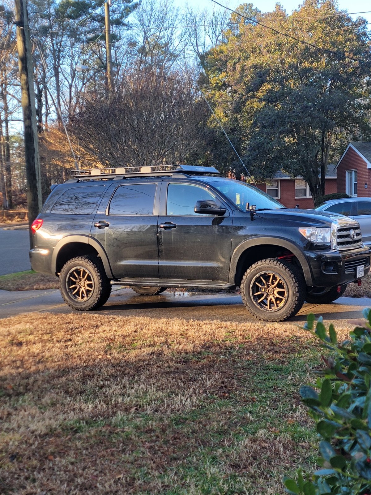

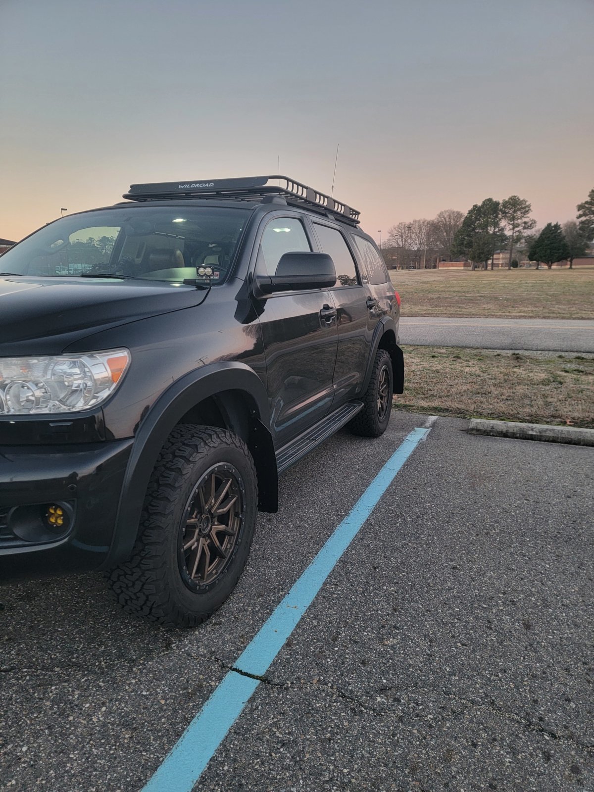

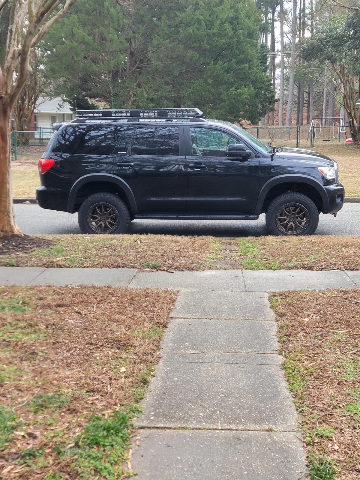

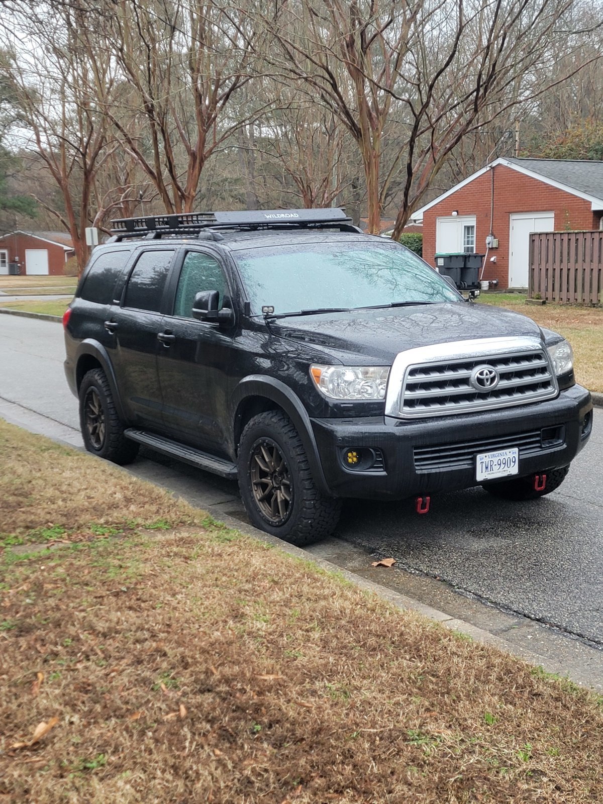

    Hello and welcome to my build thread. It's going to be garbage, rambling, and scattered at times. Between buying my rig in August and now, I have spent more money than my wife would approve of, and dedicated more hours building it than she is happy with. Luckily, there will be more posts to come!
    Rig: 2013 Sequoia Platinum. Black with red rock interior.
    I do not have pictures of the day I picked her up. I got a great deal on a VERY used, but well-maintained truck. The previous owner added a cheap, small roof top basket; 20" bronze, fuel wheels and KO2s; and LED low beams. He/she also removed the rear center console.
    The dealer added bushwhacker fender flairs so that the truck would pass inspection, and (I suspect it was the dealer) paid someone to touch up the driver door panel. Which led said upholstery expert to paint the front seats and front center console lid. It looks like crap, but I have not gotten around to fixing it.
    The first thing I did was the 120,000 mile service. ALL fluids and filters replaced--except transmission fluid... Long and uninteresting story. I will do drain and fills sometime in the next month or so. I also had them replace the spark plugs.
    Current list of upgrades:
    Exterior front to rear:
    - rough country tow hook, shackle mounts
    - Baja designs squadron sae, amber dogs
    - Baja designs S2 wide, spot lights as ditch lights (repurposed from my power wagon)
    - SDHQ ditch light brackets
    - Midland ditch light NMO bracket with Midland ghost antenna
    - black door handles and mirror caps (Amazon)
    - morimoto puddle lights
    - 50x84 roof basket (Amazon)
    - Midland mag mount CB antenna and 6db gmrs antenna
    - bushwhacker fender flares
    - rear bumper reflectors replaced with KC cyclone, white lights--hardwired as backup lights
    - full LED upgrade for rear lights (lasfit turn signal bulbs, auxito for backup, side marker, and stop lights; precision LED license plate lights )
    - agency 6 hitch shackle mount
    Suspension:
    -JBA upper control arms
    - freedom off-road coil-overs
    - jomax customs sway bar end links
    - wheelers super bumps with 3/8 spacer
    - tandem off-road airbag spacers
    - Bilstein 5100s in rear
    - timbren SES with 1" spacer
    - Dobinsons front diff drop
    Interior:
    - precision LED interior bulb kit
    - ICS center speaker mount with four bullet point mounts
    - hard wired phone charger
    - amazon TPMS
    - victory 4x4 center console molle panels
    - Midland MXT575 radio
    - Midland CB radio
    - GMRS switch for ghost and 6db antenna
    - Redarc trailer brake controller
    - S&W equalizer holster
    - Sig P365 xmacro holster
    - desert does it seat jacker (will add passenger side later)
    - replaced the missing, second row center console
    - oem trunk area, all-weather mat and dog retention stuff
    I'm sure there is more that I am forgetting. But, you all get the idea.
    Future adds (in no particular order):
    - power stop brakes all around with stainless steel brake lines
    - transmission cooler
    - talons garage skids
    - SDHQ hidden winch mount
    - tandem offroad maner mount
    - form 18-20 head lights
    - TRD pro grill
    - steering rack bushings
    - solid off road motor mounts
    - mud flaps
    - battery (I have an upgraded bracket built by a member here; and the SDHQ battery terminal kit already)

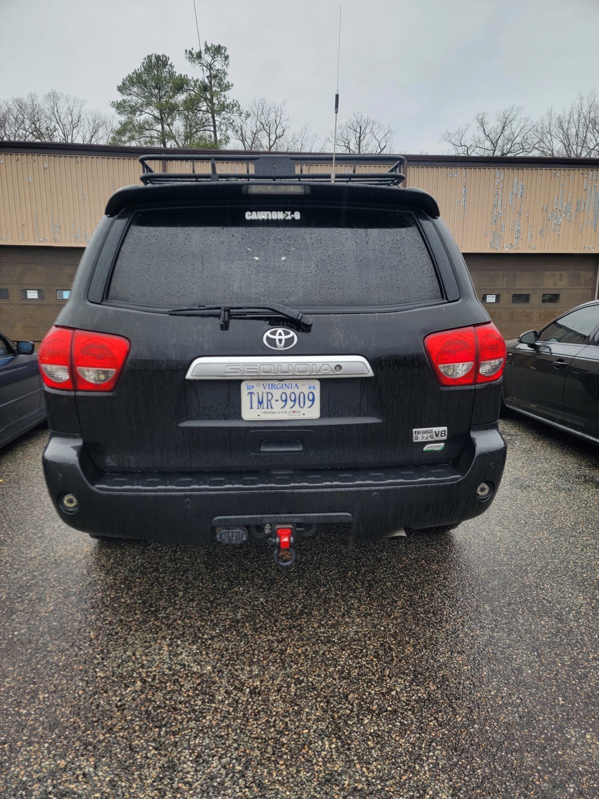

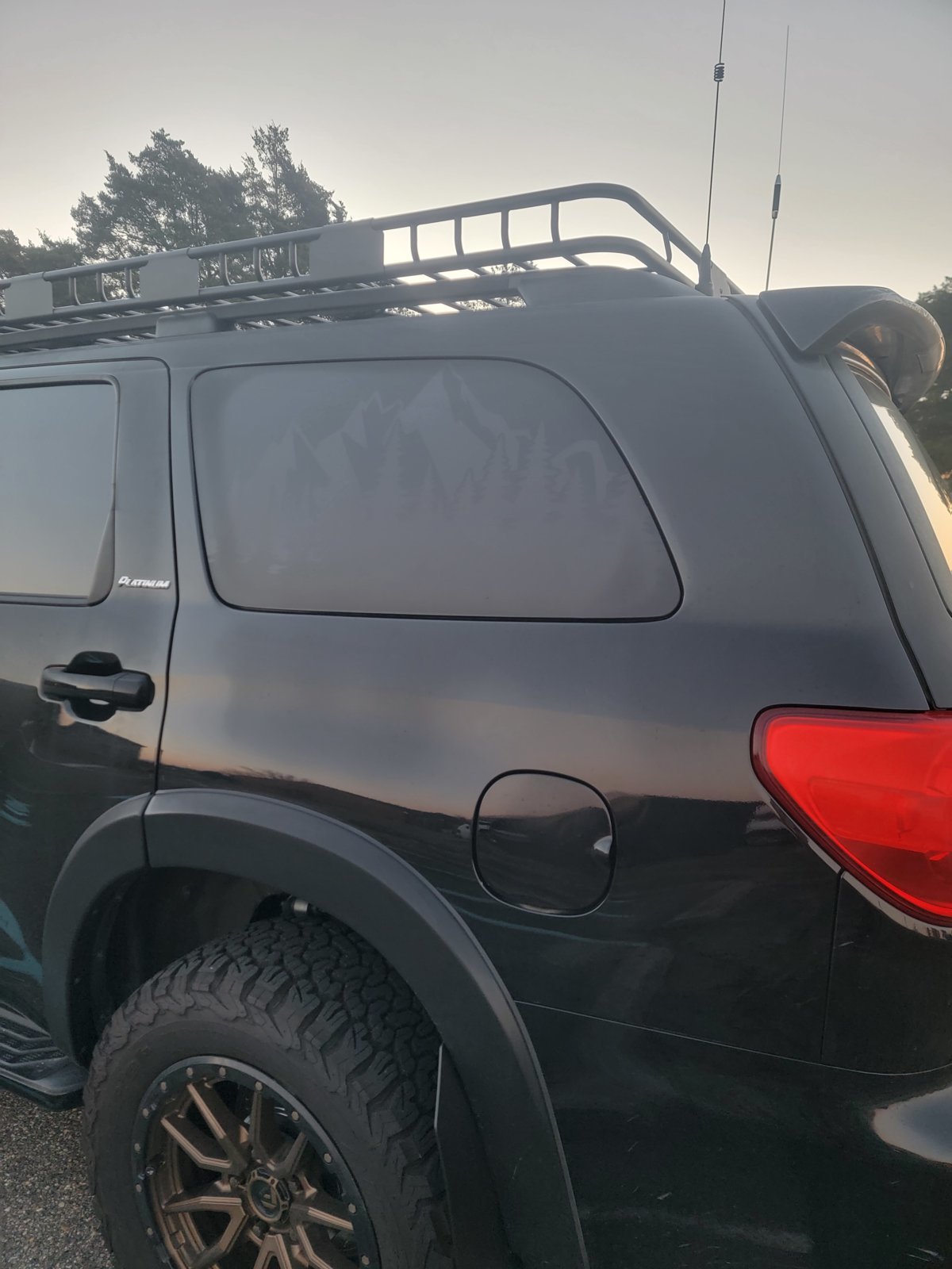

    Ok, now some pictures:
    20240106_095033.jpg 20240106_095047.jpg 20240119_103752.jpg 20240113_081109.jpg 20240106_095951.jpg 20240107_144505.jpg 20240118_054628.jpg 20240118_054648.jpg

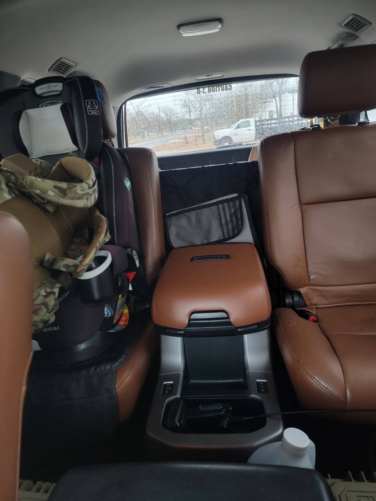

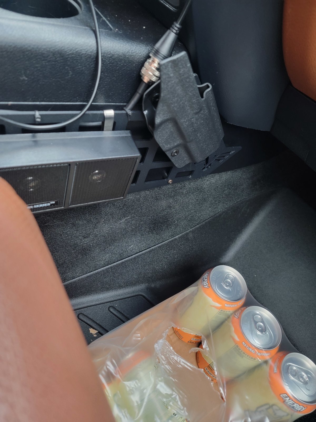

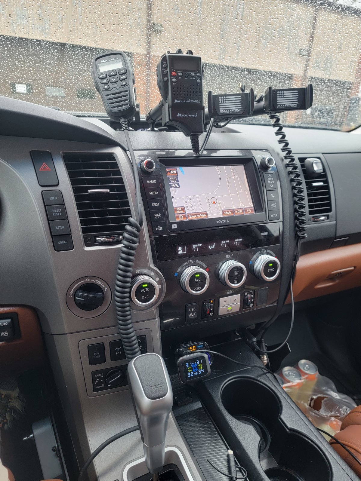

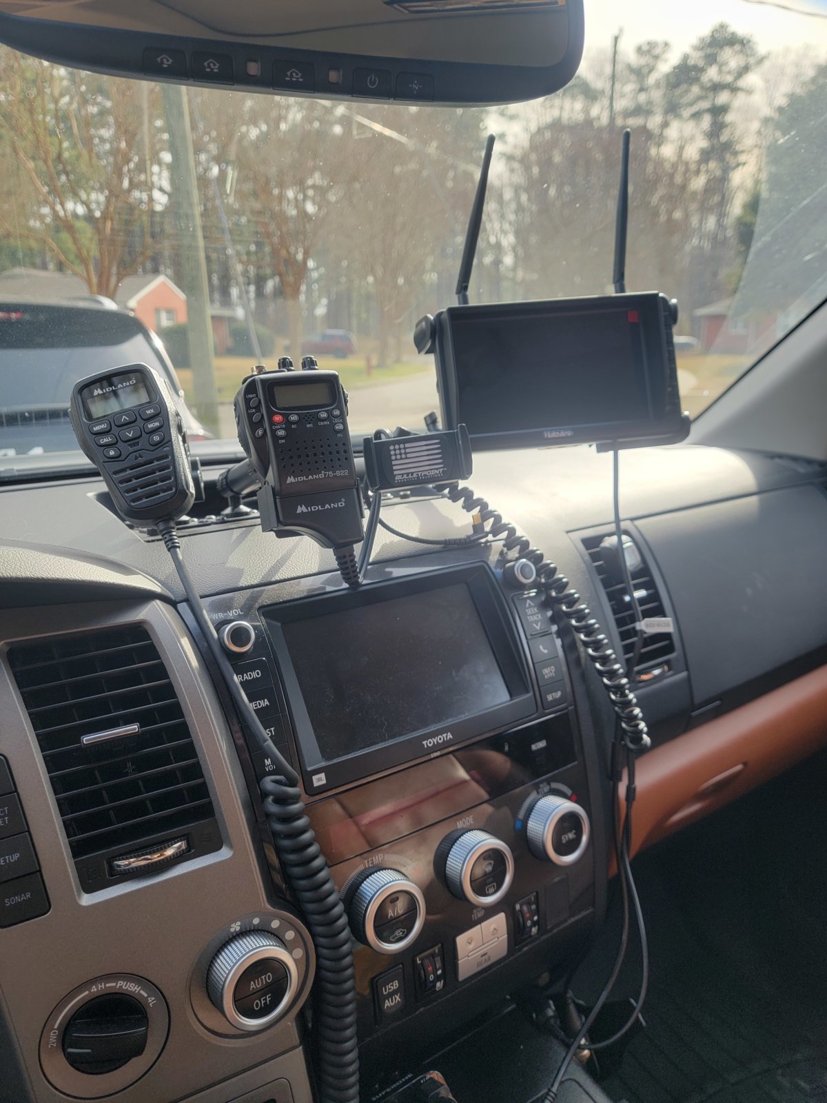

    Here are some interior pictures. You can see the various mounts, radios, and the 2nd row center console that I sourced to replace the missing one.
    20240106_095809.jpg 20240106_095909.jpg 20240106_095834.jpg 20240106_095930.jpg
    You can also see in this last picture what looks like a wrinkley finger. That is the seat and how the dealer-painted seats look.
    Again, I need to get around to fixing them.

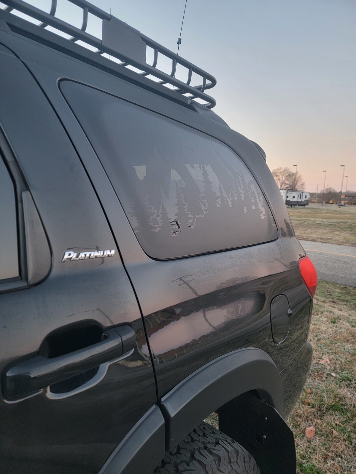

    The decals are tacky, but my daughter is 5. She will enjoy the install lol.

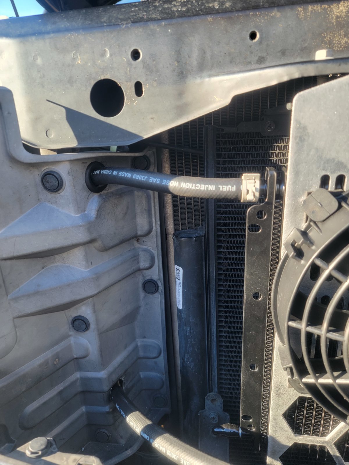

    It's another busy weekend. Received the parts to install a transmission cooler (with fan) and towing specific brake kit from power stop. Will also install stop tech brake lines and flush with Motul 5.1
    We pick up our travel trailer next weekend. So, I have to finish everything this weekend. Fun times!
    More pics coming during install.

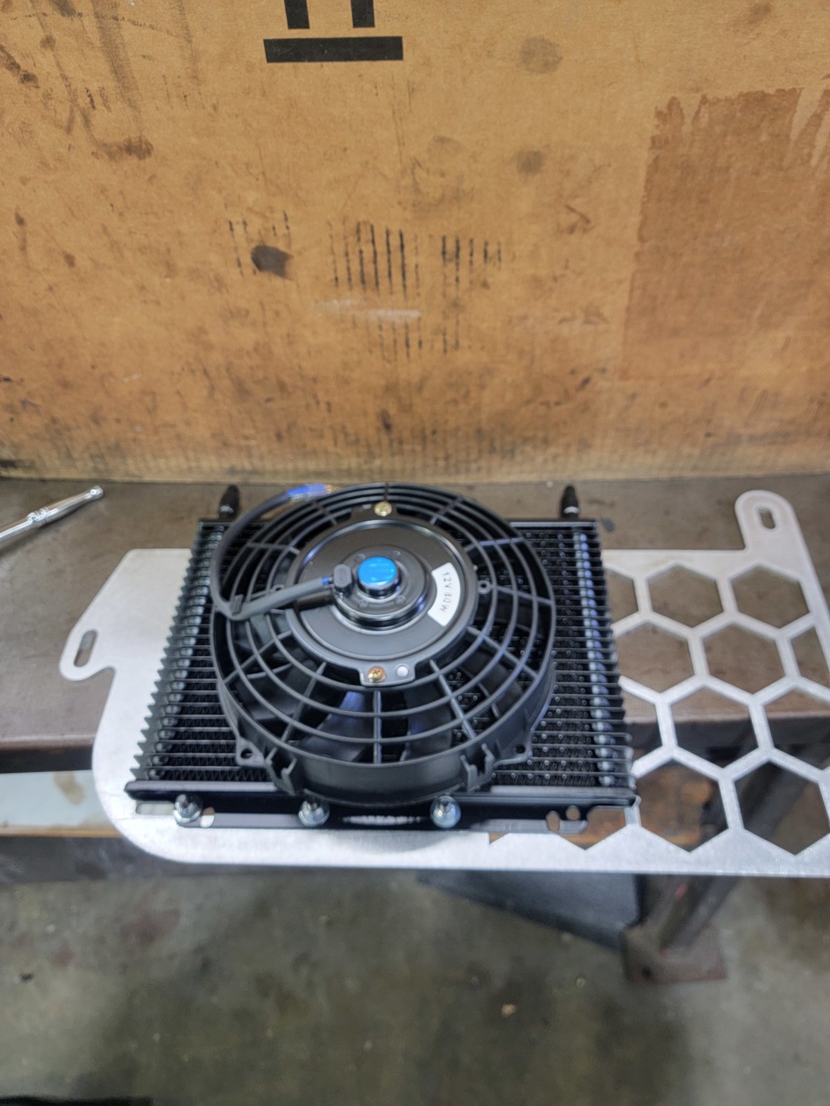

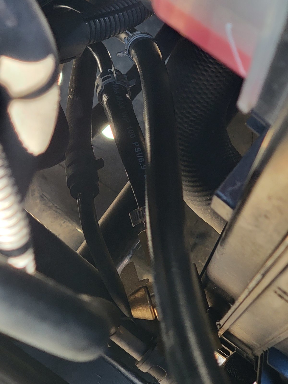

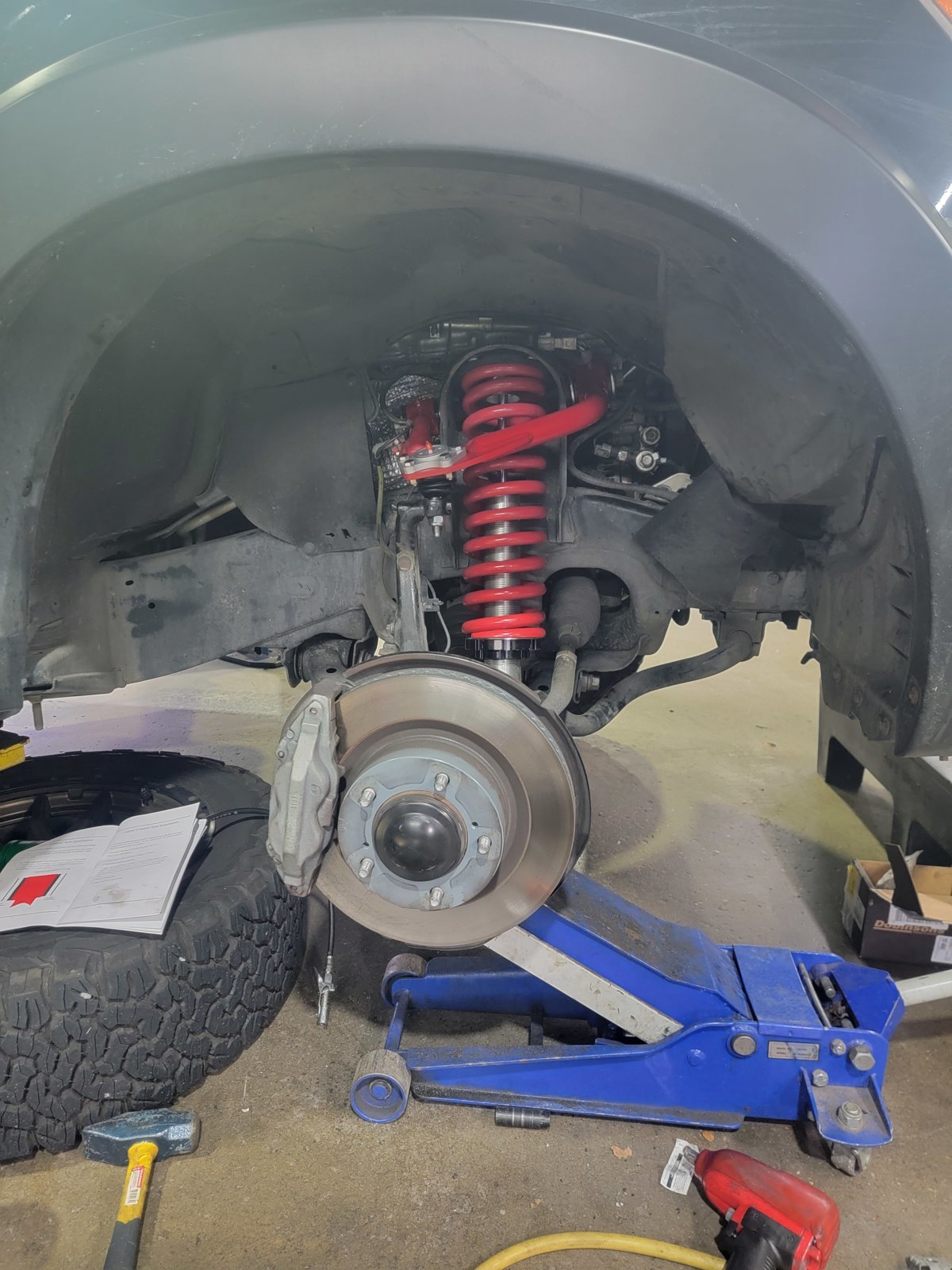

    Knocks out the brakes and installed the transmission cooler (did not plumb it though)
    Power stop rotors and extreme pads went on easily. The only surprise for me was the front calipers. I wasn't expecting a hard line to run from the caliper to where it mounts to the flex line. I took my time moving the caliper, without disconnecting, to remove and replace the rotor.
    I also briefing starts playing with the rear flex line to replace with the stop tech lines. Once I couldn't get a nut off due to bracket flex, i moved on. I did swap out the front flex lines to the stop tech lines.
    I'm owned a motiv pressure bleeder for years. It's always worked great-- except today. I had to use the universal cap and, once I had it pressurized to 15 psi, brake fluid steadily flowed all over.
    Once I figured it out, by shear luck, I was able to flush the fluid and bleed the front calipers.

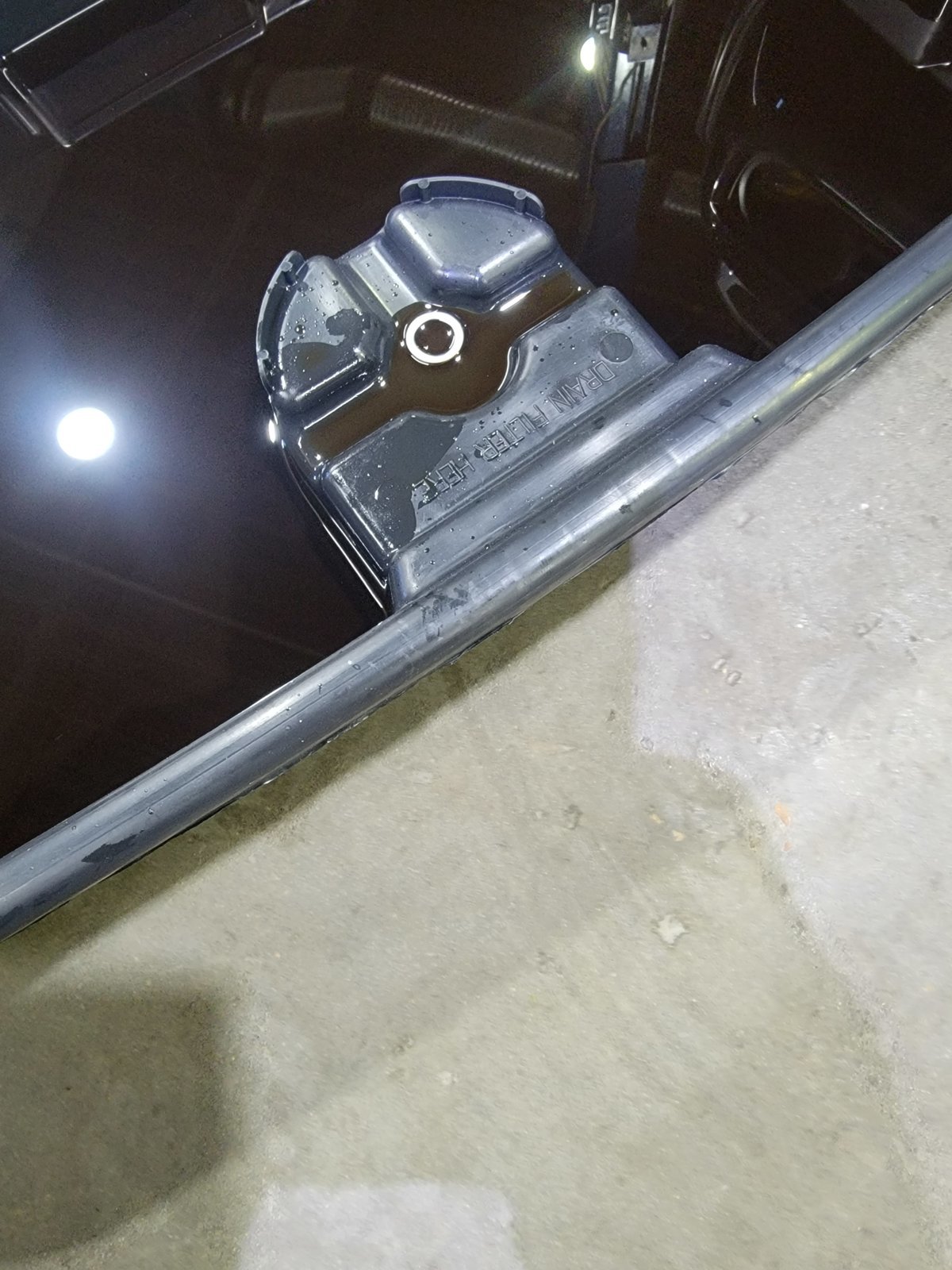

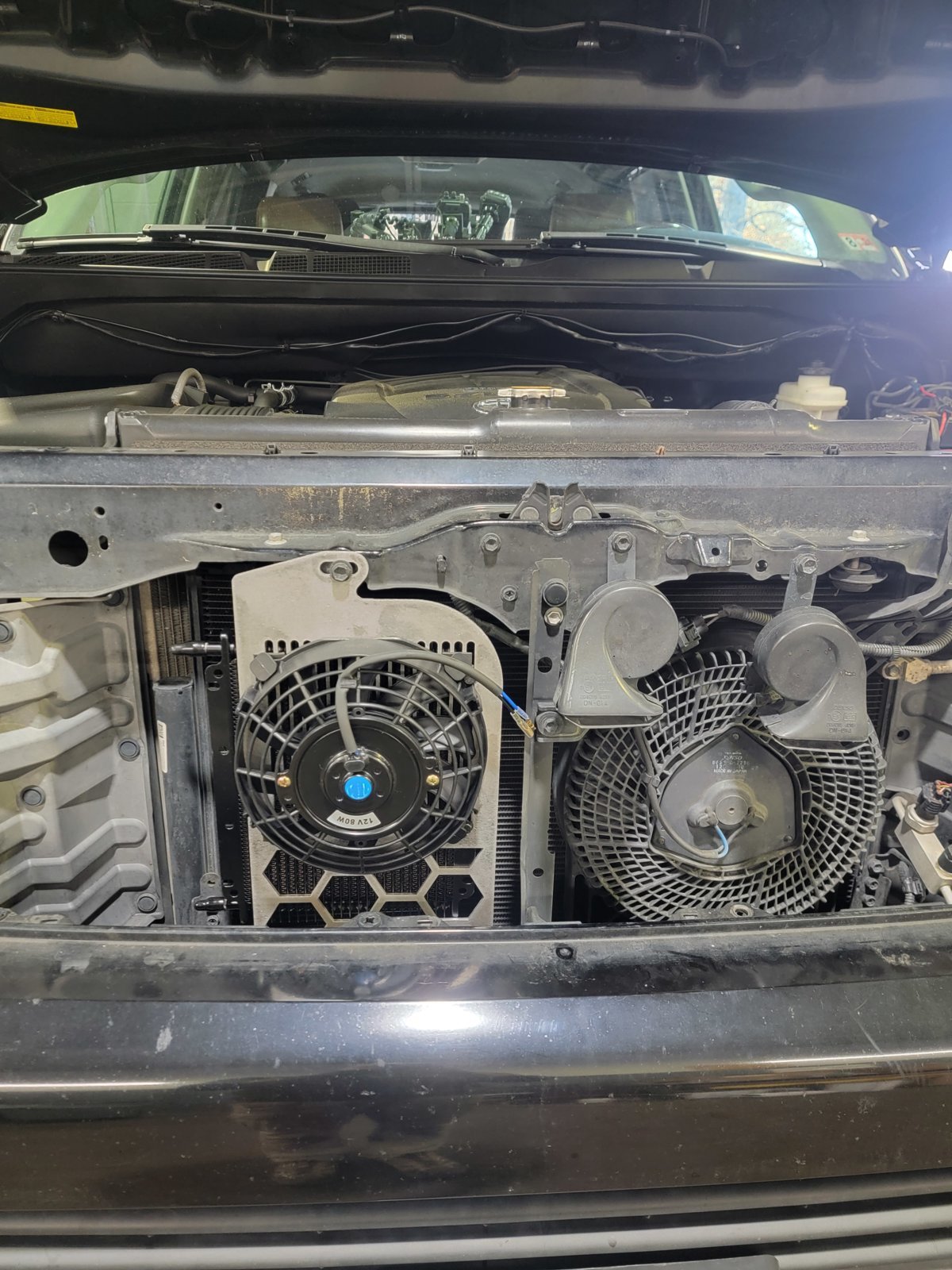

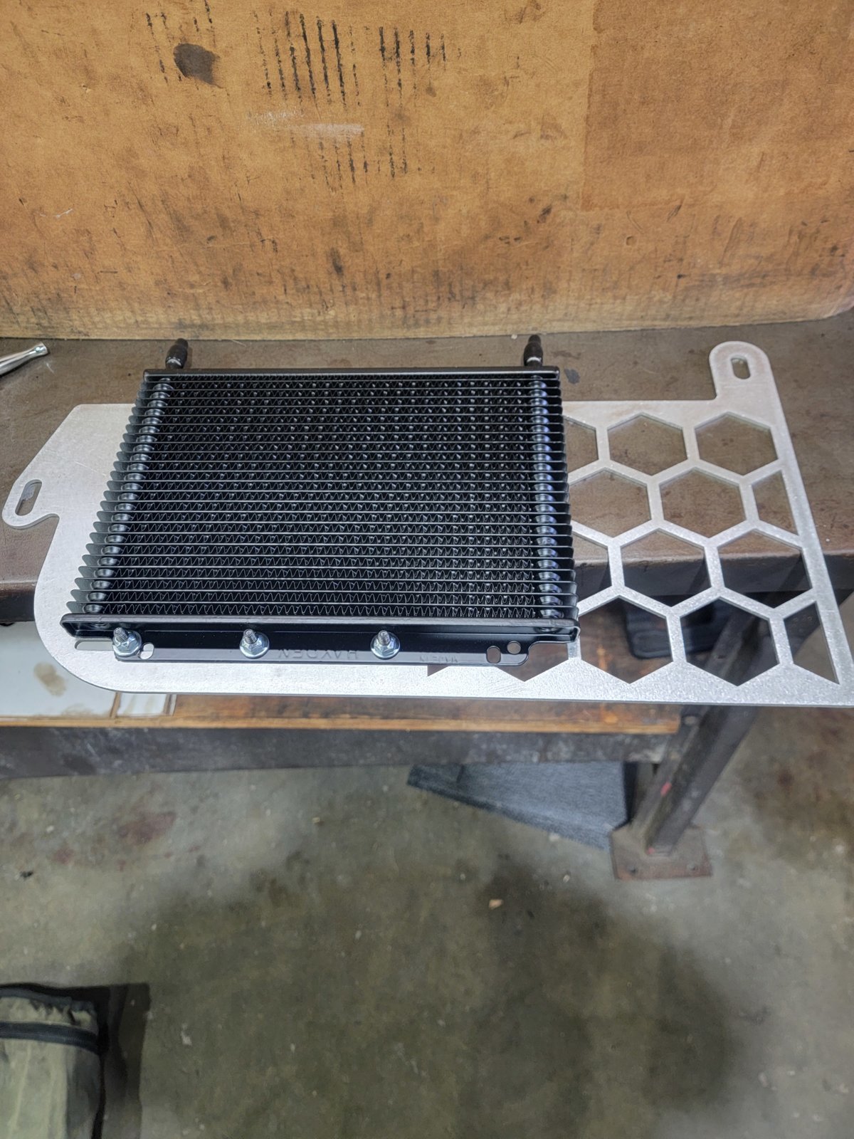

    Here are pictures of my transmission cooler. The tandem off-road mount worked perfectly and there is still room to mount the winch controller.
    I will put the oem parts on the transmission, drain and refill the fluid, and plumb the cooler another day.

    Installed the transmission cooler hard-line and plumbed the cooler to it. I added some grommets into the plastic air director (or whatever it is called) to protect the line. I didn't not install the thermostat and plumb it to the hard line yet. I also installed a diverter valve to drain transmission fluid from the output line.

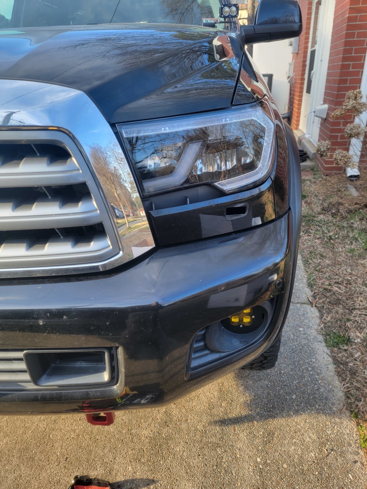

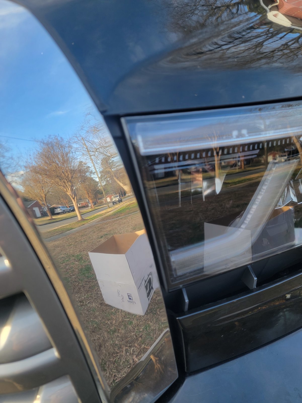

    I also installed the new form lights. I "recycled" the original headlight filler panels until I can get the new ones painted. I found that there is not a provision on the bottom of the new lights for the headlight washers. So, I removed the washer assemblies and clamped the lines.
    I did find that there is a small gap at the grille / hood intersection. I hope that the new TRD grille and hood bulge will cover it.

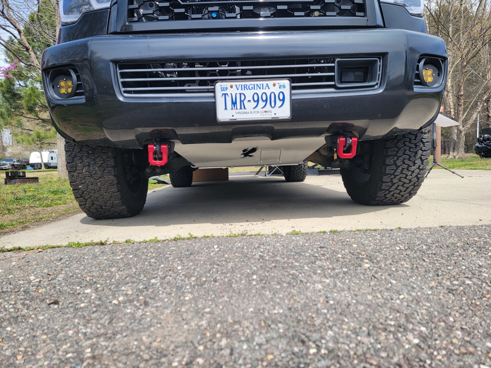

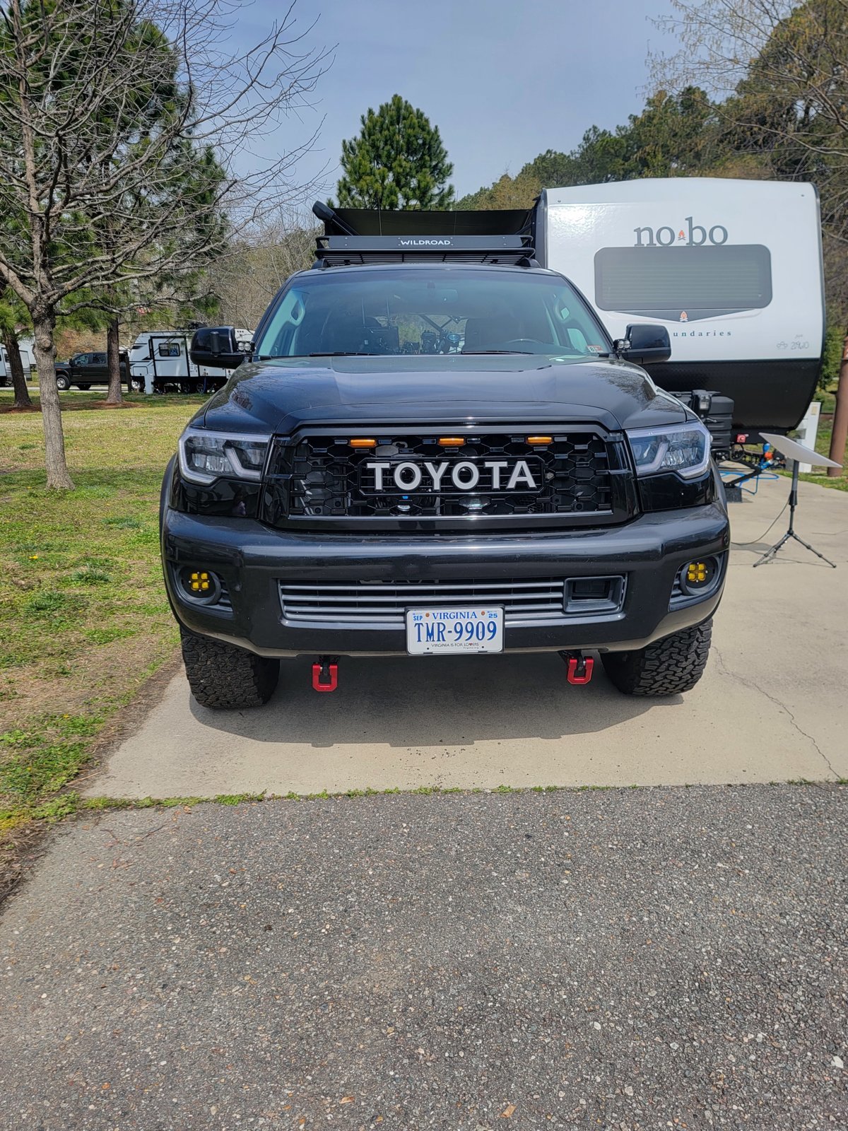

    Added the TRD replica grille and Talon's garage skid plate.
    It was interesting getting the skid plate lined up with the dobinsons diff drop. Talons garage does send spacers if you tell them that you have a diff drop.

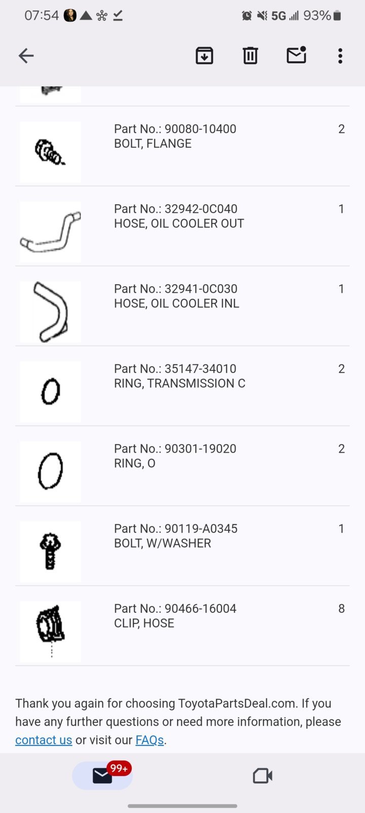

    Thank you so much! My build has slowed with funds going to upgrading the travel trailer, but things should pick up soon. I did an oil change and installed the metal oil filter cap and fumoto valve.
    Here is the transmission cooler list:
    32970-34030: transmission thermostat
    32907-0C020: hard lines
    See picture for additional oem parts.
    -You do not need the 90119 bolt. I needed it to mount the tandem off-road maner mount.
    I used this cooler:
    Hayden Automotive 678 Universal Rapid-Cool 9.5” x 11” Add-On Transmission Cooler – Not for Direct Replacement of the OE Cooler https://www.amazon.com/dp/B000C3DDKO
    And this fan:
    7" inch Universal Slim Fan Push Pull Electric Radiator Cooling 12V Mount Kit Black https://www.amazon.com/dp/B014KK7M06
    For the drain, I used these:
    Anderson Metals - 57002-0608 Brass Hose Fitting, Connector, 3/8" Barb x 1/2" Female Pipe https://www.amazon.com/dp/B0045LKB4A
    JR Products 62255 3-Way Brass Diverter Valve - 1/2" MPT x 1/2" MPT x 1/2" MPT https://a.c
    o/d/gN0wiuZ
    Wallygator and Chilkat like this.

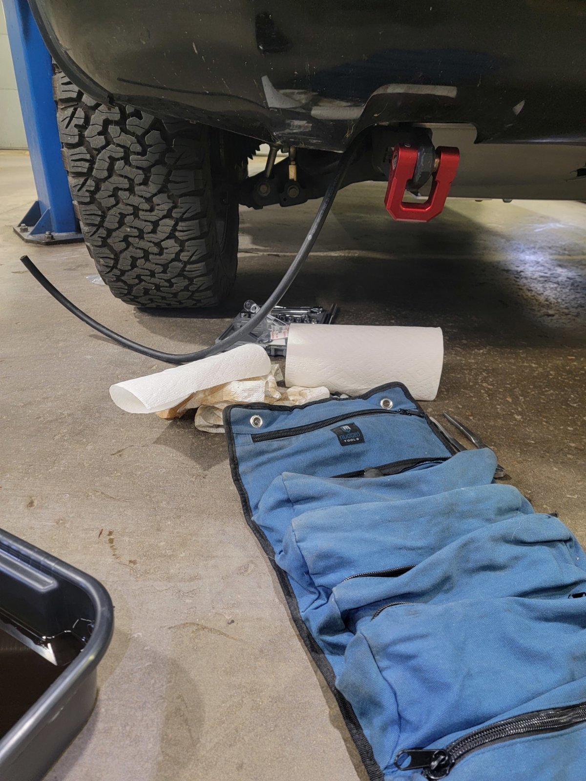

    Nothing crazy. Finished up the thermostat install for the cooler and did two drain and fills: one draining and refilling the pan. The other by opening the bypass valve I installed on the outlet hose to the cooler, and starting the truck. Final refill and fluid check, and she is good.
    Here is the pan fluid;
    And here is the hose attached to the bypass valve.
    The fluid was just as dirty coming out of the bypass hose.
    The transmission is noticably smoother and quieter.
    As I type this, I just realized I forgot to remove the thermostat pin... I'll pull it out before work in the morning.
