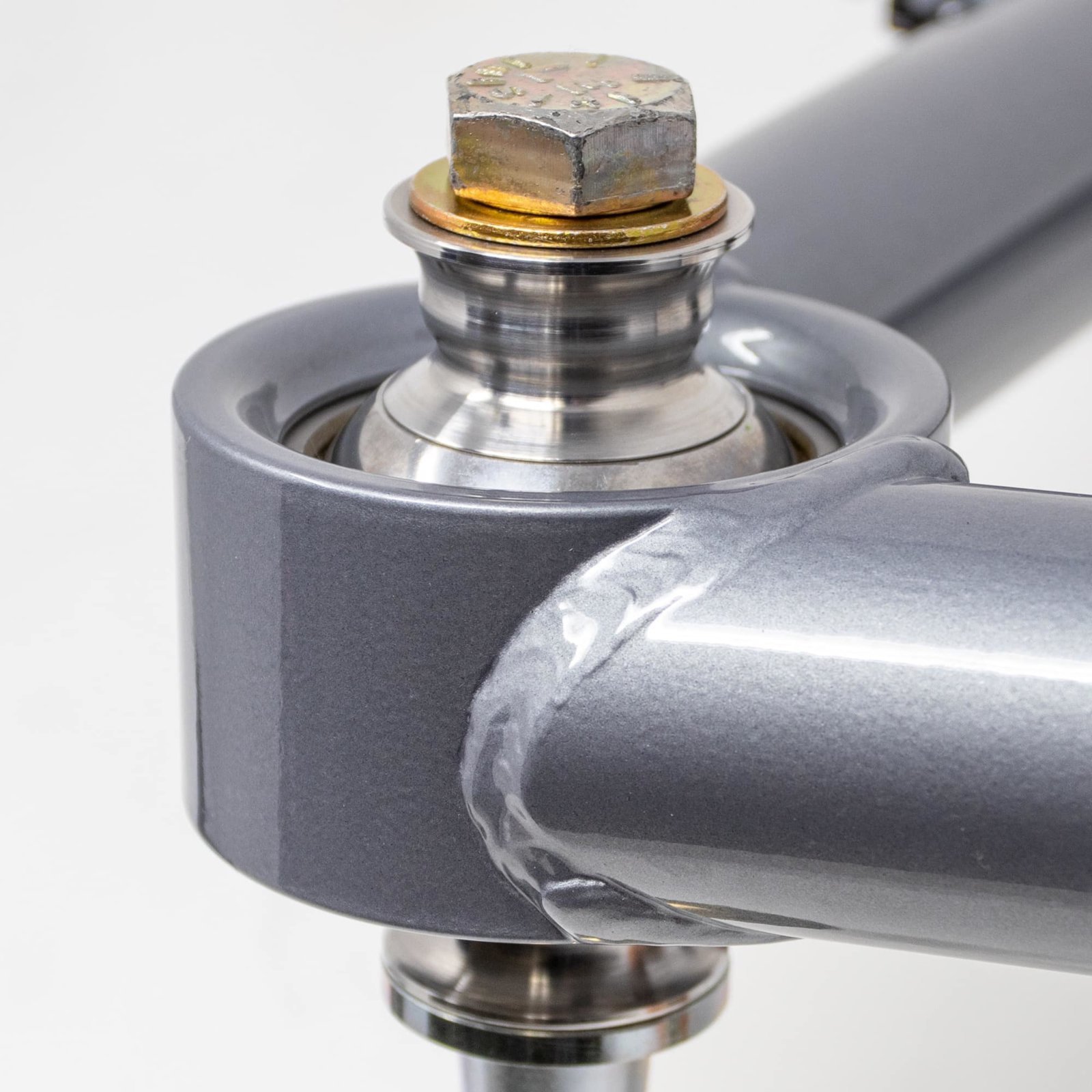

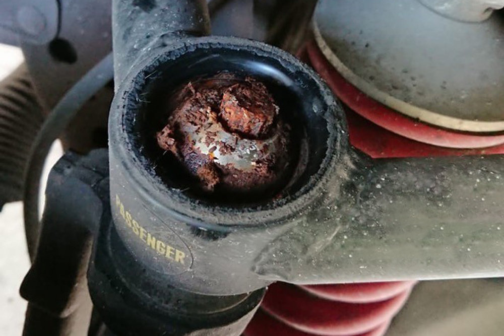

    comparing to other brands of aftermarket UCAs, do you all have a reason for the uniball adaptor on top? it prevents the use of a Caps to keep dirt out. would a sealed uniball not be ideal?

    You could always get these and then throw your Delta joint in there right?

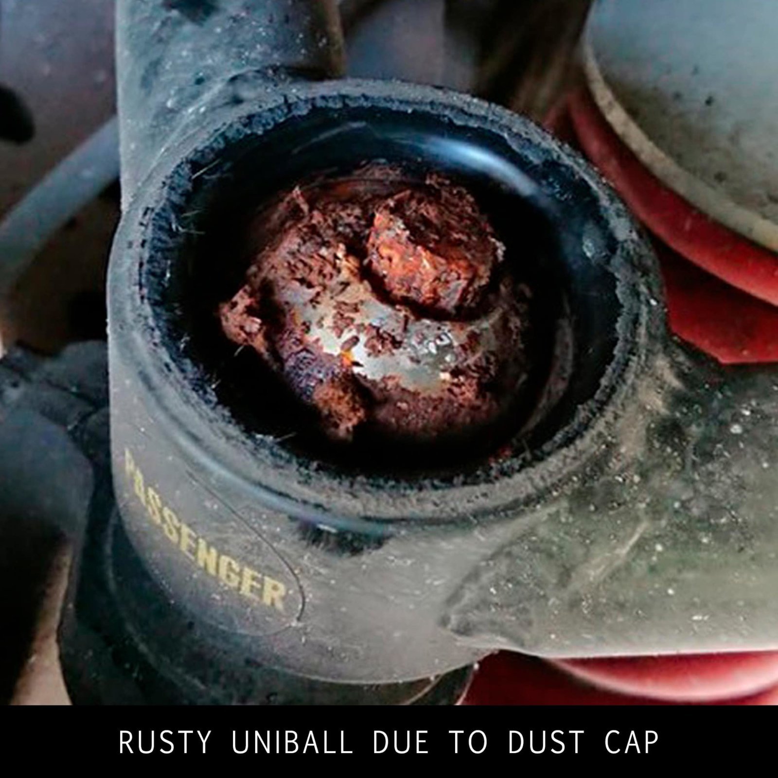

    there are advantages and disadvantages to everything. keeping a cap on can lead to dirt, grime, ect sitting on top of the uniball and really making a mess of things under the cap as seen in this picture.

    wow okay im convinced!

    yikes! I wonder if a thin layer of grease between the cap and mounting surface could further prevent stuff (dirt/water) from going in... I understand that the problem is the cap keeping stuff IN, but then it wouldn't be a problem if nothing got in to begin with.
    Lack of maintenance is always the biggest culprit.
  11. Sep 19, 2022 at 10:07 AM
    #101
    TOTAL CHAOS
    TOTAL CHAOS [OP] WWW.CHAOSFAB.COM Vendor
    Jun 6, 2018
    #15939
    568
    Corona, CA
    It might but you're still trapping whatever gets under the cap inside. If you can't see dirt/water/ect you're going to ignore it which is why it's a better idea to have it out in the open so you can see whats happening.

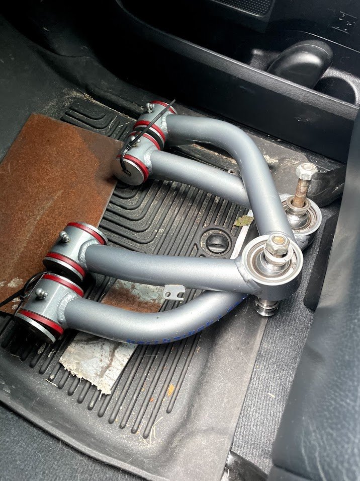

    Just replaced my uniballs a few weekends ago. Not hard with the tool from TC. Back to an amazing, non squeaking ride.

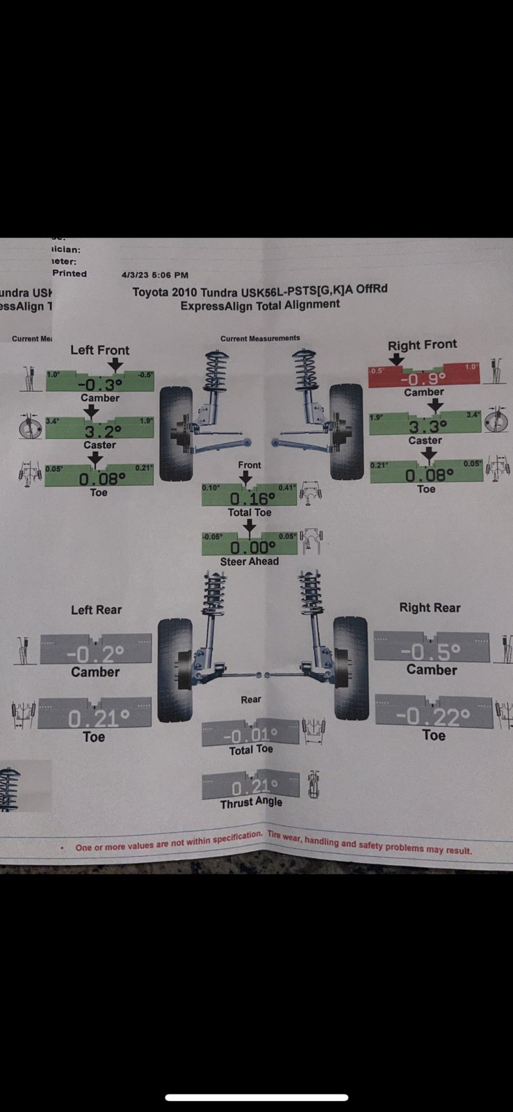

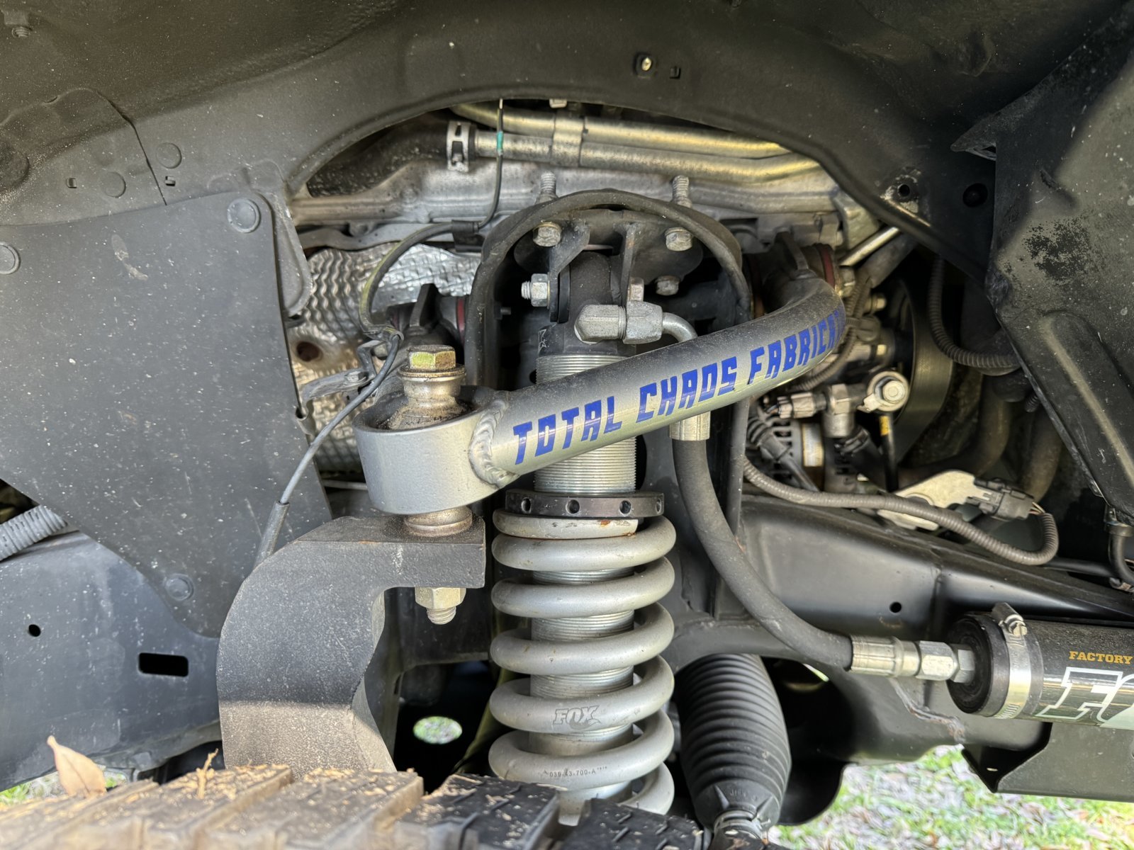

    I installed the bushing UCA’s about 5 years ago. I’m hard on them every once in a while, but it’s generally highway miles. I accidentally blew out the seals while greasing a few months ago, so it’s due for new bushings. But the uni-ball joint is still secure.
    Most recent alignment sheet also pictured. I think I need new LCA and rack bushings, it drives sloppy and gets bump steer.

    Thanks for posting!
    If you haven't already, feel free to give us a call or shoot us an email at info@chaosfab.com
    Send in these photos and we'll be happy to assist you with purchasing new bushings and provide technical information.
