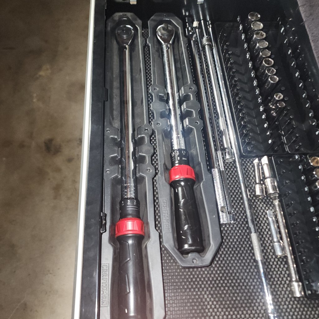

    Glad I came across this thread. I have 2 Craftsman click style torque wrenches. 3/8 and 1/2 that sat in storage for probably well over 10 years and possibly were "in torque" that entire time. I've been watching a couple DIY YT videos about how to check and calibrate and am seeing a few people using those digital readers to check torque. Any thoughts on using those just to get a quick read and make sure they are calibrated accurately?
    I also saw reference of "split beam" which I've never heard of before so I'm possibly looking at maybe updating my wrenches to those as they are suggested to maybe be better. Saw one YT video review comparing 3 split beams: Icon, Tekton, & Precision Instruments. Specs and tests seemed to lean more toward Icon & Tekton plus they both have a lifetime warranty.

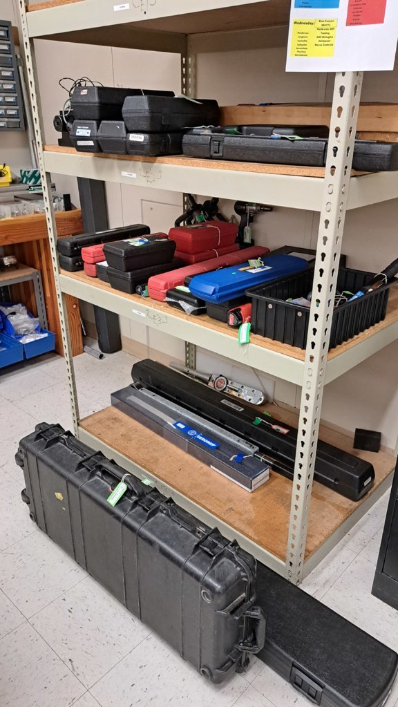

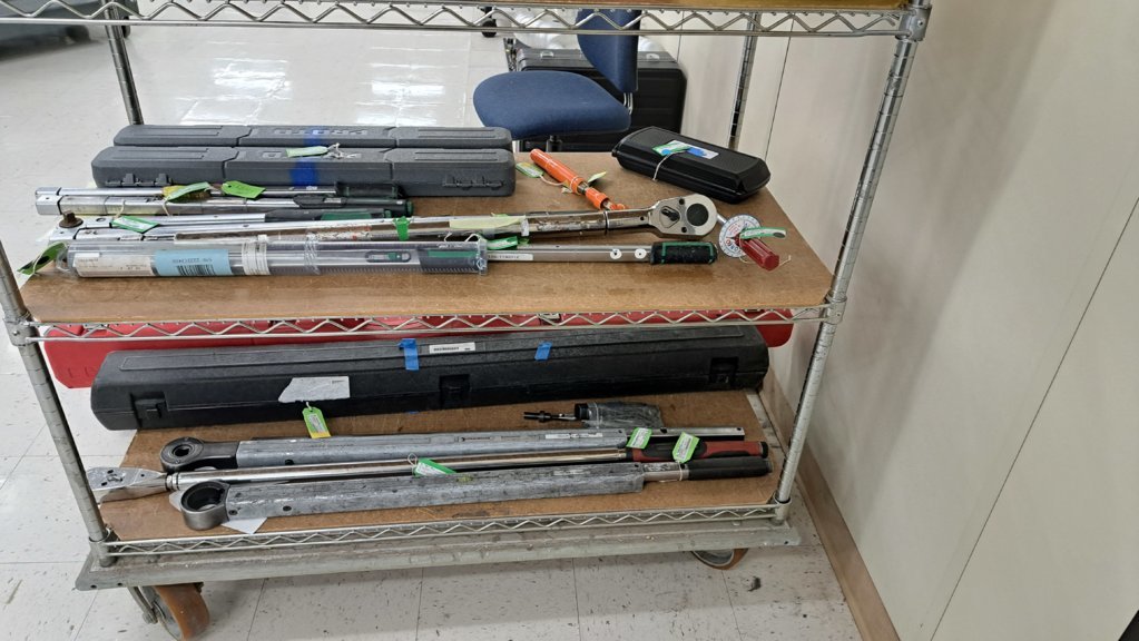

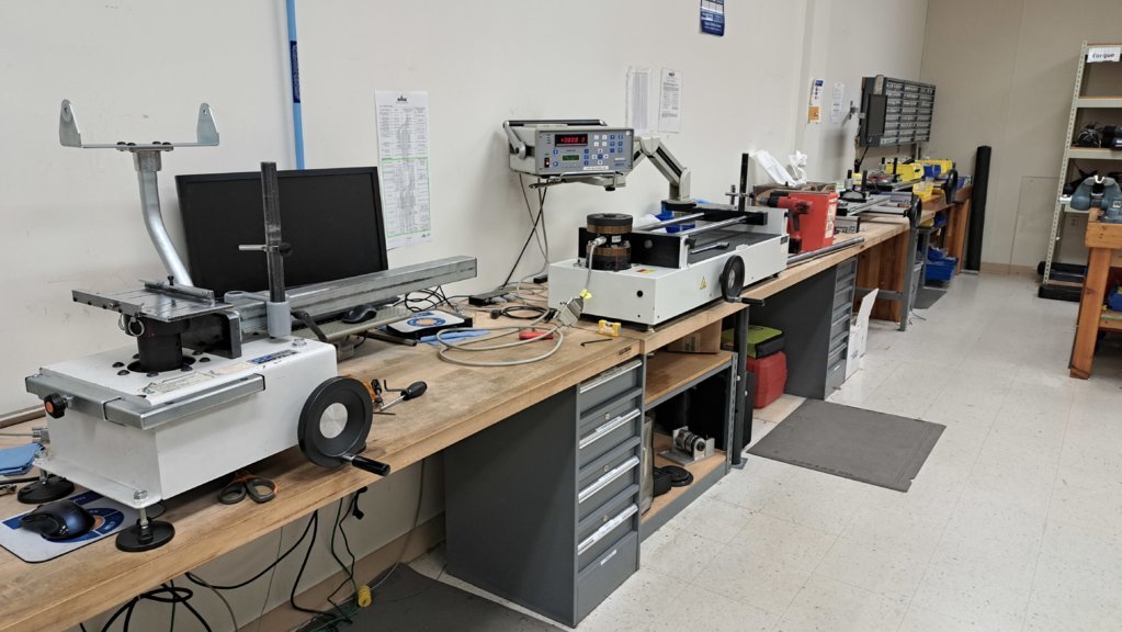

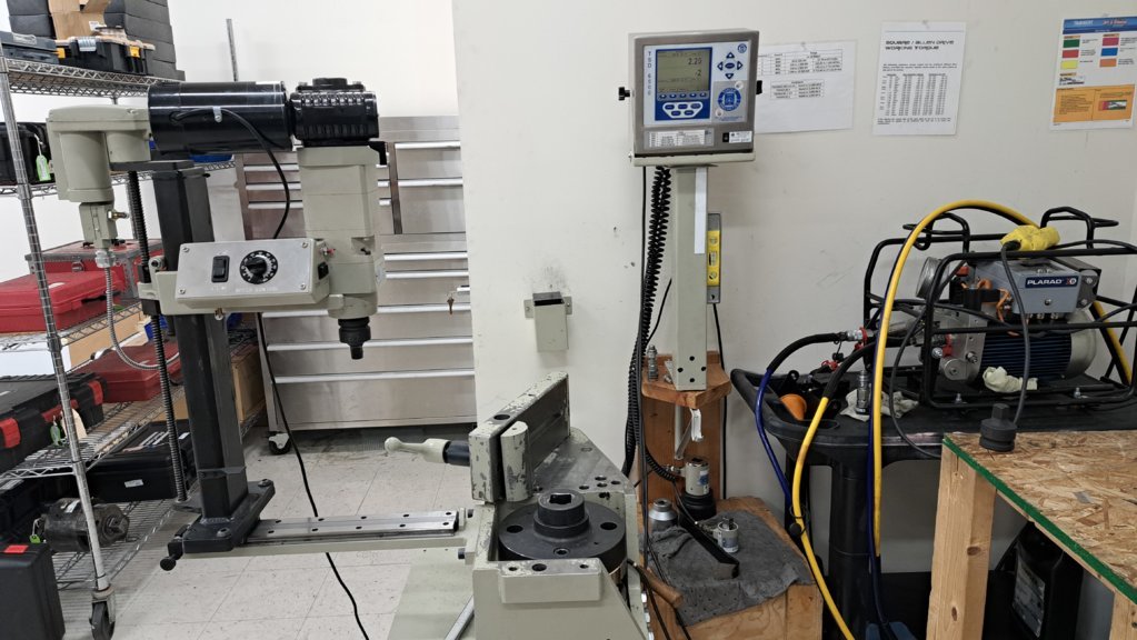

    Click beams have an audible click or snap. Older style Split beam springs maintain constant spring tension. Hence.....no click. Split beams are very durable and also highly accurate, but you have to set the readings manually if that makes sense. Our torque and torque multiplier labs.
