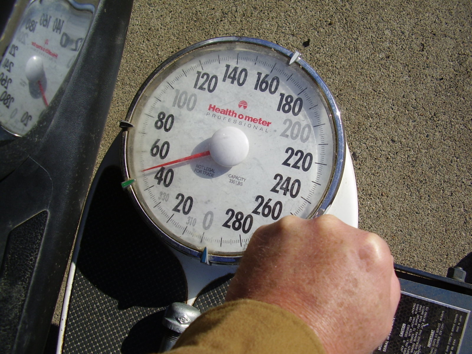

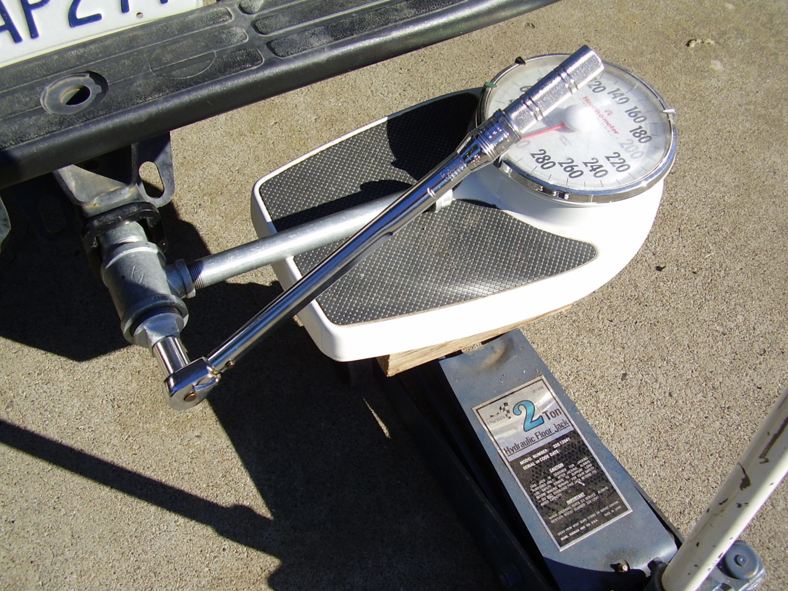

    I've got Craftsman torque wrenches from the same era (3/8" and 1/2"). Here is my crude Rube Goldberg test apparatus (12" arm from center on bathroom scale):
    I was mostly interested in repeatability, not necessarily for torque accuracy. I found both to be very good on these seldom used old torque wrenches (I forget the actual numbers but I was satisfied.
    Dan

    I'm really liking that setup! Yep, repeatability is golden. Accuracy of course is important, but repeatability is more so especially with torque wrenches which usually have 3% to 5% error. For those here that don't know how important repeatability is, here is an example: Would you rather have a +/- 3% torque wrench (tighter spec) that consistently reads anywhere from -3% to +3% each reading or a +/-5% wrench that consistently reads +2% high every reading?

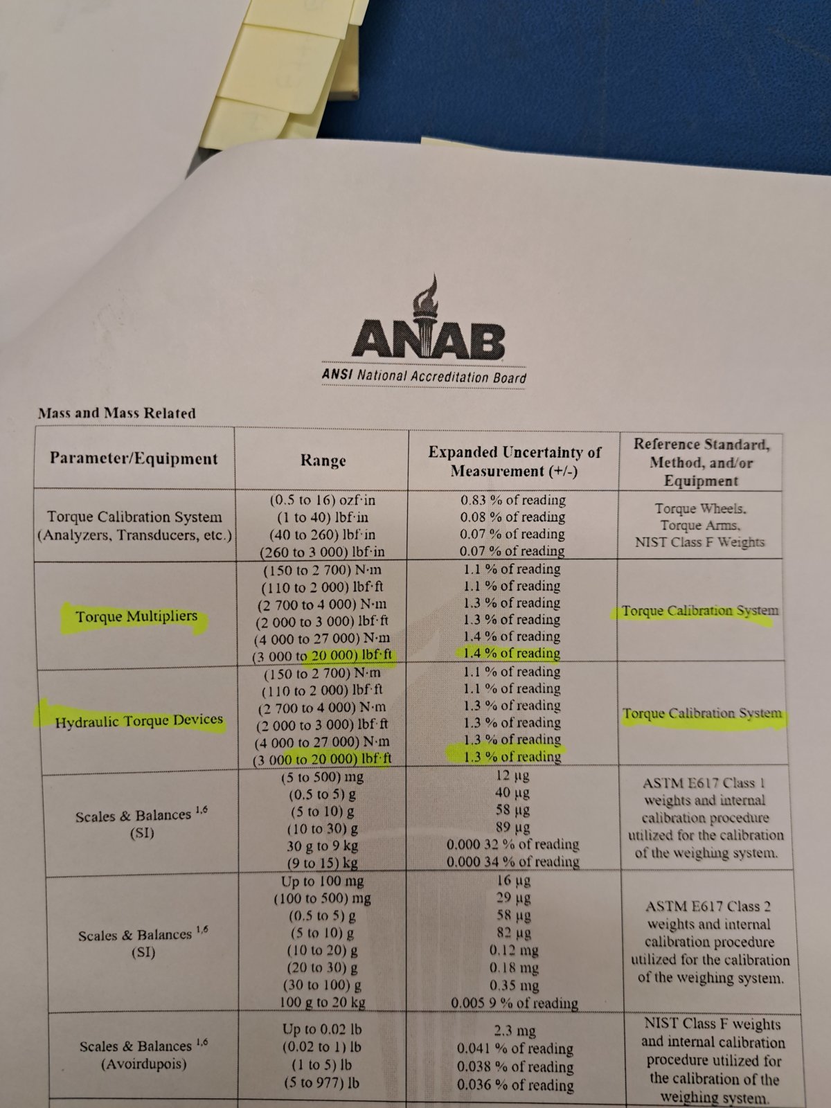

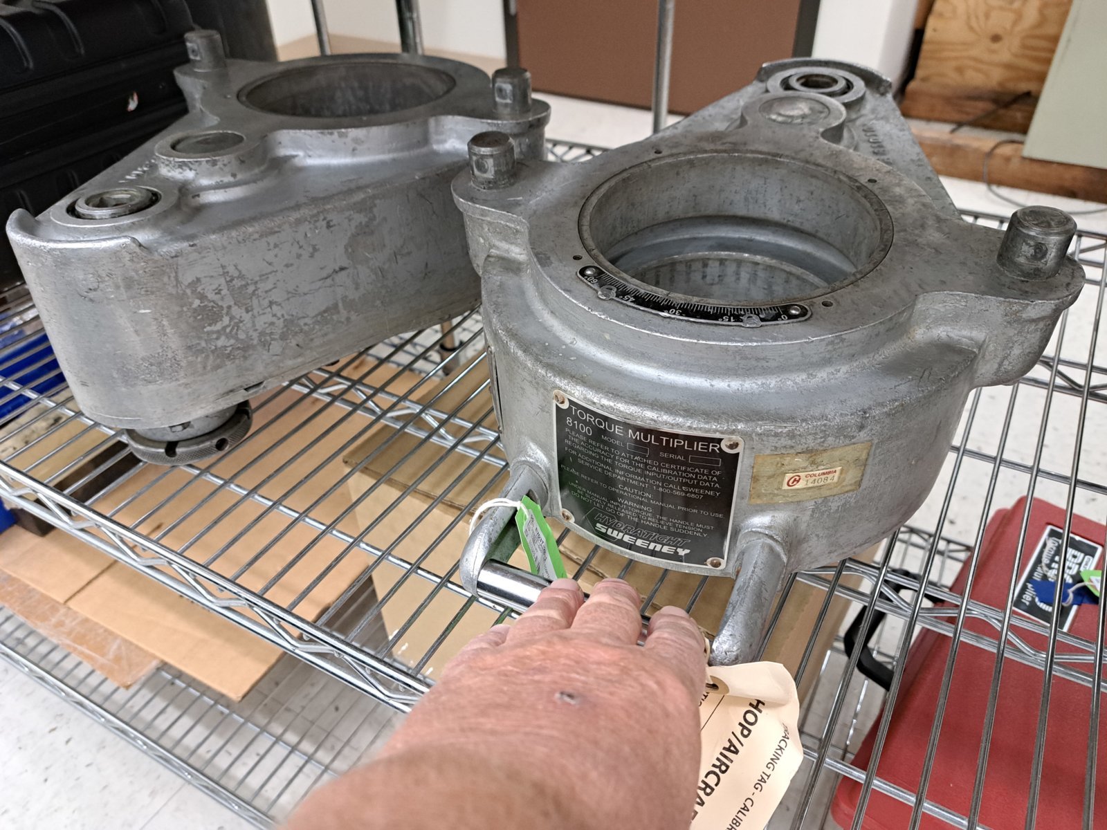

    Might as well add this fun fact:
    We can perform accredited, traceable calibrations on "torque/hydraulic multipliers" up to 20,000 lbs-ft @ less than 1.5% uncertainty of reading! (27,000 N-m)20231212_094601.jpg
