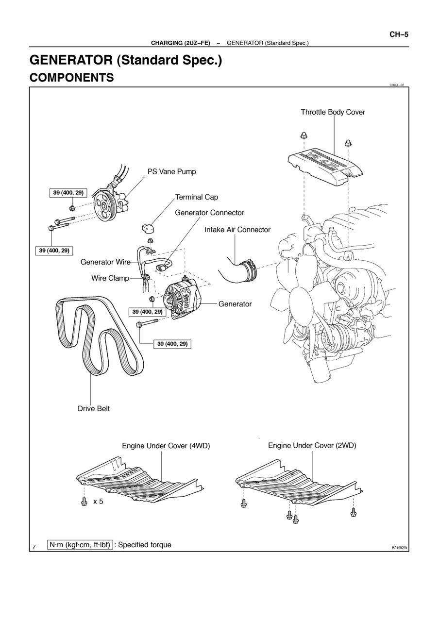

    I have a 2005 Tundra double cab V8 had to replace my alternator do you guys know the torque settings for it and the power steering pump?
    I could not find it anywhere including in my Haynes manual.
    Thx

    29 ft-lb (PM me your email address and I'll send you a link for the factory service manual for your truck.)
