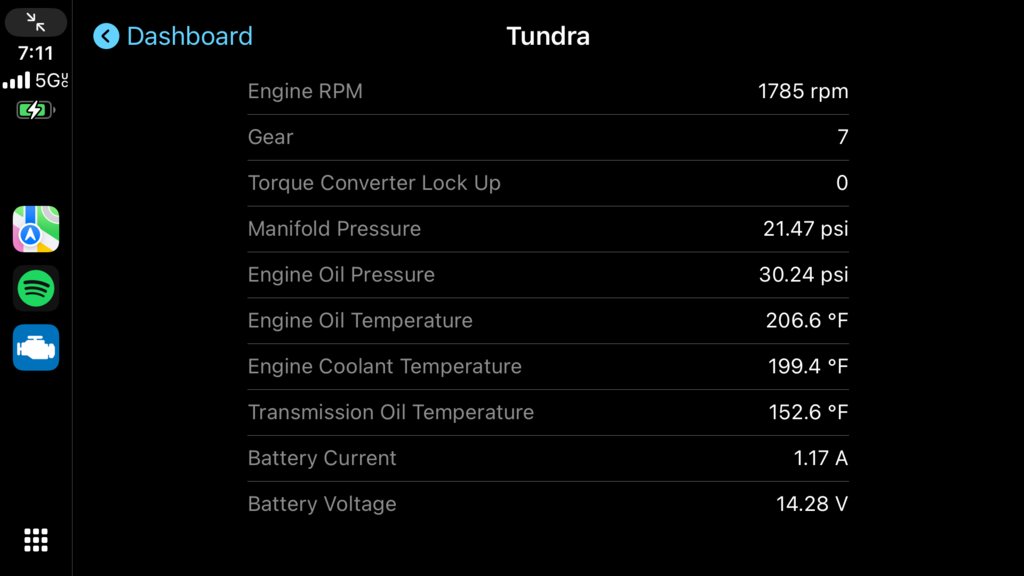

    Yes I am using Car Scanner. I was originally using OBD Fusion however when I saw this thread I switched.
    I would like to have this integrated in Carplay. I do not want to have another screen.
    I am currently using the micro mechanic BT adaptor.

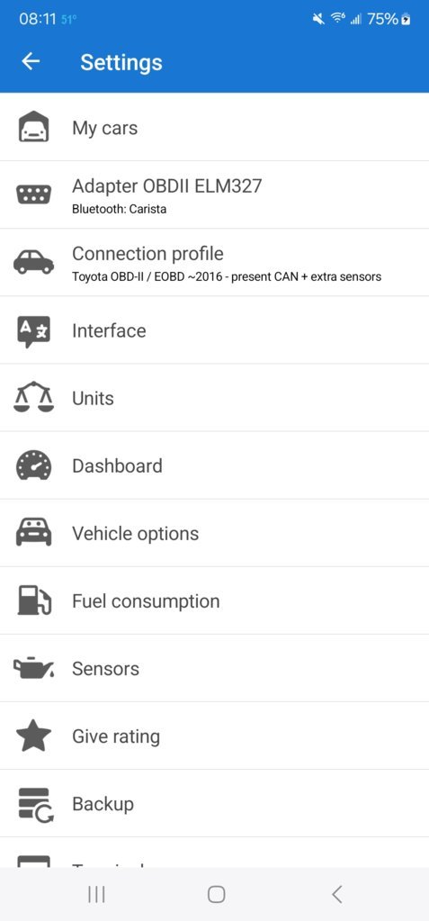

    I'm using the Carista OBD dongle but if your phone is connecting to the OBD dongle you have, it "should" work. You can see the connection profile I'm using in this pic.

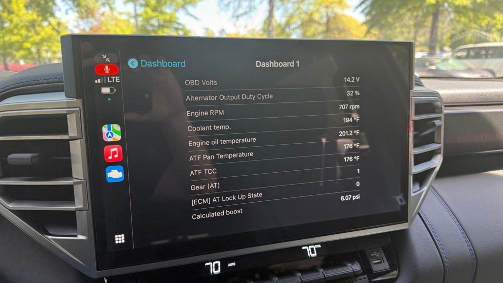

    I was in the same boat as you Mike. I wanted to run a scan gauge, but I wanted something more integrated and economical so I chose to go thru Car Scanner and link it to CarPlay. There is a small delay but it’s helpful to know the temps and customization efforts done by the developers are enough for me to pay $5-6. Not to sound like a rep for Car Scanner but I truly love this app because it lets you log data and scan codes.
    If you would like to learn more about Car Scanner search the OBD2 thread under 3rd gen section and you’ll see many helpful posts about getting it setup.
    This is what my screen looks like.
