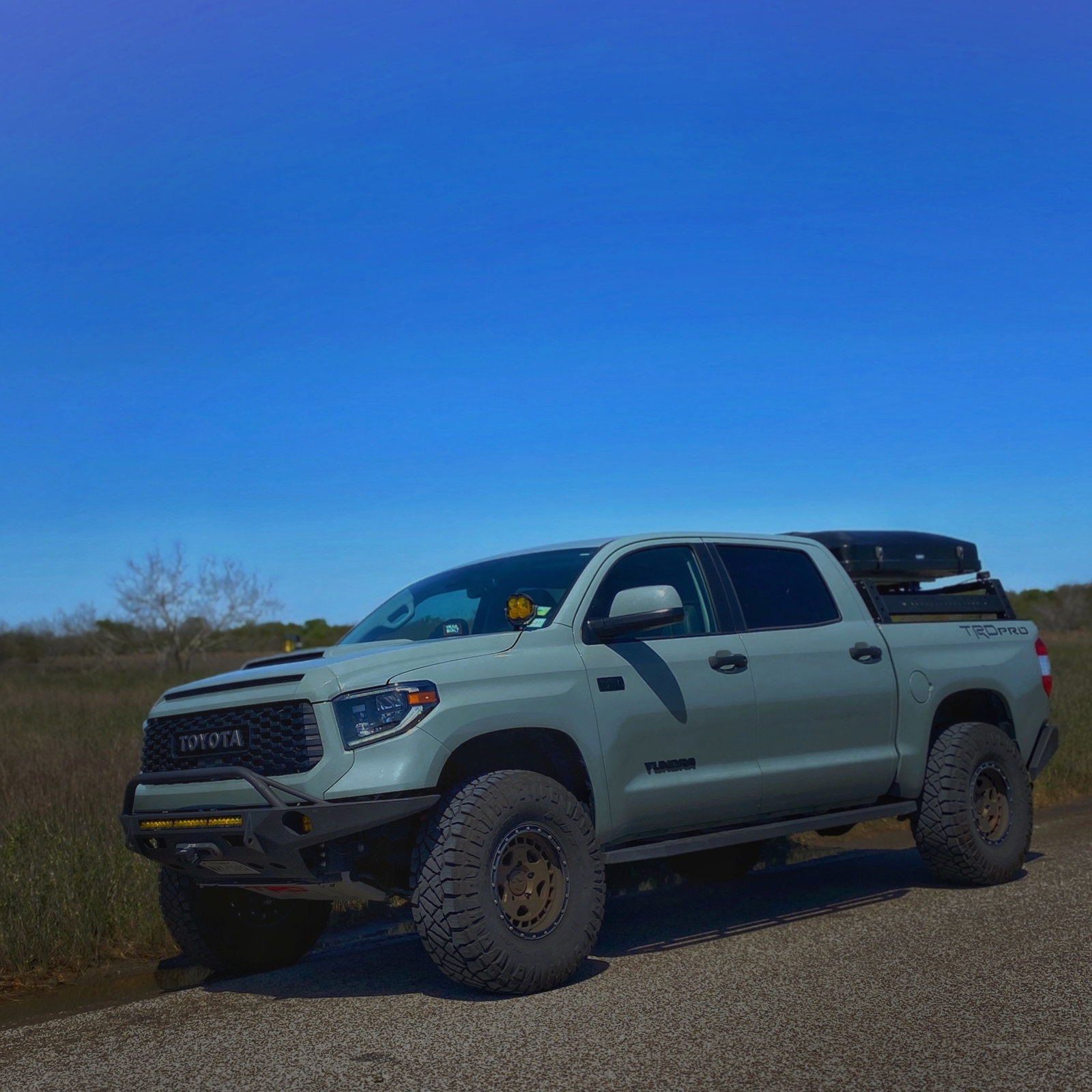

    I've been running the Fox shocks on my 21 TRD P with the westscott lift and the Icon RXT leaf pack in the back. Wheel it pretty hard at Windrock TN and other places... it has held up really well. The ride strikes a nice balance for on road stiffness and responsiveness while being able to take the abuse on the trail. The combo clears and articulates 35s with no rubbing. Took off the mud flaps but that's it.
    The issue I ran into with the westscott lift and its not their fault is that I added a hidden winch and bumper which dropped the front maybe .25 to .5 inches bc of the added weight. Still clears fine but now I'm thinking I should go the Eibach spring route.
    My question for the group is how much higher can the fox shocks go...I am wanting to go 37s. Any input?

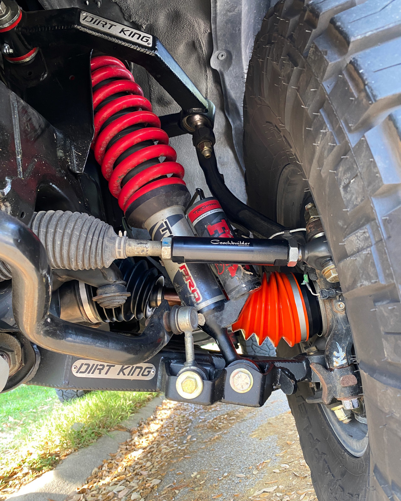

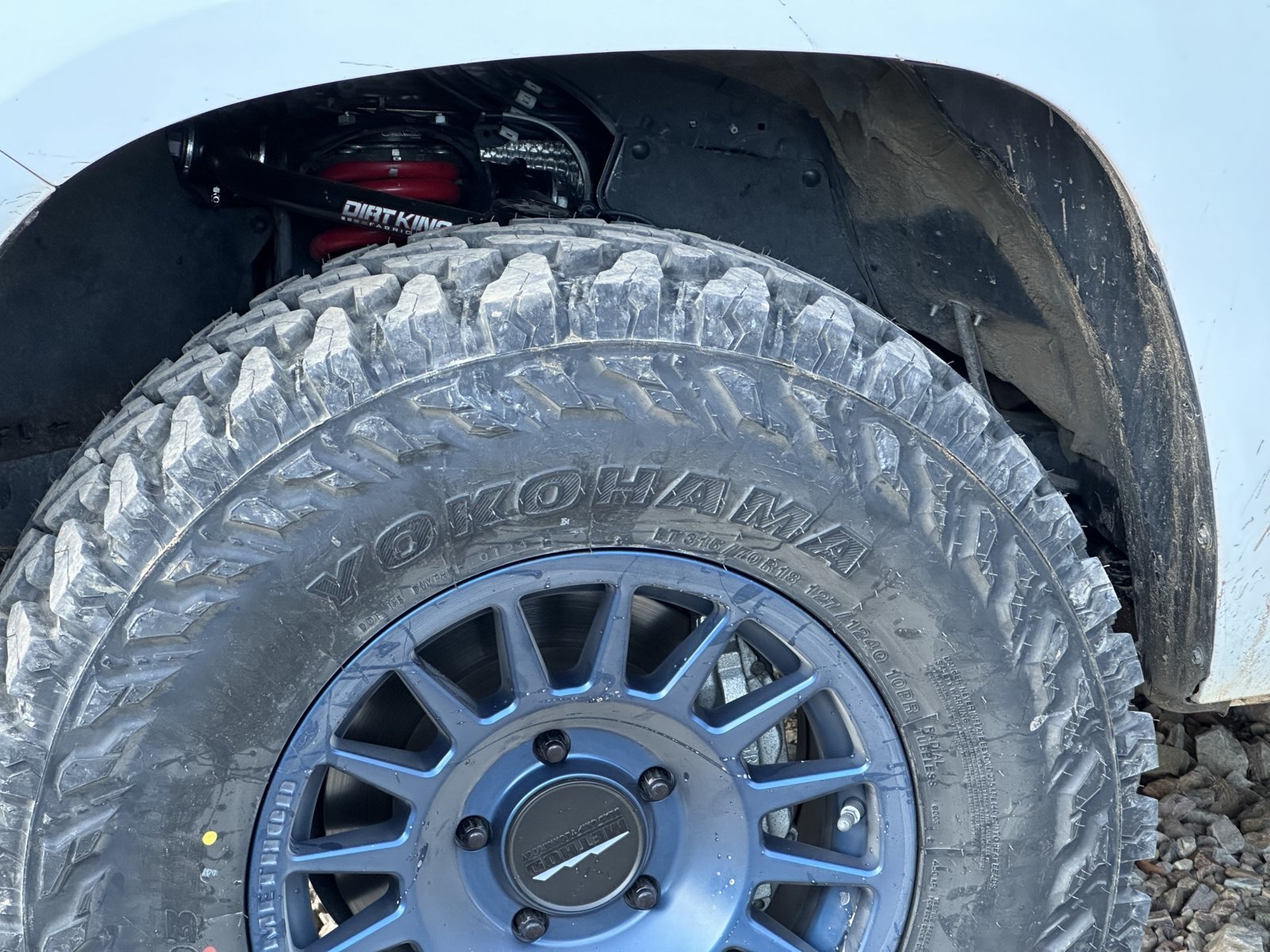

    So, got the Coachbuilder +3 shackles and Pro Shim kit installed, along with the Dirt King UCA. Also added 315/70-18 Yokohama MT's and Method 707's. Required a BMC, bumper trimming, and removing some fender liner.
    I took it for a shakedown run. I didn't notice any topping out. I did have the body mount bushing rubbing on the BMC plate on the driver's side. I fixed that when I got home. Still have some rubbing towards the rear. I'm probably going to have to find a good offroad shop for a better alignment and push the wheel forward some. Maybe pinch weld mod. It drives straight on the alignment they did. Unfortunately the shop I like for installation doesn't do there own alignment and subs it out.
    I didn't take any measurements after this stuff went on, but I should be 2.5" in the front and 1.75" of lift in the rear.

  18. Apr 5, 2024 at 8:45 AM
    #48
    TRDFerguson
    Oct 18, 2018
    #20730
    10,955
    Jake
    Southeast Greater Basin, AZ
    2018 MGM CrüeMax
    Lookin good. Now bring it up to Florence on Sunday!

    Damn that looks good! I hope it rides great! Always fun chasing down and fixing all the rub points.

    Yeah, seems to ride well. Although I may need to install the Coachbuilder steering kit. I can feel a little bit of harshness at the beginning of the stroke. Could have been the trail I was doing, could have been other things, too.
    I was paying more attention to rubbing, the body mount( it was noisy), if it was topping out etc. So, I will give it a few more runs.

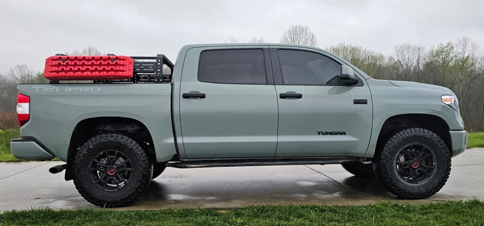

  23. Apr 12, 2024 at 4:11 AM
    #53
    Lunar Megatron
    Lunar Megatron New Member
    Mar 16, 2024
    #113741
    6
    21 Tundra Lunar Rock TRD Pro
    I just mounted these 37s yesterday. I have the RXTs with option 1. Definitely going option 3 though as the back sags a lot with added weight.
    With your 2.5s all you would need is the bmc and slight trimming on the bumper/fender to run dirty sevens and join the club :cheers:20240411_192724.jpg Screenshot_20240412_064814_Gallery.jpg
