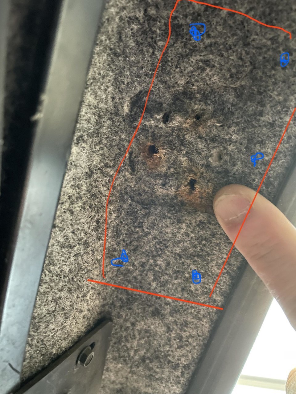

    I wasn't sure if this is the correct forum, but thought since my topper is as old as my 1st gen that people here would be the best resource.
    The gas strut mounts for my topper have one or two screws that have started stripping and I wondered if anyone has thoughts on the best way to reinforce the screws or fill in the fiberglass holes so they can be re-tapped?
    Here are pictures of the fastener, the holes that are the problem area, and the setup.

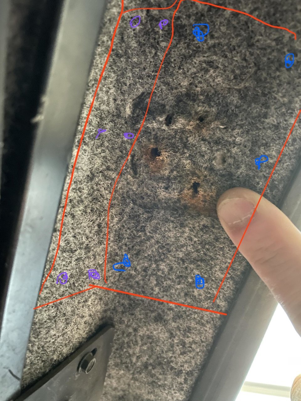

    my excellent markup skillz
    Something like this, you can go larger and add more screws, but to give you an idea.
    You can even make it a larger piece and bend it in a vice to match the curve of the shell and even have a broader reinforced area

    Thanks for the input @15whtrd that's a good idea. I think I can find something that will work.
