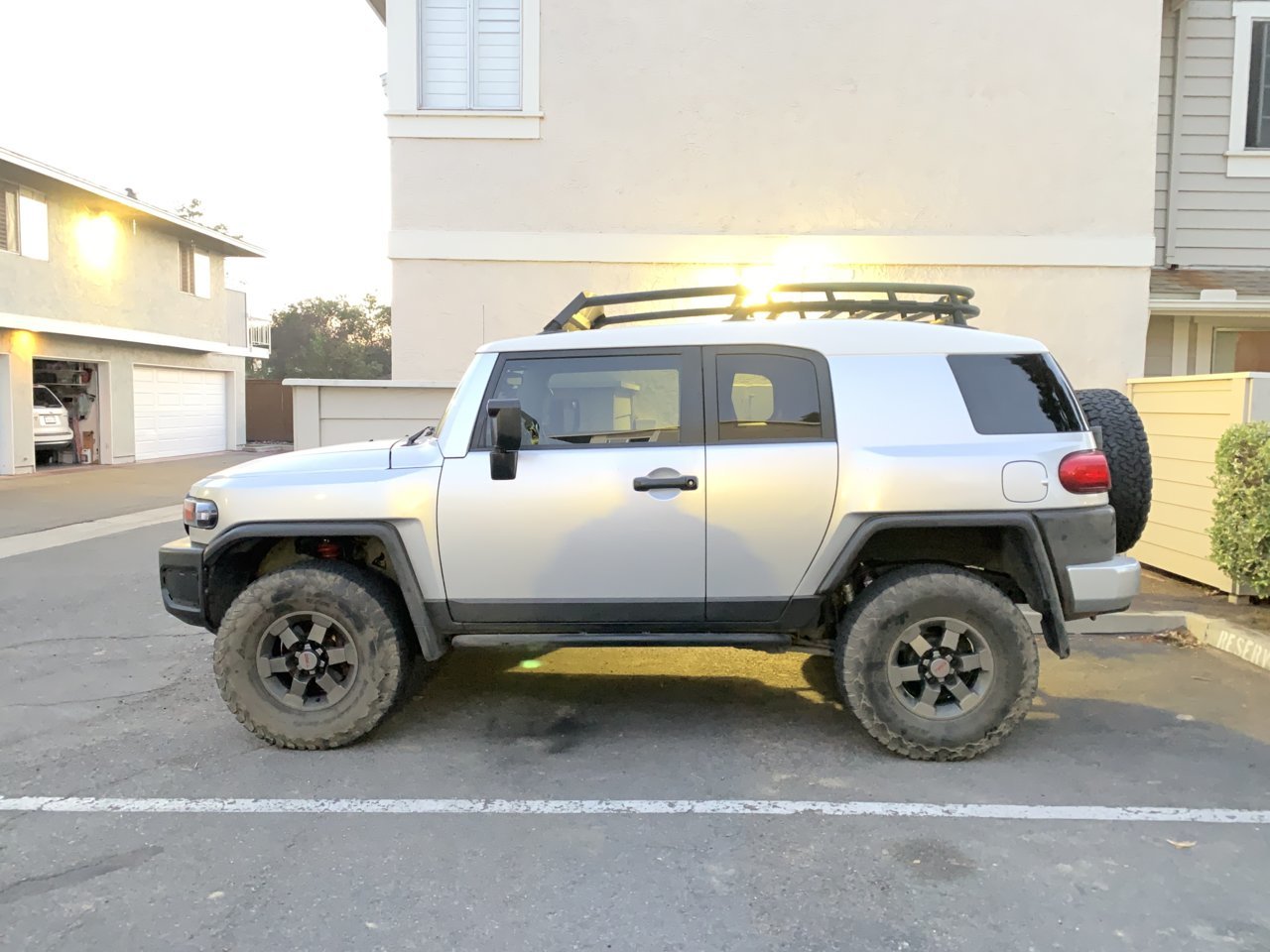

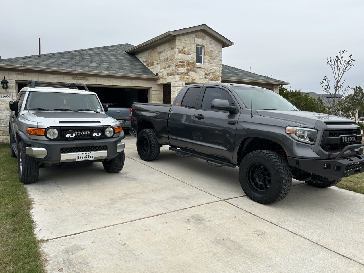

    BF07B67D-4ED4-4669-8204-251EF593C91F.jpg 11A4BEEB-3E24-43F6-A957-A92C92F2A6ED.jpg
    Yup you got a land yacht with that long bed. But I run close to what you have. 295/70/18. Can’t really go much bigger unless I start chopping. But man do I love prerunning. Desert prerunning or dunes is sooooo much fun. I’ve been debating on softening the rear leaf pack to get better travel but then hauling my camping gear would be sacrificed. I’m at a neutral spot in my suspension and don’t know if I should just be content or start the long travel thing. Might just buy another Tacoma and do long travel in that. That way I have all my bases covered. FJ for trails and exploring. Tundra for camping and hauling. And Tacoma for fun and bashing.

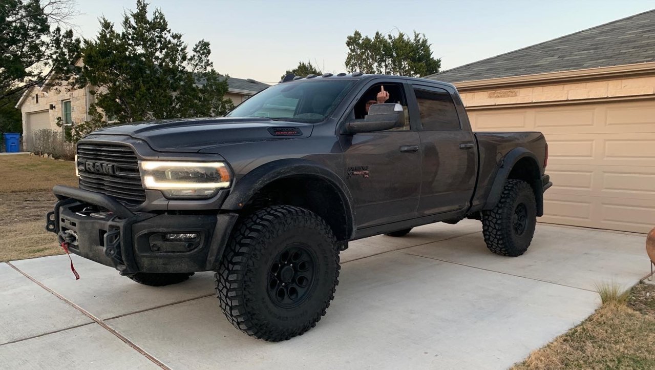

    Had this beast but dodge bought it back. Lemon 34439267-EF09-4C5C-BC49-5567F5353411.jpg
    joseph_womack likes this.
