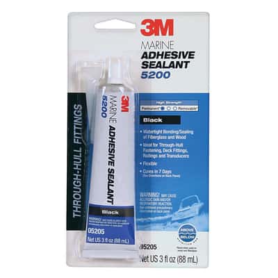

    Just installed my prinsu rack yesterday with some direction from this thread and wanted to just add my .02 while its fresh in my mind.
    Overall I found this install very tedious. I had help from my brother who has way more patience that I do and it took 8 careful hours overall. I watched prinsu's own tutorial video which made the install look very easy but early in the install I could see they really glossed over the tedious bits.
    First of all if you are going to tackle this yourself get a couple more items: two sided tape and adhesive remover. I also bought loctite not realizing they had packaged some with the kit.
    -They didn't show in the video the stock molding has adhesive. It took me a good while to get that cleaned off the molding and in the channel.
    -I had my brother drop the headliner so I can't give exact tips on this process but I could see it was a PITA putting it back together.
    -Drilling wasn't exactly the hard bit, it was making sure we had the holes in the right spot. Probably moved the partially assembled rack in place 5 or 6 times just to make sure the holes were in the right spot. One thing I'd suggest is starting to two forward holes slightly foward toward the windscreen. When we got to the back, there is a factory welded "hook" for the rear trim piece. The last mounting point for me was but up against that and I wasn't sure if we'd even get to mount there given how close to the hook we got.
    -One of the more frustrating parts for me was trimming the weatherstripping. We got to the home stretch and we couldn't get two of the bolts into the rivnuts due to me cutting the weatherstripping a hair too big. At this point we had to take the spacers out which had our RTV on it causing huge messes all over the paint and hands.
    -speaking of mess, I don't see how its possible not to get rtv over everything unless by some miracle you get everything lined up perfectly. I probably spent 30 - 40 minutes throughout the process wiping up rtv.
    -the prinsu weather stripping for the front plate is crap. I don't' know how they expect that to just stay on unless you use adhesive. maybe i missed something in the directions but i'm not using it for now.
    -i didn't see anyone post about this but the rack is interfering with the satellite radio. I need to look more into this but on my ride home it kept cutting out
    -I don't see how you can safely do this without dropping the headliner. So much shavings get into the hole and even with a magnet there is a good bit that is still there.
    -we used a thin piece of steel with magnets on it to catch shavings and it worked decently well.
    Please excuse my scattered thoughts on this, still pretty exhausted. Overall I'm happy with the look, concerned about leaking in the future. Not sure I'd do it again but time will tell. Few pics incoming...

    Just want to update on this project. Unfortunately I did experience leaking. It seams two of the plus nuts did not seat all the way and I think the only way to get them to seat is to take them out and re-do them which aint gonna happen. I tried to RTV around the nuts more but that only slightly helped. My solution so far which seams to be the fix is to add butyl tape on top of the plus nuts. So far we've had several rains and no more signs of leaking.
    Also, wind noise is pretty high when on the interstate. I also added a prinsu linkable light bar and its really messed with aero and the front end feels floaty in a bad way. I assume its the light bar/rack combo but my suspension is shot as well. I did add the weatherstriping from prinsu and it helped slightly but I think I'm gonna add sound proofing to the roof in the future.

    I'd try removing/lifting/blocking the rack so you have access to the plus nuts. Clean/remove any silicone away and clean area with acetone. Then use this stuff.
    https://www.acehardware.com/departm...HaQ1ooYq5yvvBDwnk0IaAoOFEALw_wcB&gclsrc=aw.ds

    I’d just tighten the rack bolts down (should compress the jack nuts a bit more) and then apply some lexel around the bases of the post things that go up to the rack. And then apple more lexel around the bolt head area. I bought these to make application a bit easier
    https://www.amazon.com/dp/B07ZY3VVQ9
    You could also just drop the headliner and apply silicone/lexel from underneath. If you’re going to drop the headliner you might as well drill out the jack nuts and through bolt it

    Don't forget to put sealant around the bolt too, on the threads.
