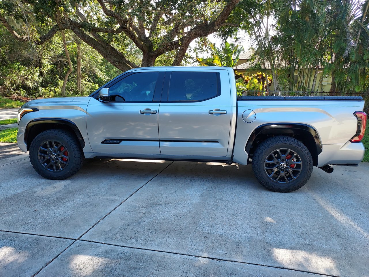

    put Nitto Recon 35x11.50x20 on my 23 Platinum on stock rims and have no rubbing. They didn't touch the liner in front but I pinned them back anyway. I love the look and they drive nice. I would like mudflaps on now but not sure if there's clearance.

    I have the same tires on the stock TRD 20" rims with mud flaps... no rubbing or issues... 100% agree... love the look and drive!

    What's the offset on your rims?

    are your mudflaps OEM or aftermarket? Thanks letting me know. There goes another $150

    Stock... =)

    That looks good! I love the longer beds with bigger tires and a small lift, when they are on stock tires, they look so long when low. I like your limited being that color, the Chrome blends in more

    18 offset
    20x 9 18 offset

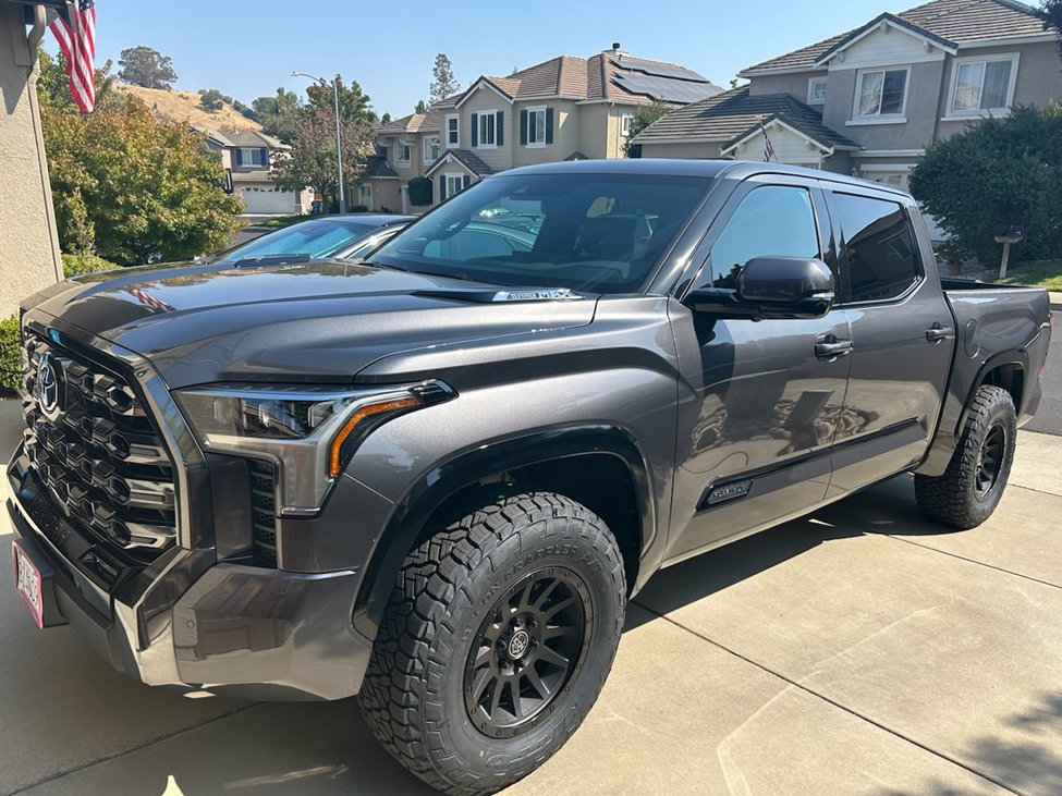

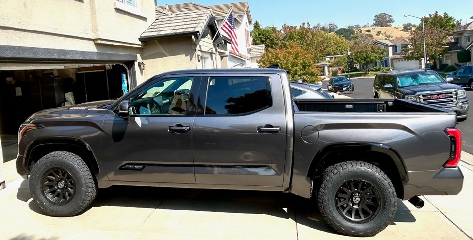

    Received my truck on Saturday. Had tires and wheels put on in <40 miles.
    Went with Icon Compression 18" x 9" +25 with Nitto Recon 295/70 R18. No rubbing at all.

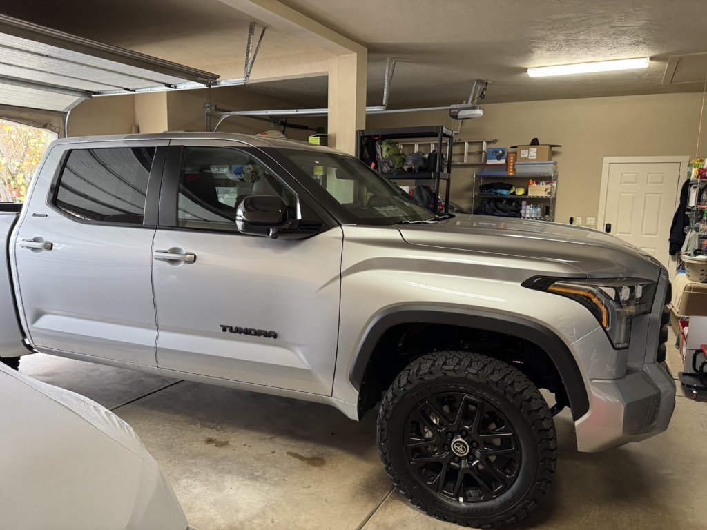

    Take delivery of our 2025 short-bed crew max limited on Sunday. Really want to go with 285/60r20 as this is the smallest size the new BFG KO3 tires come in. Hope to avoid a level kit or lift. Can anyone confirm the 285/60r20s will fit the stock wheels and suspension with no rub? TIA
    For reference I’ve attached a pic of a 2025 with 305/60r20s I drove home for a garage check but it has a 1.75” level kit.

    We have identical trucks lol

    No lift or level with no rubbing at full lock, and went with 295/55R22.Yoko Geolanders G003.
    Nice rig man looks sharp and all the best.
