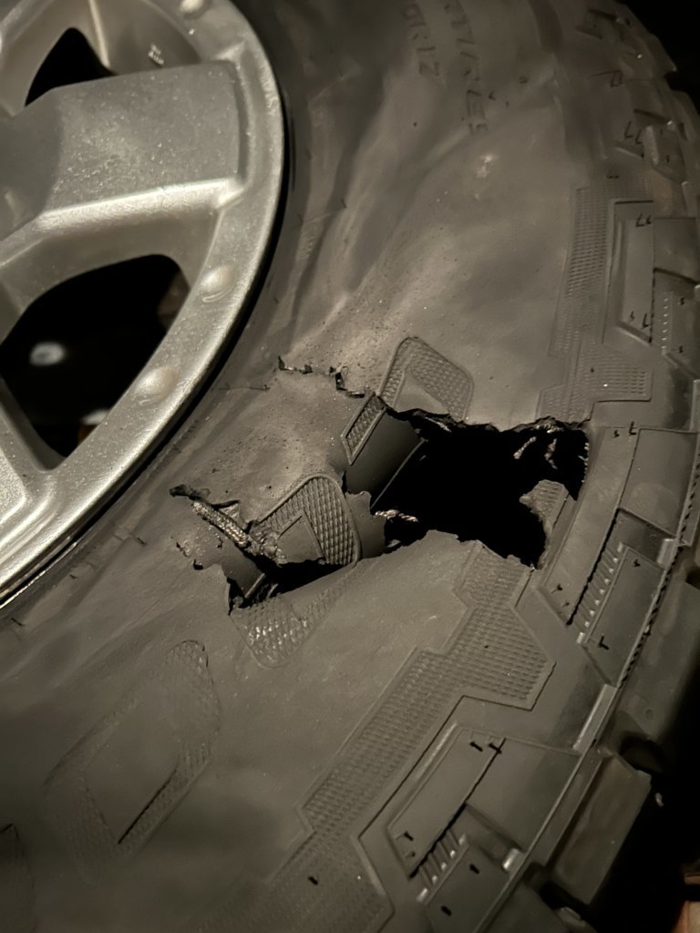

    A recent hunting trip was significantly altered when I blew a sidewall on a Toyo ATIII. I’m not 100% positive a 3 ply sidewall would’ve made the difference, but nearly all of my recent flats have been sidewall related. I think it’ll be a must have for my next set of tires.

    It seems when I buy lighter tires I have sidewall issues. The fuel economy was quickly eclipsed with the replacement cost.

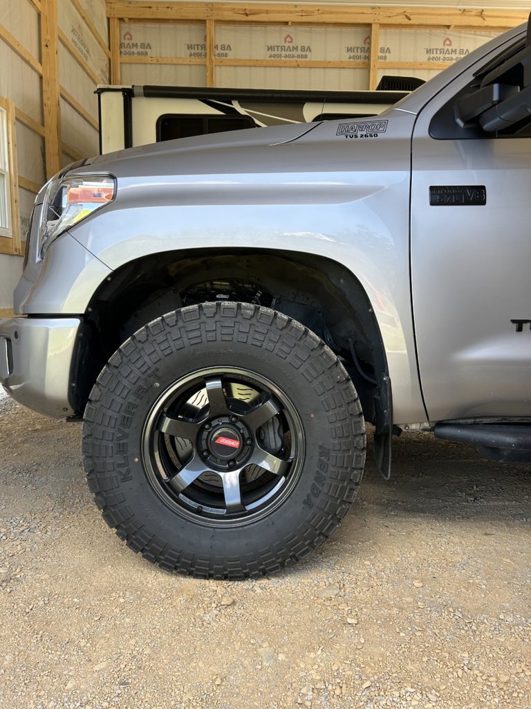

    You could also check out Kenda Klever R/T. They have what they call a “Triple Threat Sidewall”. They also have a lot of lugs on the side which should give some protection. I don’t put mine to the test offroad though, so honestly can’t speak to their durability too much. They have good tread wear and traction though.

    I really like Duratracs, but I’ve had two of them ruined from sidewall puncture/laceration (not the new RT model). I’ve also ruined a Cooper AT3, and most recently this Toyo.

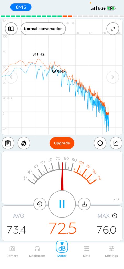

    I see you had the ATs and these are the more aggressive RTs. Reading that thread I saw your decibel meter on the highway. Ironically my cab read 72.5db at 73mph using the RTs 5k miles on them vs your 76-83 on lower mileage ATs at 60mph. I also have some rowdy exhaust. Differences in phone/app used I guess could be a factor too.

    Probably the phone and app. Only thing my post proved is the differences on my phone/app in my truck between the two tires.

    Any idea what wheels are on that tundra?
  27. May 27, 2025 at 4:57 PM
    #27
    Silver17
    Oct 3, 2021
    #68847
    3,693
    Eastern PA
    2017 TRD 4x4 Harrop SC
    These are FN BFDs 18x9 in Graphite Gunmetallic. The center caps are my own creation though since I didn’t like the ones they come with.
