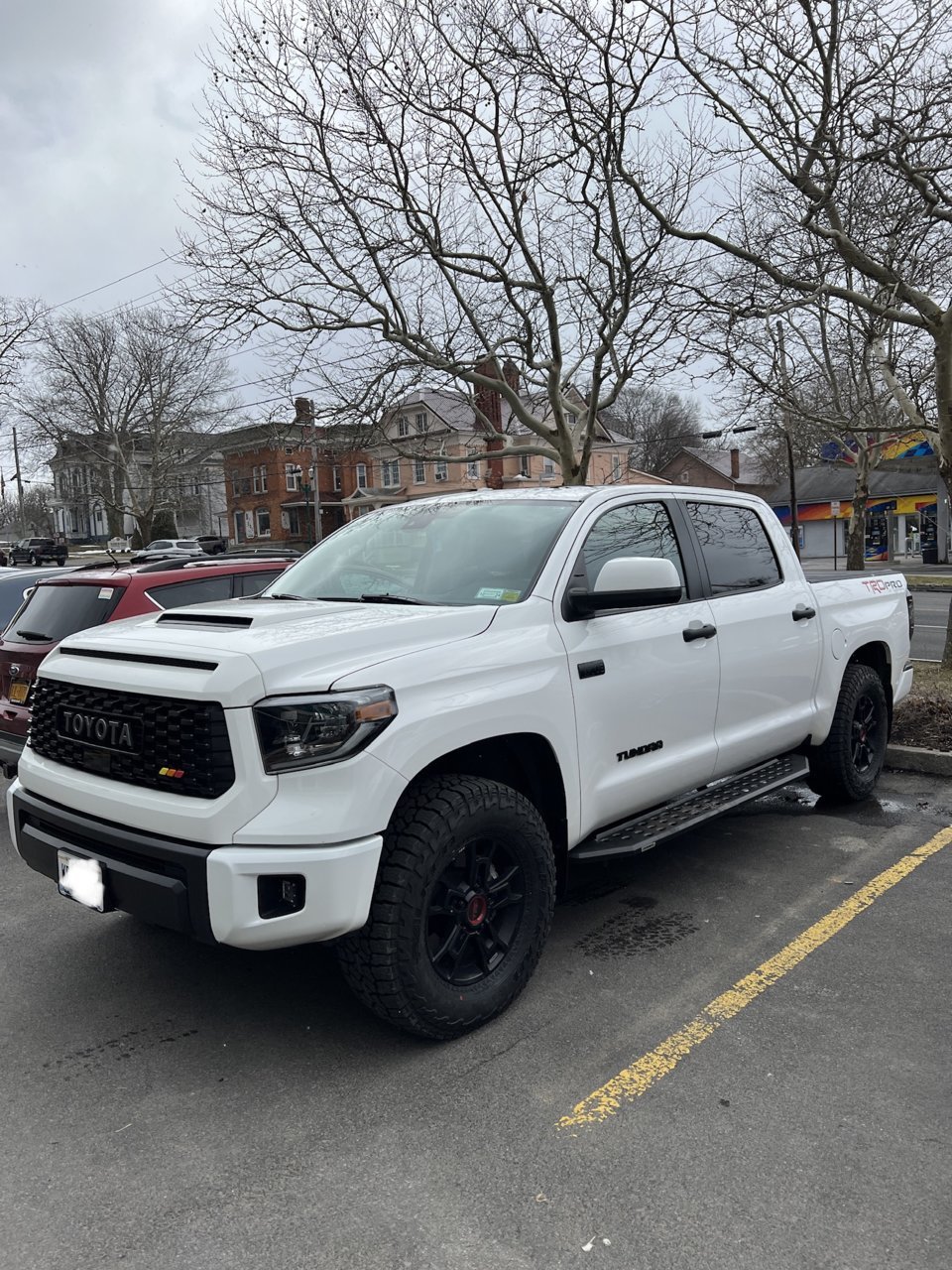

    295/70/18 - Wlidpeaks - 2020 TRD Pro - stock suspension. Went with the Wildpeaks because I’m in CNY, good in snow and have a mileage warranty.

    Looks good. How bad is your MPG?

    I’ve only had them on for a couple of days now and noticed that each trip I take is down round 1 MPG. I normally get 14.5 and I’m at 13.7 after 2 days. I’ll update after the full tank and see overall how MPG changes.

    Looks good; we don't see that size come up in discussions that often. You should post of few more photos showing a head-on view (poke) and a side-on view (wheel well and height)...
