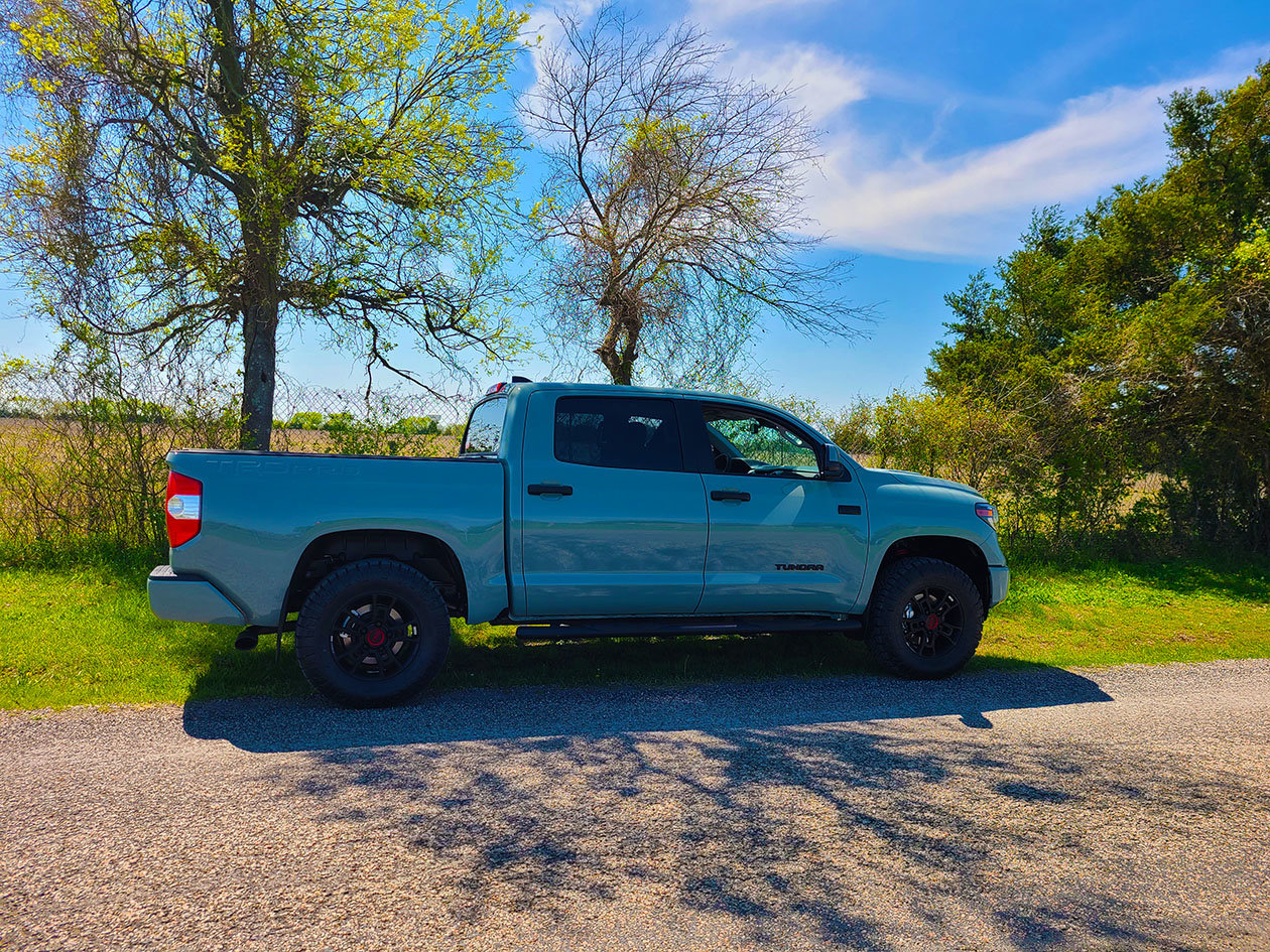

    Looks great. These 285/70?

    Yes Sir, these are 285/70/18s.
