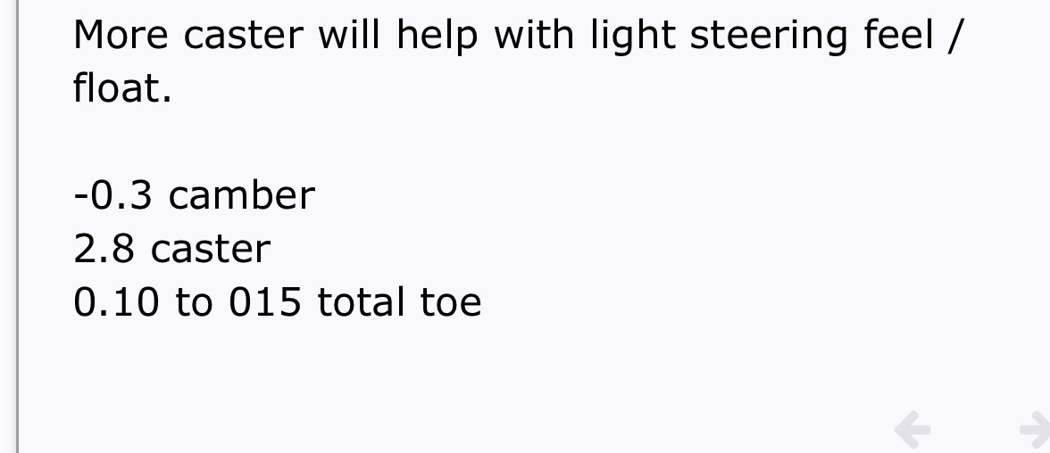

    Update: today after using @assassin10000 's recommended alignment specs, namely greatly increasing the caster, I have no more frame rub at full lock
    A couple weeks ago I also raised the front about one more inch putting the springs on the second notch of the Bilstein 5100s. I was getting some slight plastic rub that I could've fixed, but I just decided if it was that close just raise it another inch and it took care of all of that
    so the final word is that my 305 / 32" fit without any rubbing after raising the front almost 2 inches over stock, bending pinch welds and using those alignment recommendations
    The roughly 2 inches of lift combined with the increased tire height makes it a little over 2 1/2 inches almost 3 versus stock
