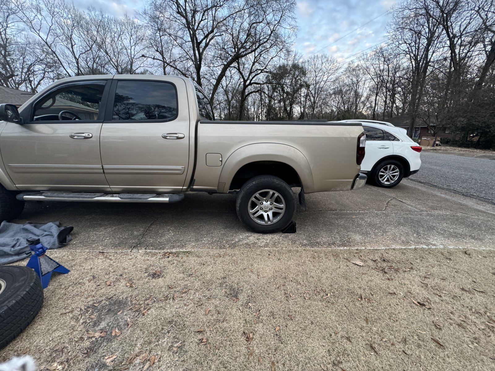

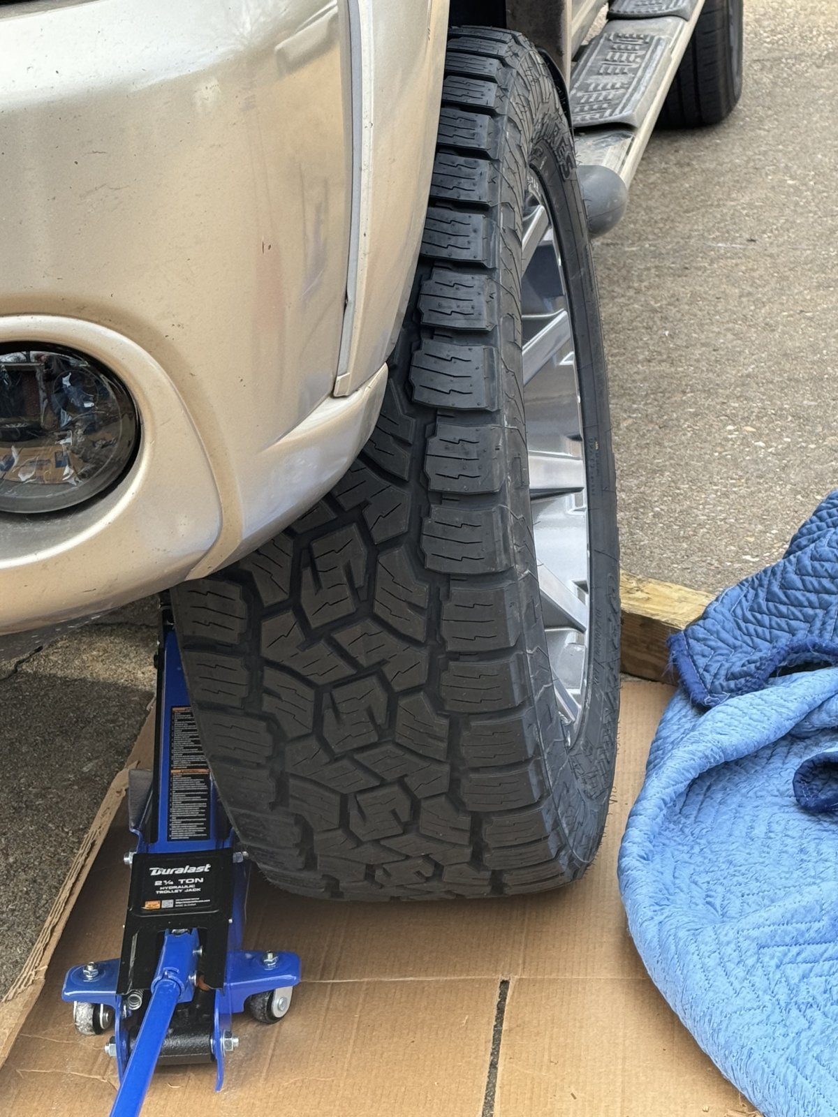

    is there a way to test for rub/scrub by lifting from under the lower control arm in order to compress the shock/coil?
    I know I can lift up under the LCA but I don't believe I can turn the wheel without hitting the Jack
    I guess the only thing I could do is turn it to full lock and then jack it up then let it down, then repeat for full lock in the other direction l, and finally repeat for straight ahead

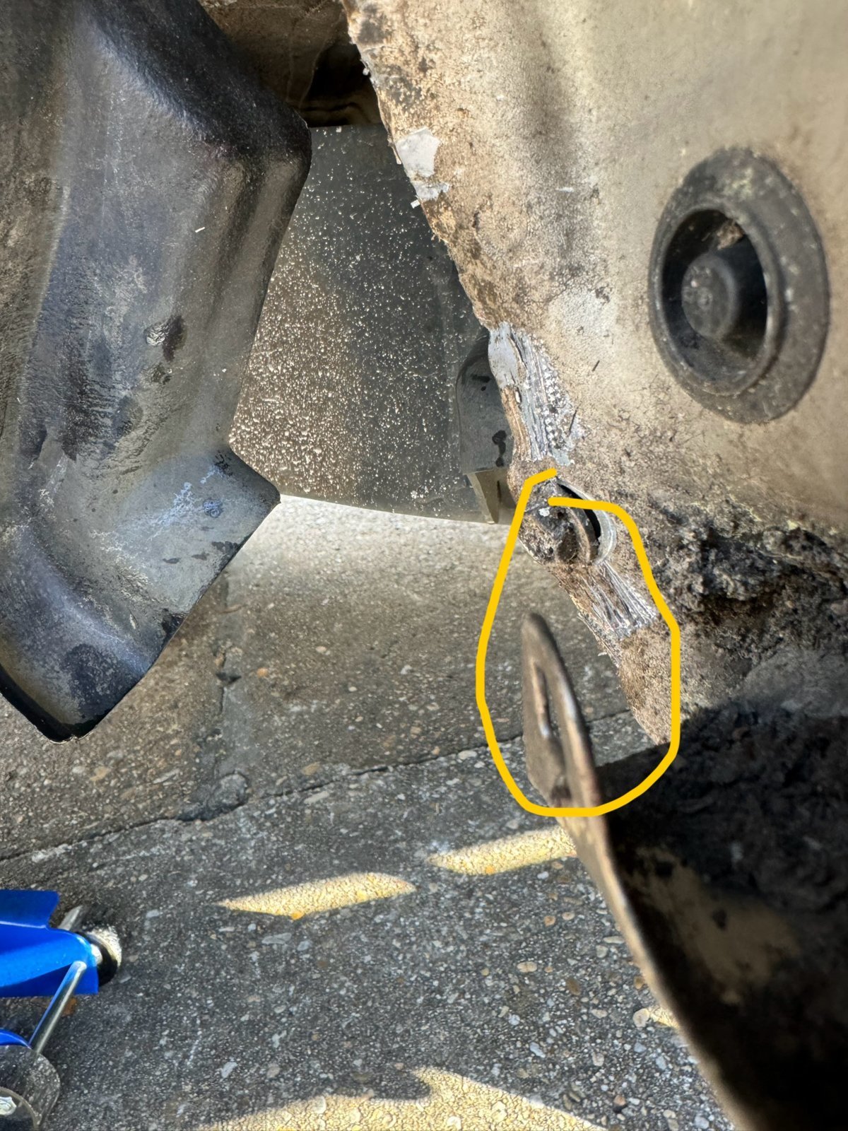

    I am testing the tire & wheel combo of 305/50 on 20x9's at -5 offset which I believe is about 4.8 backspacing
    so far everything seems to clear when the tire is not touching the ground fully jacked up, and also when the truck is not jacked and just flat on the ground. I did have to remove the mudflap.
    on the outside it appears that when compressed, I would have to modify the pinch weld and possibly trim the piece between the pinch weld and the bottom exterior of the fender well. hope that makes sense. But that is just based on the eyeball test. however, it looks very doable.
    It looks like even while compressed I believe there is plenty of clearance for no frame or bumper rub on the front on the driver side full lock right But at full lock left, it looks like it will rub the frame
    it also appears there is plenty of room after pinch weld mod for it to clear on the outer side with up to perhaps a -12, offset wheel
    it would be very helpful to be able to test this tire and wheel I have while it is compressed
    unfortunately I can't drive it or then I can't return what I have according to their return policy and in talking to their sales person.
    if this type of information is available in another thread, please feel free to point me in that direction. I haven't been able to find it so far but I will also keep searching

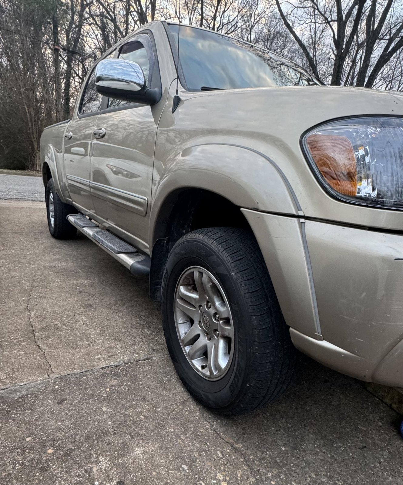

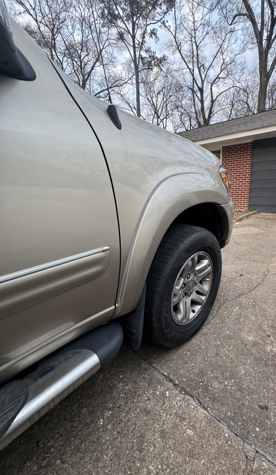

    Finally got some pics for you @KTM_AJ421
    Pictures are the stock wheels and tire's after the Bilstein 5100's with 2883 springs on lowest setting which gave me about an inch of lift. I wish I would've measured before I installed to get a more exact number. I tried to measure and I'm not sure how accurate I am, but it appears to be between 21 & 21-3/4" between center of hub and fender. EDIT: appears to be 20 3/4". Not sure how I was off that far
    265/65/17's, 7-1/2 wide, +18 offset
    KTM_AJ421[QUOTED] and shifty` like this.

    thanks man that’s awesome! How’s the ride?

    I absolutely love it. I know a lot of people say the more expensive shocks are hands-down better, but I'm extremely pleased with mine
    I went back and edited the post I made with the pictures for you. It appears I have just slightly over 20 3/4 inch between the center of the hub and the fender well instead of over 21 inches like I first thought
    I really wish I would've measured that before installing the Bilsteins to get an exact measurement on the lift I accomplished

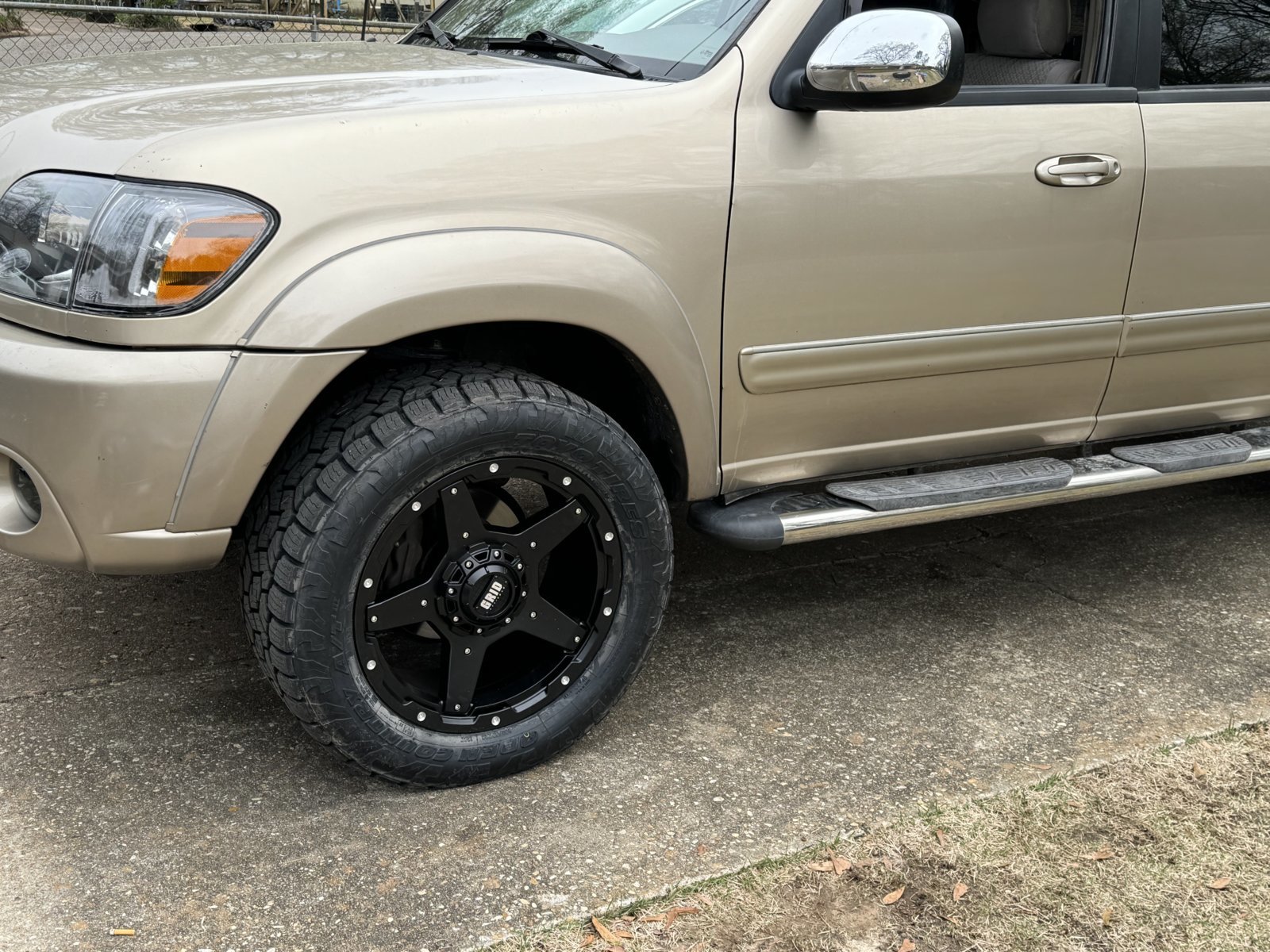

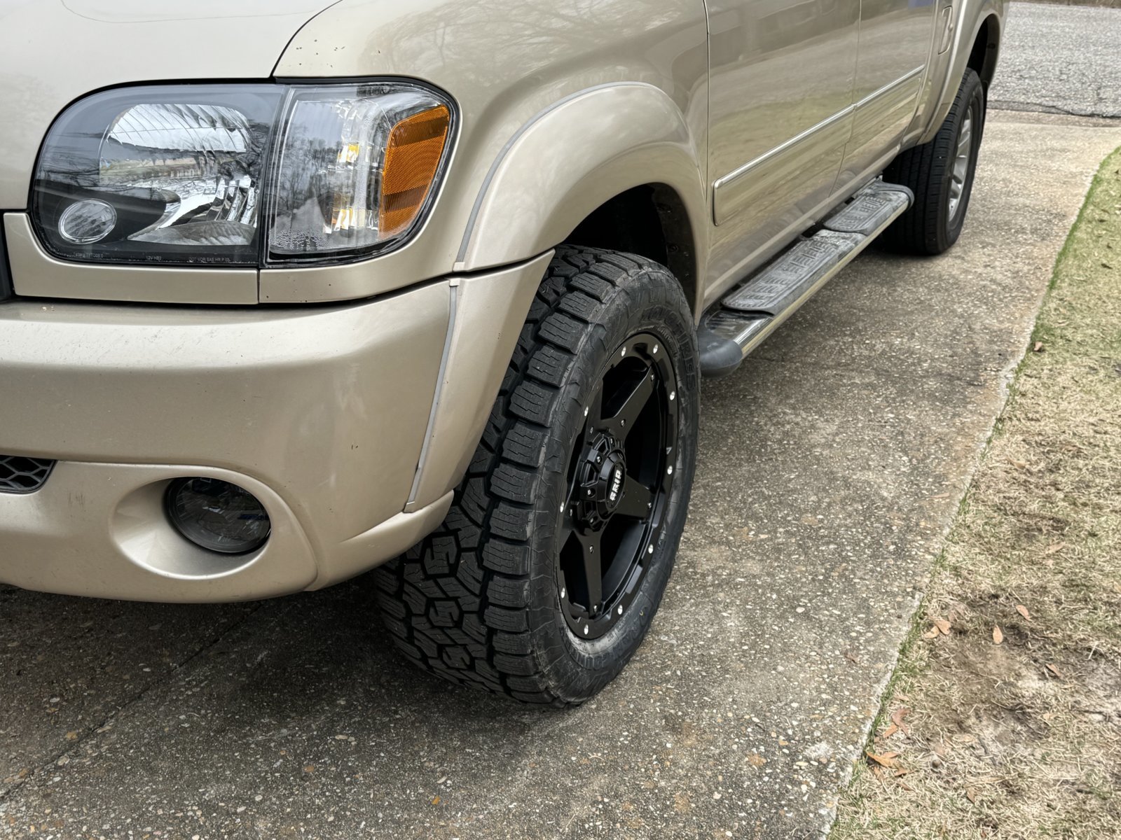

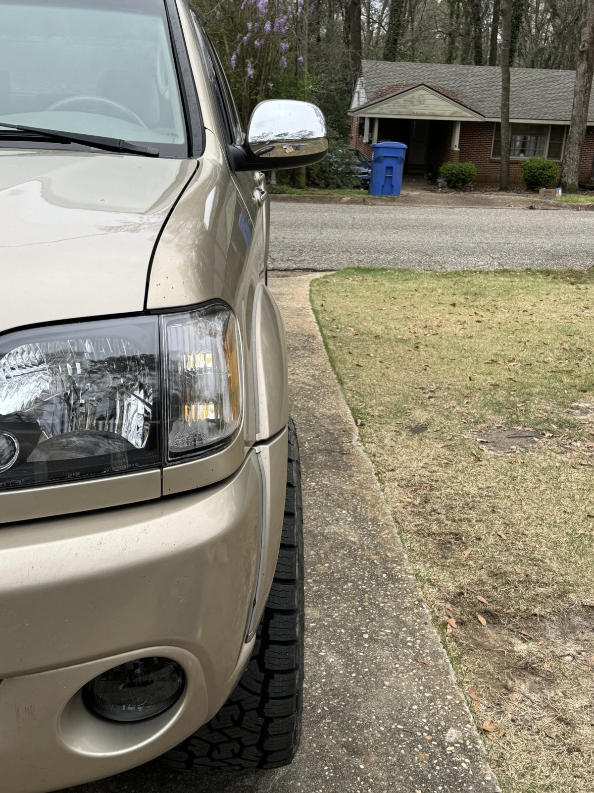

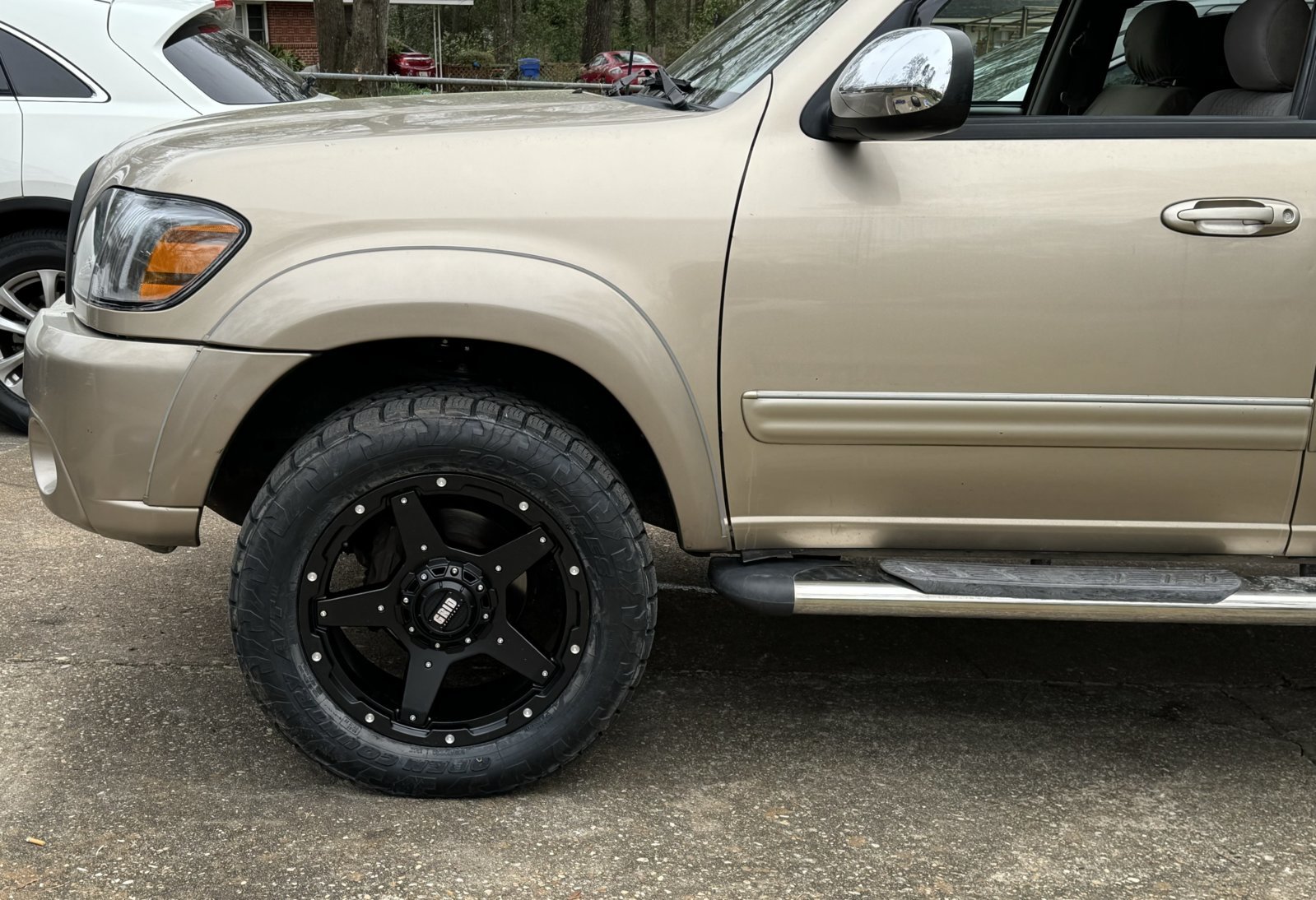

    UPDATE:
    305's, 32" tall do fit with the right offset. 20x9, -12 offset which is 4.5 backspacing and some small change (@shifty` was spot on once again there).
    I did have to take off the mudflap and I still need to trim the pinch weld, although it will turn it just slightly scrubs. no clearance issues on the inside, frame, bumper and UCA's. no other rubbing or scrubbing at full droop and as far as I could compress them thus far.
    I have the bilstein 5100's set at the lowest perch giving me about 1" lift at present. Most likely going to raise it up another inch or .9 inches to the next perch to be on the safe side. Still have more test driving once I get pinch weld done and all four tires and wheels on
    my first choice was those black Toyota Trd 18" wheels vaguely similar to these with 60 or 65 series tires. But the offset, width combo with what was available for 18 inch wheels just would not let me fit 305s on there without lifting the truck higher than I liked
    It'll look a lot better to me once I black out the chrome on the mirrors (Bulldog adhesion promotor and SEM Trim Black) and take off those chrome running boards

    I’d take the old bumper trim piece and coat/paint/skin it black and reinstall. Would look great.
    Your measures likely weren’t off, the front suspension just settled in. You’ll probably get ~ 3/4” lift at the next circlip on those 2883s. If you need a little extra out back, this is one of the rare times when I’d tell someone to throw a 0.5” block out back.

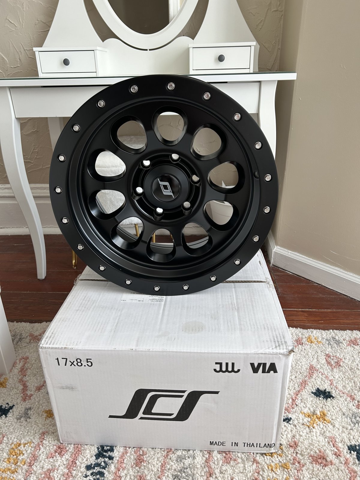

    Thinking I just want a 1” lift with the 2883’s and then running 265/70’s I don’t want it too tall so I can still load my bike
    whodatschrome likes this.
  25. Mar 10, 2024 at 1:01 PM
    #85
    Weagle
    Weagle [OP] I survived my timing belt change
    Sep 24, 2023
    #104402
    1,073
    Prattville, AL
    2006 Tundra SR5 DC 4.7 2WD LSD towing pkg
    Bilstein 5100's with 2883's - close to 2" Replacing the 2883's and going back to the bottom perch ASAP -mobile/apple play stereo with sub and backup cam -Power stop HD front calipers and rotors for towing -20" wheels with 32" tires (305/50's) Toyo AT 3's with no rubbing -Westin nerf bars -Detroit axle new (not rebuilt) steering rack with poly bushings, inner and outer TRE's -Suspension Maxx extended front sway bar links -Overland tuning - medium level -Power front leather seats and steering wheel from 06 Sequoia -fully de-chromed/blacked out trim -all light housings incl 3rd brake light and tag lights replaced with smoked lenses, LED where appropriate -mini projector headlights -fully rebuilt trans and new torque converter -new complete drive shaft with spicer u-joints and carrier bearing -all LED interior lights including backlighting -new lower window seals for all 4 doors -all new hardware and clips for tailgate Next: Dirty Deeds racing exhaust with LT headers, yellow box, 12 hole DD fuel injectors, redo or replace door panels
    You should have no problems. What is the offset of your wheels?
    265/70s on 17 inch factory wheels are well documented in this forum to work without modifications. A friend of mine added those with no suspension mods and has had no rubbing or scrubbing in the three years since he bought those tires
    so you should fit easily with a 1 inch lift. Again that depends on the offset for your new wheels, but his were factory which I believe is around +18 mm
    you'll get almost an inch of lift from the 2883s in about a 1/2" more lift with those tires you mentioned so a total of about 1-1/2"

    That’s perfect for what I’m looking for. The wheels are 17x8.5 with -10mm offset I believe so no issues with rubbing any uca or frame. I figured I could probably run those tires stock but I’m not sure how sagged out my stock springs are. I really want to put the wheels on so they may be going on sooner than later

    I went down the rabbit hole of reading up on the pinch weld mods.
    I had read it made it much easier if you made a vertical cut In the pinch weld before hammering them down. Then in another thread had a bunch of people up in arms about the problems that would cause with rust
    I ended up ordering another $80 worth of products to clean it and treat that to prevent rust, but still decided against the cutting
    but after trying a little hammering
    it seems quite stupid and was getting nowhere. I ended up bending the pinch weld over with an adjustable wrench and with some locking pliers relatively easy
    I do realize I went the opposite way with the bend the most. That may be a mistake I don't know, but it made it much easier to just bend the pinch weld using leverage of a long adjustable wrench
    these styles might make it easier for going in the opposite direction where there is something behind it
    at any rate, no more light scrubbing. I may just get away with 1 inch lift with these 305s This time I did however notice some very light rubbing at full lock left on the driver side. I'll have to dig into that later
    cosmetically it might look better with the extra 1 inch lift (2" total). I went from looking like I had tiny wheels after the lift to looking like they're too tall for that wheel well.
    i'll get all four on there and give it some time in the road and see how it plays out
    You can see the gap there now where the pinch weld was previously flush before I bent this piece upwards out of the way
