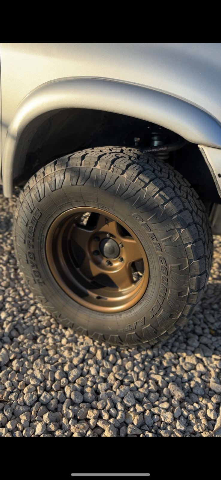

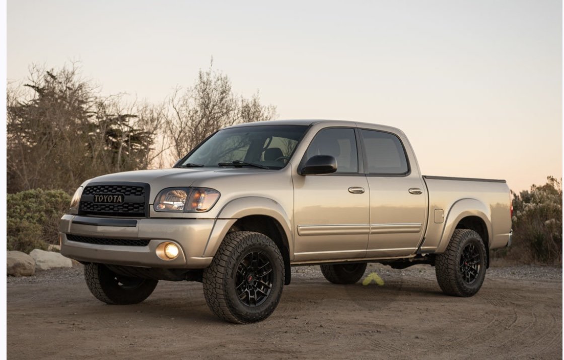

    The wheels I've run on my truck thus far with 275/70r17 (32.2" diameter):
    • 17x9 @ -12 offset (4.53 BS)
    • 17x8.5 @ 0 offset (4.75 BS)
    Those are the common wheel sizes you'll find from offroad vendors specializing in Toyota - Method, Raceline, SCS, etc. or damn close to it, since I think SCS opts for a -10 BS on some of their wheels. That's what I mean when I say "Doesn't sound like those wheels are made for a Toyota pickup..."
    EDIT: And when I say "common wheel sizes", I'm more referring to the width and offset more than anything, not the diameter. I think you'll find the vast majority of Toyota-specific aftermarket wheels for our trucks will have the following specs:

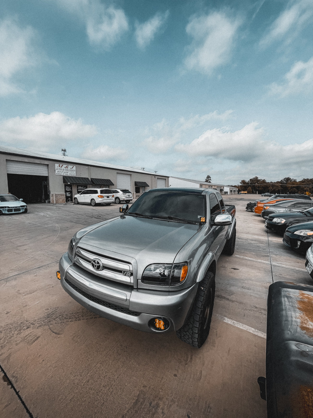

    mallcrawlers is funny to me. I think the narrower taller diameters on our trucks look like skinny jeans so touché
    yeah, I've got a friend with the same year, same double cab. He put on larger all-terrain tires very similar to mine on the same factory wheels, I have presently. He says he has zero rub or scrub and has done no mods or trimming. And he has no lift
    Edit: actual difference corrected from 0.63 to only 0.155 which is adequate
    If my calculations are correct, I would have 0.155" (corrected) less room for clearance on the UCA at the proposed +2 offset.
    my tires would be 0.4 inches taller than his which would be around 0.2 inches closer to rubbing the frame. I don't believe the inch lift would affect or help with that aspect but again a slightly more negative offset would if I'm understanding everything correctly

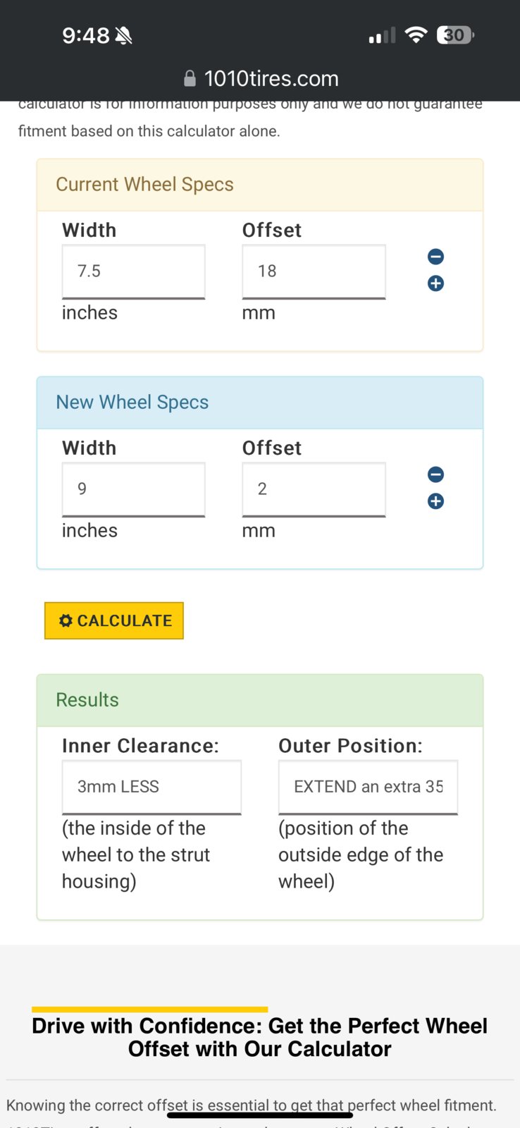

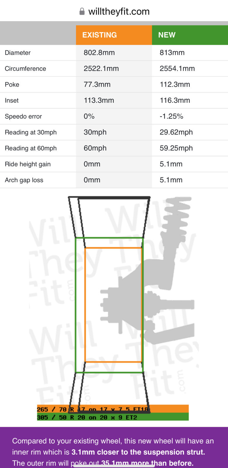

    I made some corrections in the calculations I did above and this combo as it relates to the inside part of the tire wheel is actually pretty close to what my friend has. After inspection he has ample adequate space to clear the UCA that would still allow for my 0.155" more inside protrusion and the 0.2" increase in height (31.61" v. 32.01", / 2).
    what is uncertain is the exact change the taller wheel has with that particular profile tire. I hope this makes sense, but it would push the maximum width point of the tire's convex sidewall upwards toward the UCA effectively decreasing clearance. I'm sure there's a more appropriate automotive term. However I believe with this lower profile tire that sidewall would have less bow to it, which might or might not compensate. Just hard to say, without seeing those same 2 size tires side-by-side
    There might not be any frame rub but if there is it would be on the drivers inside at full left turn lock. if so, it would appear to be slight and probably acceptable.
    at that same turn, it looks like it some point it would be rubbing the plastic on the outside portion of the tire. This might be mitigated somewhat due to my 1" lift. This I believe would be a minor alteration if I've read correctly
    all appears good on the driver side on full right turn with no clearance issues.
    The last concern would be clearance on the fender lip when shock is compressed. His is fine. My tire is about 1.5" wider / more aggressive at the lip, but I do have about 0.8-0.9" more net height allowing for slightly taller tire but with 1" lift I haven't seen any discussions on this, and not sure of any guidelines or rules of thumb here
    so, in summary inspecting this set up really helped and this is what I concluded:
    1. UCA clearance would be adequate (17 is ok with 31.61" total height and there is room for 32.01" on 20's) but impact of 20" wheels with lower profile (32.01") makes this unknown
    2. frame rub if any, would probably not be significant and would appear to only be on driver side at full lock left or passenger side at full lock right
    3. very likely to need some minor plastic mods under the wheel wheel
    4. not sure about fender lip clearance. Worst case would necessitate moving the coils up hopefully one notch / perch on the 5100s. Any comments or advice on this would be greatly appreciated.
    i.e. if the tire is protruding to or outside of the fender lip how much taller should I need for the fender lip over the tire? I'm thinking I should go ahead and raise the coils one perch on the 5100s.
    I gave BTDT example in the OP of someone in this forum that put 12" wides on the same model tundra, had only pinchweld mods and reportedly had no scrubbing/rubbing. His tires were 0.6" taller, with 0.58" more aggressive stance, but with 1-1/2" more lift. And of course his were on 17x9 v my 20x9's.
    AND obviously a little more wheel offset or a minimal hub spacer would likely cure #1 & 2 of those potential 4 issues but could potentially impact #4

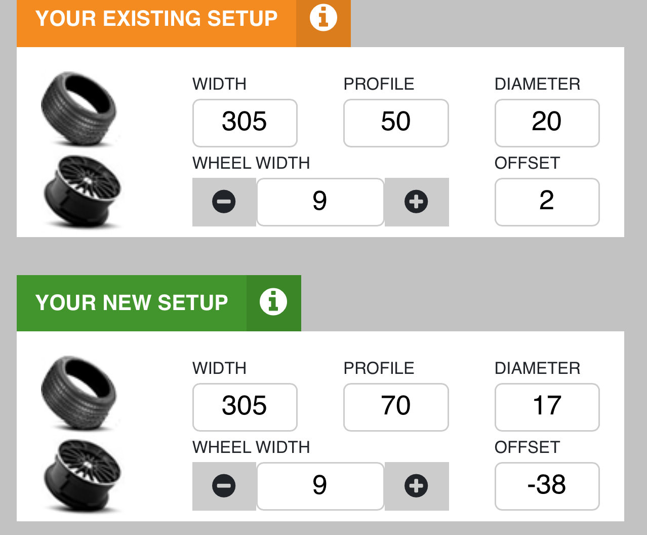

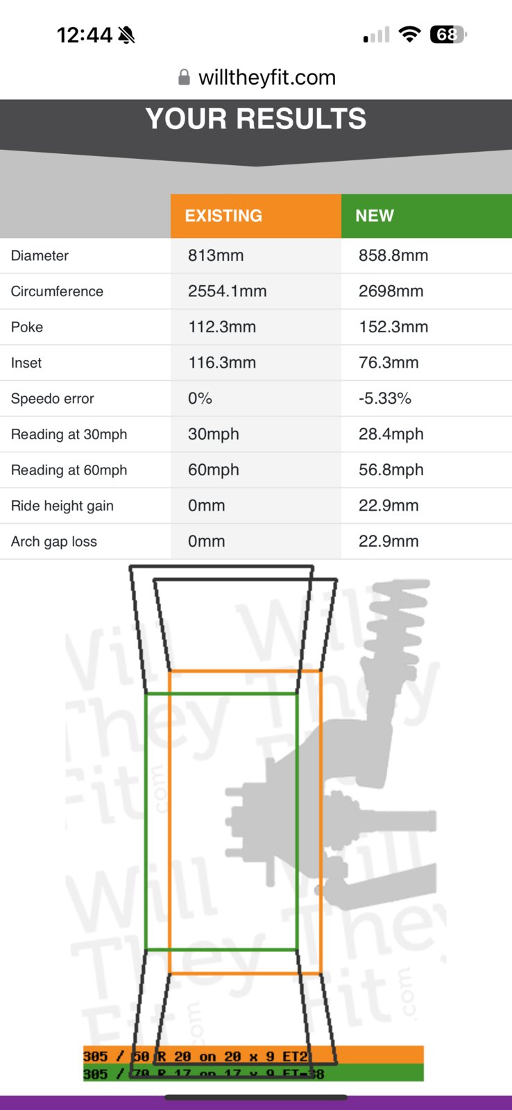

    EDIT UPDATE: I should've known going a little extreme path or pushing the limits of tire size would require me to dig in and learn about one of my least knowledgeable areas – front end suspension
    so first up it sounds like I need more lift upfront and should go ahead and replace the upper control arms. Also noticed on the aftermarket upper control arms there seems to be less material on the outside, which should aid UCA clearance
    I believe I saw where some are adjustable where you could actually move your tire/wheel a little forward, which would help with what appears to be the biggest rub issue - behind the tires on frame and lower fender lip. This will probably awkward, because I'm still learning some of the common terms
    found a 06 DC owner that claims he has all factory susp and he has run 295/45/20 (30.34") and 285/50/20 (31.32) with no rub and 275/55/20 (31.91) with minimal rub only backing out at full lock all factory suspension.

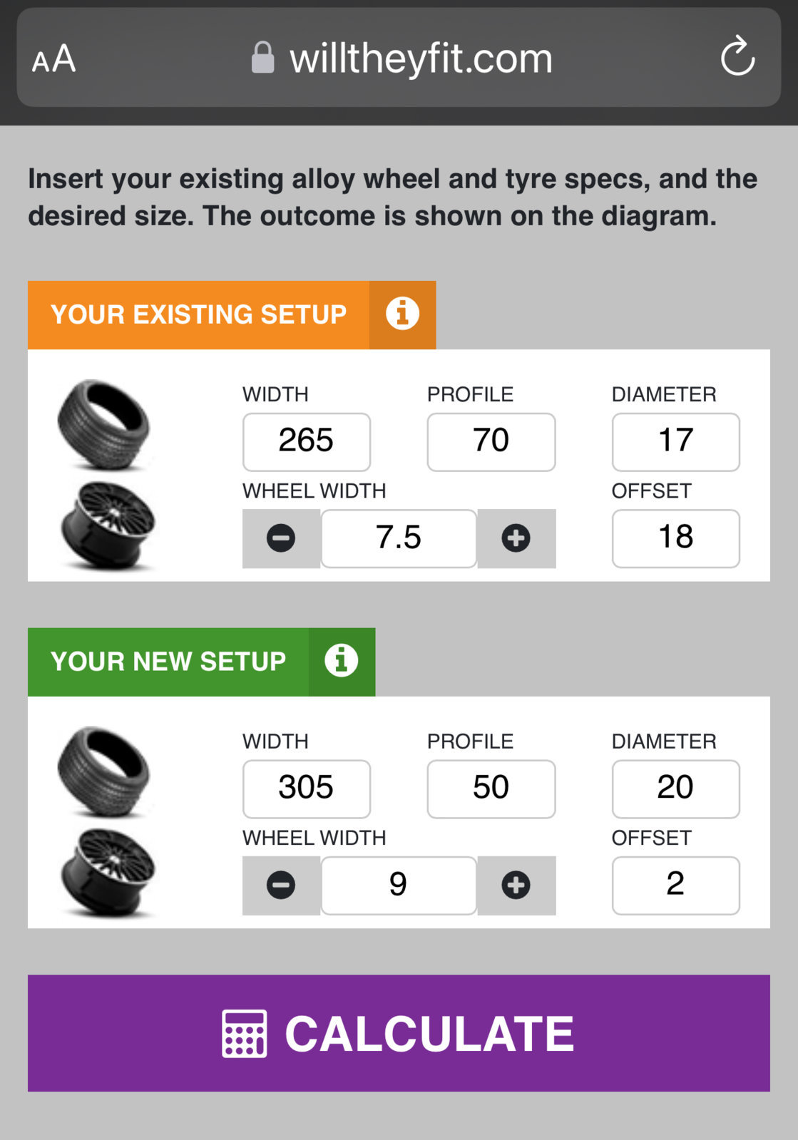

    my goal is to run 305/50/20s with the least amount of negative offset and the least amount of lift. The fact that my 305s are only going to be 32.01 inch tall should make any trimming or mods easier than those with taller 305s
    Already replaced LBJ's, so UBJ's, any bushings, UCA's, etc
    i've already found quite a few people that successfully ran 305s on my model truck with minor trim mods. Their tire wheel combo also came in taller than mine such as 32.61" and 32.81" where is mine should come in at 32.01"
    also found a few that were running 20 inch wheels without problems. But not yet with 305s. so far is best. I can tell the only problem presented with 20 inch wheels would be the effect on UCA clearance. so I'm going with that unless I find different. I know aftermarket UCA's give you a little more room for clearance

    Therefore most people that have tried 305s are approaching or going over 33 inches tall. It's the width AND that height that caused the problems.
    As you said, easier to go tall and wide on these trucks but if have just enough offset to clear the UCA and frame at full lock then that will minimize the need or the extent of modifications on the outside portion that might scrub the tire and wheel
    Since mine are only 32.1" tall, so far it's looking like I would need somewhere between +2 and -6mm offset (or equivalent with spacers) for my specific tire and wheel combo.
    I am approaching it from the inside out where it affects suspension and the frame. Then see where I'm at on the outside and the wheel well
    continuing to work through it ...

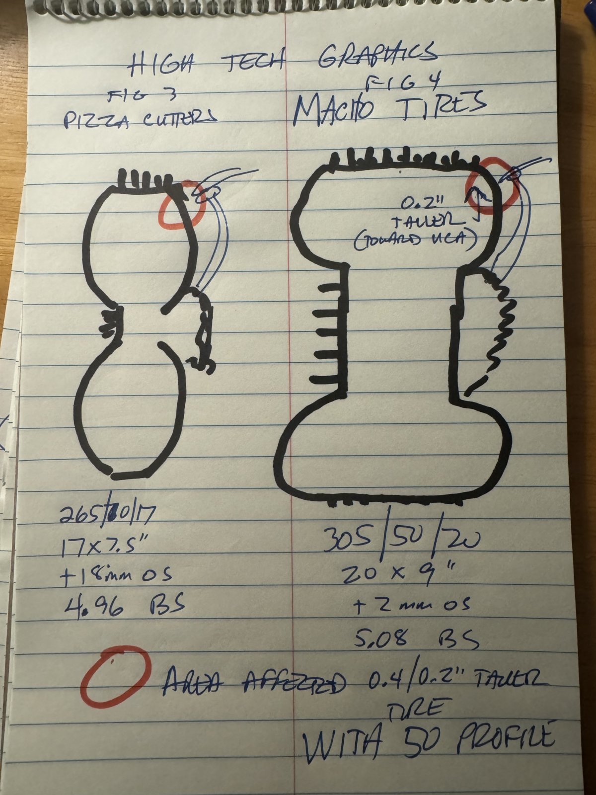

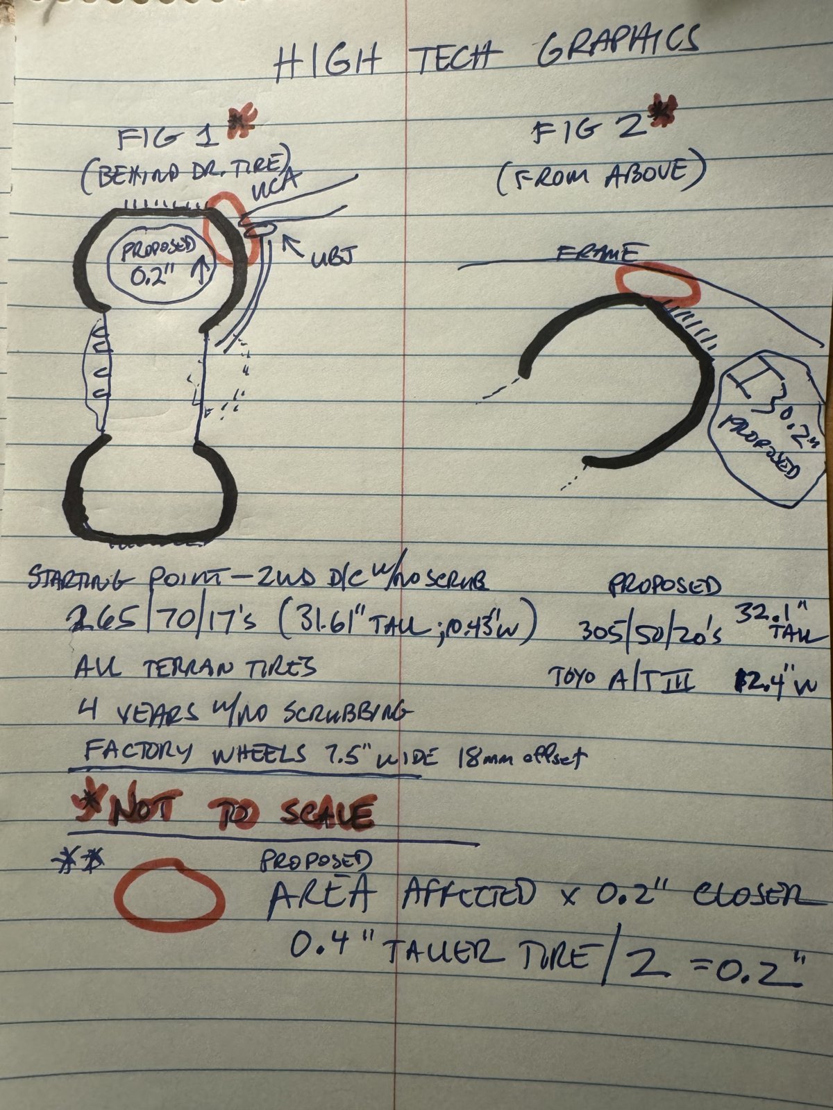

    Starting from what I know works on the inside and working my through points of concern addressing suspension and structural clearance issues first and only then worrying about rubbing and scrubbing of body parts
    On a friends 2006 Tundra SR5 DC RWD just like mine:
    Originally identical Tundra, tires, and wheels:
    Wheels: 17x7.5 18mm offset 5 BS (4.96")
    Tires: 265/65 17 street
    Replaced tires only - NO suspension mods:
    Tires: 265/70 17's all terrain
    Good UCA clearance, and no rubbing or scrubbing issues in four years
    this taller tire (265:70's) only pushed the inside tire wall up closer toward of the UCA (see High Tech Graphics, fig 1) and closer to frame (fig 2). The tire was only taller not wider but still caused it to come closer to the UCA
    This still left ample room for clearance as evidenced by no issues for four years
    Proposed tire and wheel combo is 0.4" taller. Divided by 2 means the new tire's convex sidewall will be pushed up 0.2" closer to UCA/UBJ. (Fig 4) than the 70 series 265 pizza cutters (fig 3).
    And my truck has a leveling kit at 1" that may need to be adjusted up to 2-1/2"
    the unknown with the the proposed set up is the impact of the low profile tires, causing the sidewall to come even closer to the UCA. I will address this with minimal spacers, or aftermarket UCA which does not protrude as much toward the wheel since the lower profile tire only affects UCA clearance
    0.2" taller tire will also put tire closer to frame at full lock (fig 2) but because it is at an angle, it will less than 0.2" closer
    there is enough clearance where the new set could come slightly closer without causing issues. But the goal is to keep it with what works
    I'm definitely gonna go ahead and do the cab mount chop mod. I can't imagine it working without getting that done and that's pretty simple

    I +1'd this because high tech giraffics.
    Weagle[OP] likes this.

    Thanks that helped confirm a lot. I've done a lot of calculations and that was pretty close but this would've been so much simpler ha ha
    That confirms what I thought. That gets it in about as tight as you can to minimize the chance of rubbing or scrubbing on the outside.
    very little difference on the inside or in height from my friends that I know works with no rubbing and without a lift. I have a bilstein leveling kit, but have it set on the lowest notch so it's only about an inch of lift
    I've done a lot of searching, and have since found quite a few with this wheel/tire set up, and they actually went with taller tires (higher profile) with no or minimal issues. But they went with the full 2 1/2 inch level
    so I feel pretty good about it. The only question is about the UCA clearance with the tire as opposed to the wheel in the calculator. I'm gonna have to see that to believe it, but it seems like people have done it successfully with more exaggerated set ups than mine

    Thanks. I went back and looked at my friends, since mine is in the shop, and his setup is closer to mine sans wider tires
    I can see now where the cab mount is really not likely to be an issue. My issue will be the plastic on the backside closest to the cab. Right in the middle
    my leveling kit may prevent or minimize that problem, but it was it looks like at worst I have to use heat and mold the plastic a bit
    much more optimistic now that I've seen quite a few setups similar to what I'm doing but with even taller tires
    like you said, don't go extremely negative on the offset and minimize many of the potential rubbing and clearance issues. I'm not looking for a super aggressive set up. I don't want it sticking out of the fenderwells if it all possible

    The pinch weld is right behind that plastic. With a 305 I had to cut, flatten, and push the pinch weld back with a sledge hammer. Not to mention cut the plastic out entirely. You’ll probably need to cut the inside of the fender flares and the fender liner on the bumper. And the bumper. (My bumper was already toast so I just cut a ton out since I won’t be keeping it). I took the opposite approach from you. I wanted a 305 since 35’s are completely out of question and 315’s were probably too big as well. Just started cutting. I don’t rub at all on the street, but the lift height is crucial along with cutting.
    In regards to pushing larger size & offset. Tire size determines how much you cut and offset determines where you cut. Still recommending 295’s if you knew how many times I had to revisit cutting and trimming (going as minimal as possible each time).
    You need the aggressive offset to fill the wheel well and can compromise the tire size so it doesn’t poke and rub. You can see my wheel is out to the flare, but the tire takes it outside the flares. 17x9 -38 wrapped in 305/70/17’s.
    Only pic I had but for some visual representation.

    thanks and I love those smoked headlights. I'm about to put those on myself
    that helps a lot to know what I'm up against when it comes to bending and trimming. I really didn't even know where the pinch weld was, and was trying to find that out now.
    Having said that there is a significant difference between ours - yours is 33.81" tall. Mine are only 32.01". And that aggressive offset means more trimming issues
    that extra height very much exaggerates this aggressive width. And the aggressive offset compounds that width and height. Not saying I wont have the same problems, just saying an inch (0.9") shorter on each side/on the corners of the tires AND a much less aggressive wheel offset in the fender-well should mean much less trimming and banging. Mine has 40mm / 1.57" less poke.
    Your increased offset and taller tire really push it up into the pinch weld more on a turn. Between the tire height and the poke, that's almost 2 inches, or possibly over 2", further into the pinch weld. EDIT: I knew that didn't sound right I had to break out the geometry that's been many years. Your tire on a turn would be 1.29 inches or 32.824mm closer/into the pinchweld.
    3RD EDIT: geez The corner of your tire would be 1.89 inches further into the pinchweld. Think all the steroids were getting to me over the weekend
    I was right the first time
    of course that is assuming the same lift
    How much lift do you have on yours?
    Mine vs. yours:

    they’re pretty decent headlights. Definitely recommend ceramic coating on the lenses if you install.
    If you were close I wouldn’t mind letting you test fit and checking out what I did cause it’ll give a really good benchmark on what you’re up against. I still think the 305 is going to rub like hell just cause the tread width is there.
    estimated 2.5” ish of lift. Truck came with coilovers installed at what seemed like factory height. I cranked them up another inch and I have some shims waiting to go in for another inch (I’m just lazy). Icon AAL with 1.5” rear lift.
    I didn’t realize how bad it was going to be until I mounted the wheels. I couldn’t even make a full turn on the steering wheel before it was trying to rip my front bumper off.
    I still rub all 4 corners under full compression and I can say that 1.5” less offset will not alleviate that issue.
    This is my 4th Toyota truck and out of all of them the absolute worst at fitting bigger tires. I did some research and also the kid who I got this truck from had 35’s on it and I realized it’s impossible to fit them. Then did the most illogical thing possible. Stepped the tire size down a couple sizes and ordered it. Didn’t think didn’t research anything. I wanted aggressive offset and big tires.
    The best advice I can give you is buy the setup you want. Then make it fit. If you’re still on the fence get on marketplace and find a used tire to mount and test fit.
    The devil on my shoulder says Don’t even think about it. Your final outcome only depends on how steady your hands are lol. You can lift it up to 3” and you can cut and smash the firewall as much as you can stomach. Seam seal, paint, and send it :sawzall:

    Mine is desert sand mica color like this one. I'm going to give it the full blackout treatment and debadging like this guy but different wheels. Already have the grill ordered and all lights. Replacing all exterior lights, including the cab and fog lights and tag lights, all LED, all smoked, and also putting mini projector head lights. I believe all that came to around $700 believe it or not
    Edit: lights totaled $645 and grill was $255 so it was $900. Still not bad in my opinion
