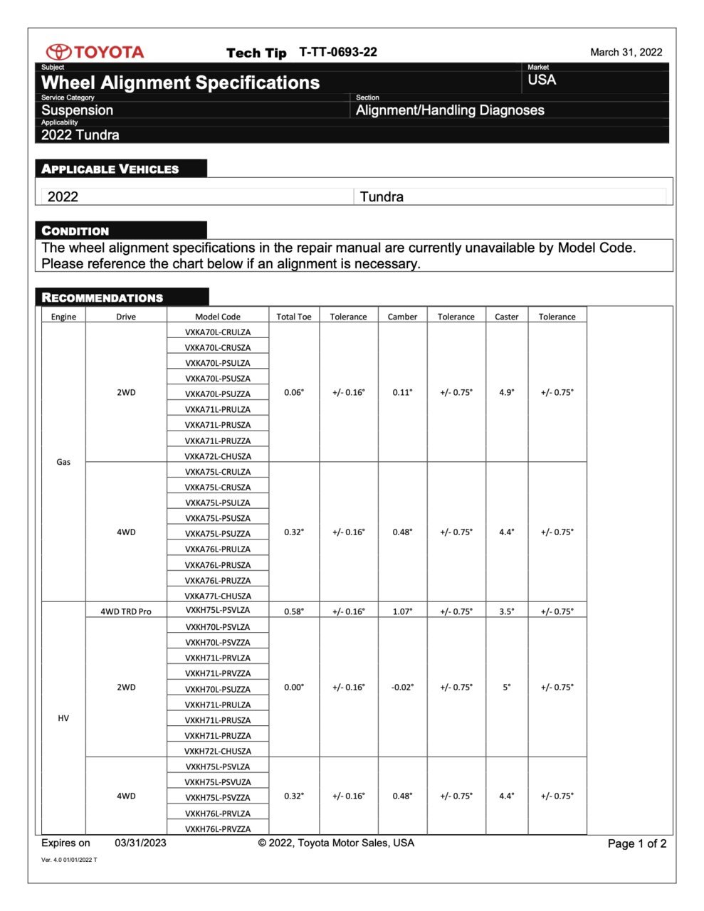

    Looks like the TRD pro has different alignment according to the spec sheet. It runs just over 1 degree of positive camber with a tolerance of +\-0.75 degree.
    Other 4WD models runs only half a degree with same amount of tolerance. So can get 0 degree with other 4WD model and still within spec.
    TRD pro it would show out of spec if you were to adjust to 0 degree of camber. The alignment spec sheet:
    kilocharlie106 and porterbc like this.

    Perfect timing! I’m going back in to have mine redone this morning. I had installed the aftermarket springs from @GeneralSpring which gives me a 35% payload increase. So buddy had done the same to my truck leaving too much camber. It tracks fine but the minute you start to corner it really takes off. Plus a visible positive camber just looking at it. I prefer a little extra caster as it makes it track much better especially once you add 8-10,000 lbs with a trailer, that will take all your caster away once you squat the back end.
    thanks for the spec sheet @TakiEvo

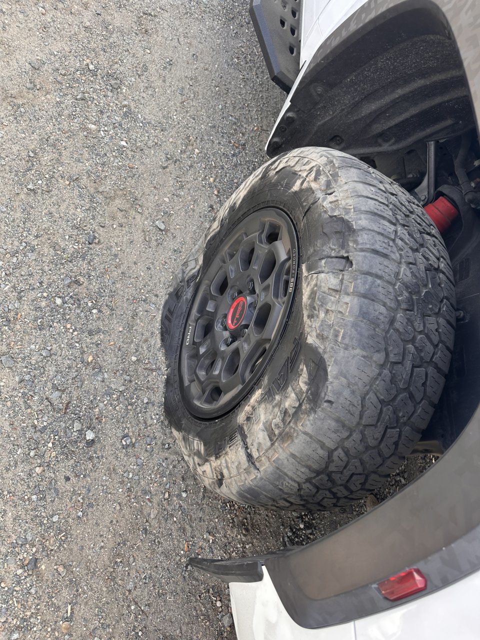

    I have the same issue with my falken tires on a 22 Trd pro. Falken tells me it’s Toyota‘s fault Toyota is telling me it’s Falkens fault. Any chance you can give me the dealership name that is aware of the alignment spec change? Falken said Toyota admitted to having an alignment spec problem and that they were rectifying in May of this year. Had a significant blowout on the freeway this weekend at 20k miles.

    Dang. That’s straight sidewall failure. TPMS would surely tell you if you were u fee inflated which is the only thing that would normally increase the risk of this. Those factory Falkens look like weak sauce.

    Check for nail hole anywhere on that tire. Looks to me like it has been run low on air and is a run flat.

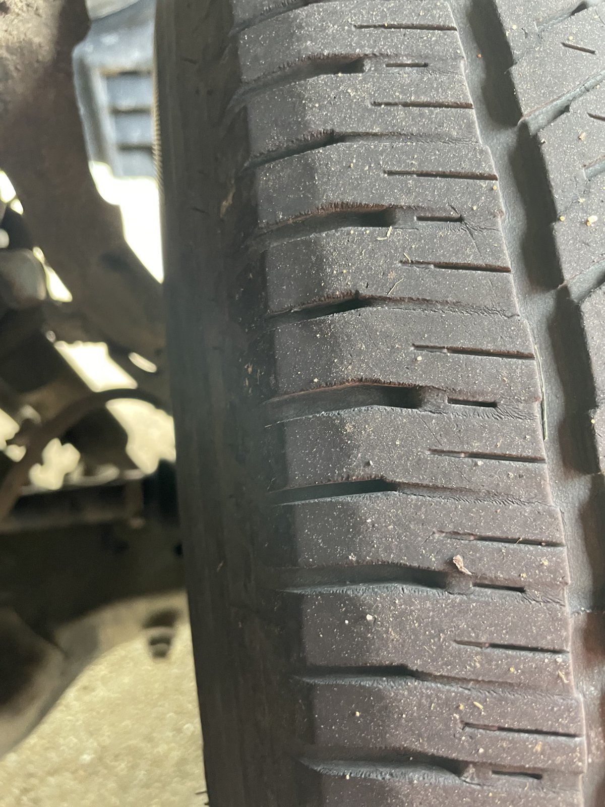

    My tires are wearing. I drive in northern VA/wash DC and do turn lazy/sharp sometimes, not all the time I go slow in the neighborhood and on base. This truck had the steering rack replaced when I bought new in Dec 2021, 5k miles later rack was loose and a dealer fixed the rack and did an alignment. I don’t tow with the truck. Rotated every 5k miles. At 27k miles, would like to get 40-50k out of these tires, thoughts?

    Needs more negative camber.
