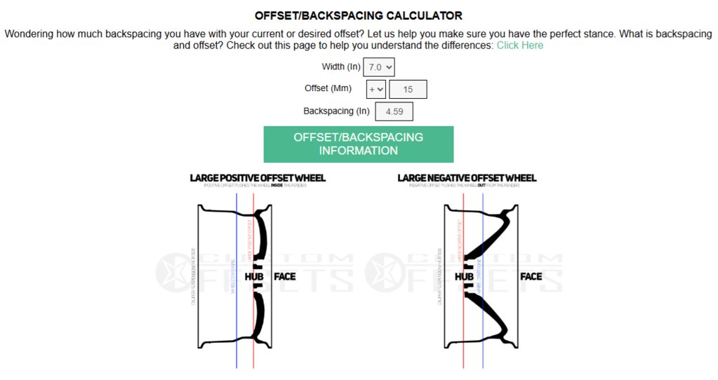

    Thanks for that info. I probably have enough chaos in my life so I should probably mention - I have stock 16” wheels so I think the specs are:
    • 16" wheels - Width: 7", Offset:+15mm, Backspacing: 4.5", Hub BoreDiameter = 106mm
    No plans to upgrade if at all possible. Trying to keep it mostly stock with the exception of a little larger tire.

    I can probably verify backspacing if you can post a shot of the stock wheel. There are a couple of 16" variations on the 1st gen.

    Here are the 16” wheels I have.

    I think that's 42611-AF110, this wheel, I think that's also what @455h0le_dachshund is running. If so, 4.6" backspace is pretty favorable, great in-the-middle number as far as poke vs. tuck goes, and you know those 16" won't rub with your later-year 13WL calipers as long as you're running outer lip wheel weights.
    With no lift, I probably wouldn't try going any farther than a full inch from stock with 265/75r16. You'll get a lot of grace because you have the skinny flaps, not the bulky plastic ones I and some others have. That gives another ½" clearance, and you can probably align out any major rub.

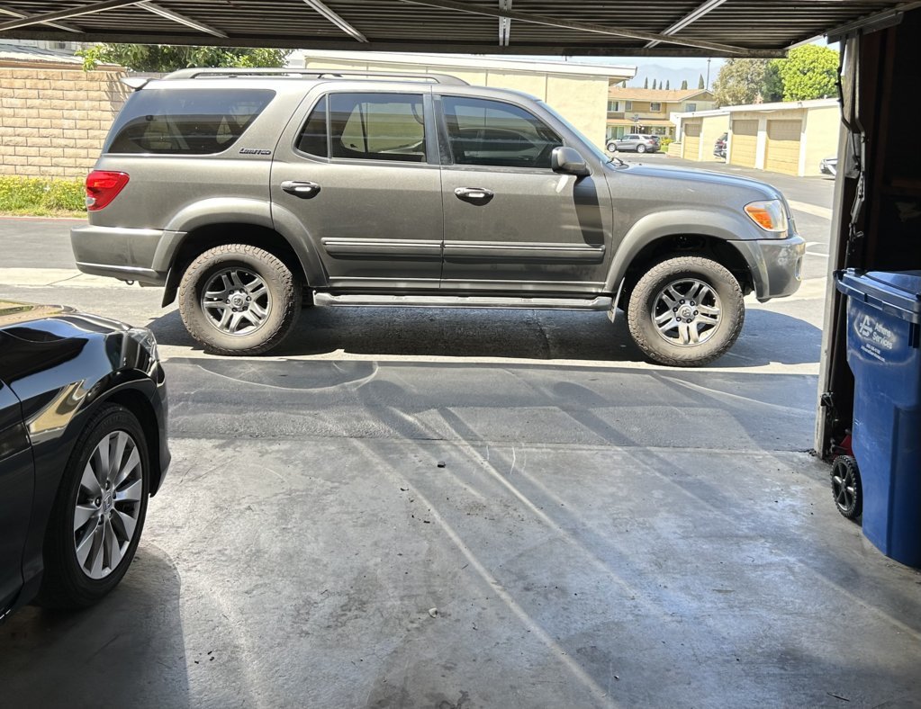

    If you wanted to level and keep a solid ride, Bilstein 4600, OME 2883 spring, with these isolators to use with those springs, you'll get roundabout this stance **IF** you're 2WD. If you're 4WD, you may get ½" less up front, and OME 2884 will get you closer to that stance. That's only if you wanted to roll a little lift in. But again, lift doesn't clear tires as much as proper alignment and good wheel fitment will.

    4WD DC with the OME 2884 in either the 4600 or 5100 is going to settle out having you nearly level. Nearly identical to that 2WD Sequoia with 4600 + 2883 combo.
