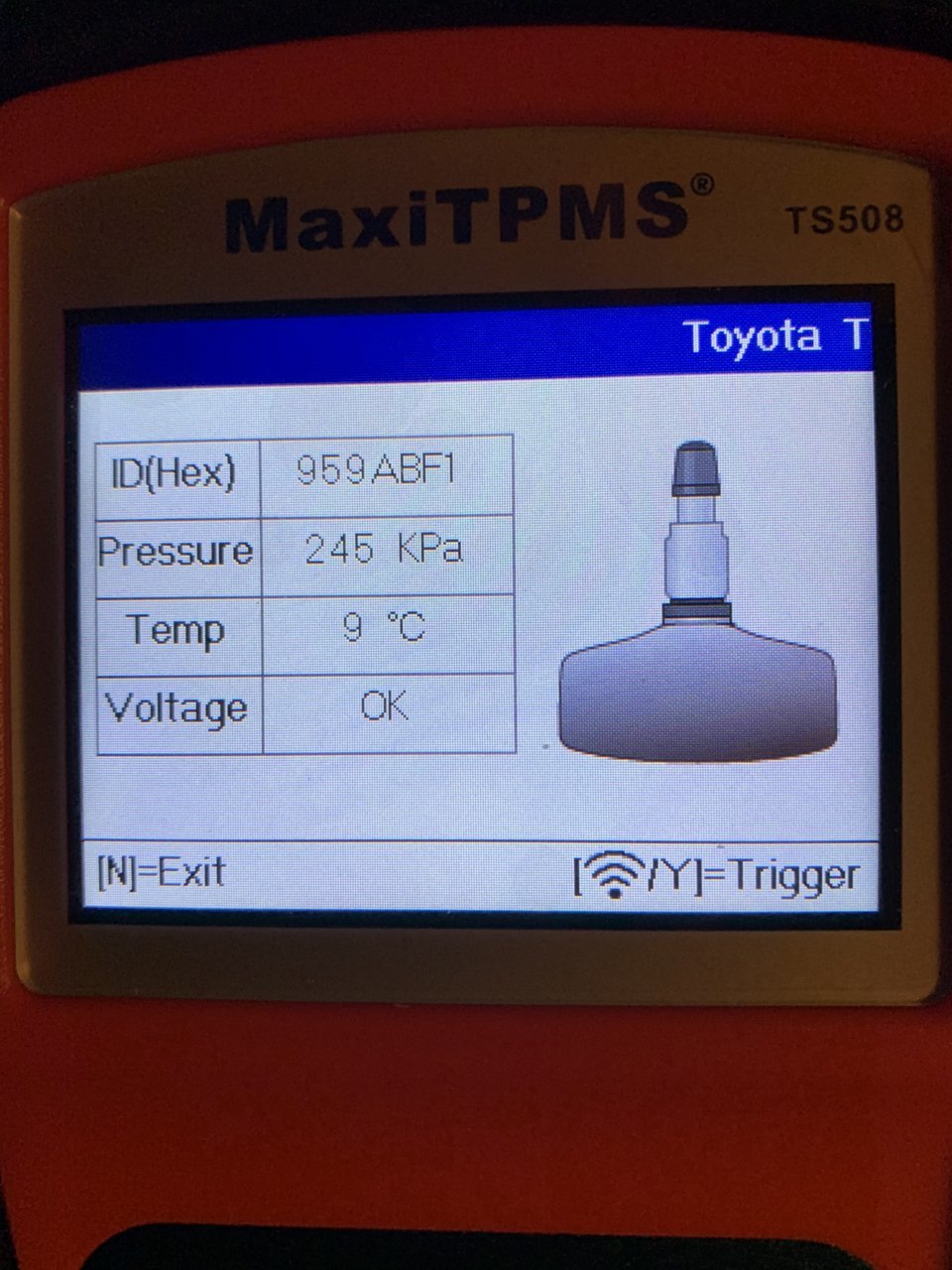

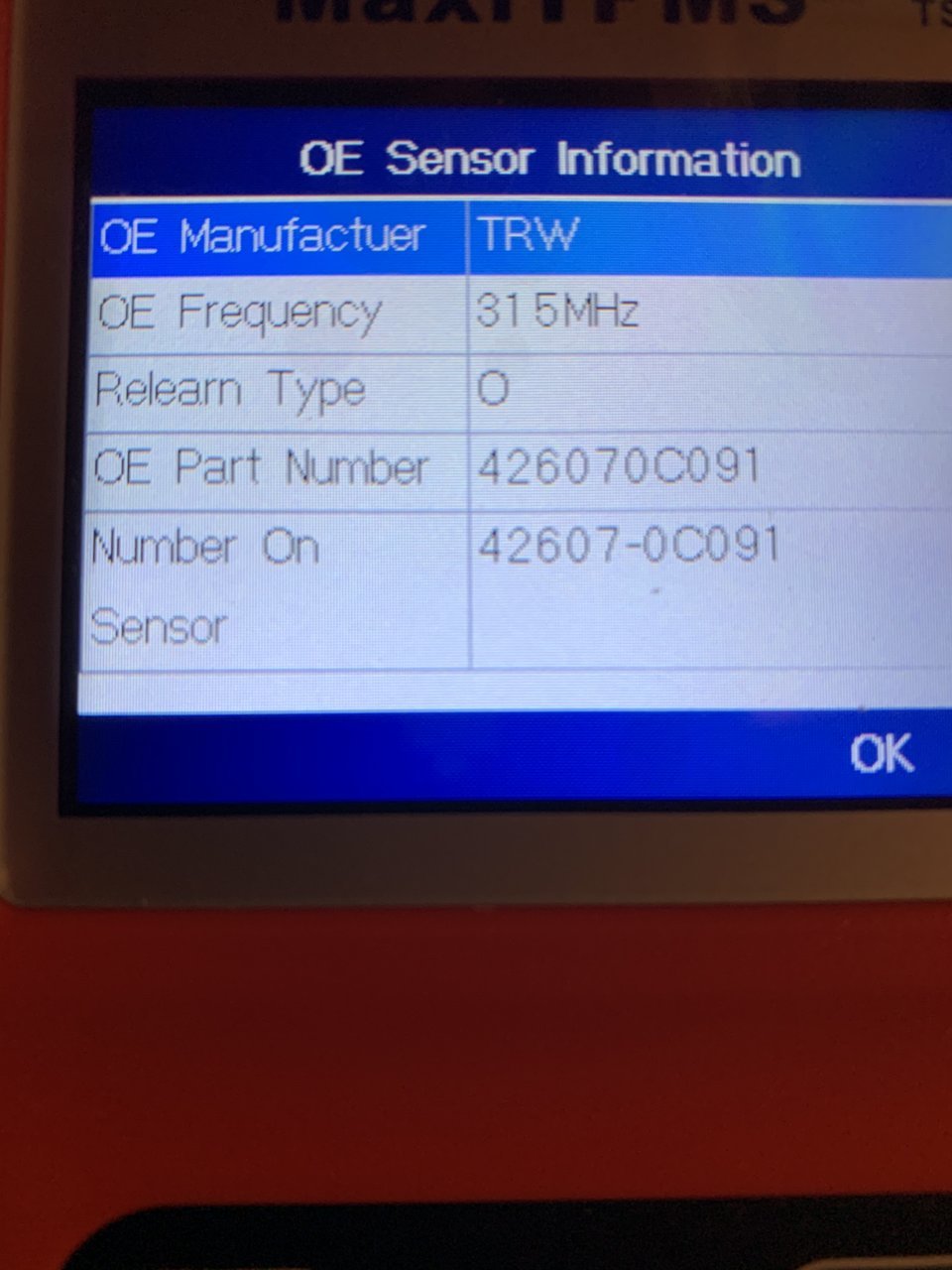

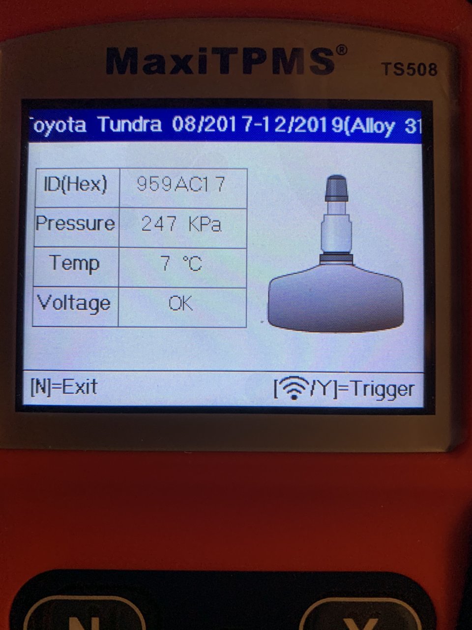

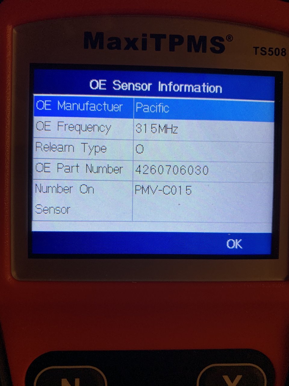

    I went out and bought a Autel TS508 to find out why I had such issues. Found out my new to me 18" Off Roads have good sensors but needed to use 2017-2018 alloy wheel in order to read them. The other thing that I found was the coding is different. They both broadcast at 315Mhz but the older style uses a 8 digit hex and the 2020 uses a 7 digit hex . My left front on the older 18" is ADD47AD6 and my 2020 is 9599DE0. Now I know why it will not work and why I have to buy new sensors if I want to make it read and learn when I swap tires.
    rebmo likes this.

    Here are some pics from the Autel TS508. This is the 2020 Sport tire.

    This is the info off of my Off Road wheels. I have to see what is up because the info I am receiving is not the same as last night. both seem to have a 7 digit hex code.
    UPDATE: Found out I was picking up info from my original tires. I had to move my truck and also needed to select 2012-2017 Alloy wheels. There are in fact 8 digit hex codes.
